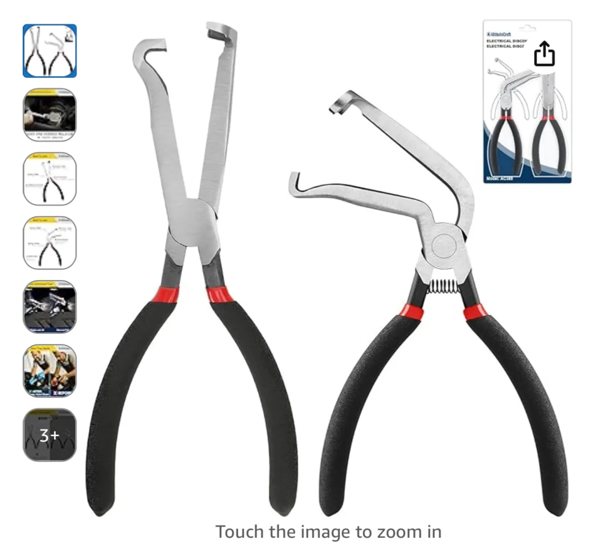

OK - so an hour and a half of messing with this passenger side plug and I'm throwing in the towel! This is a PLUG? By definition it should be able to unplug - AND THEN PLUG BACK IN. It unplugged alright. But nothing I've tried has been able to get it to plug back in.
First tired dielectric grease. No luck. Then tried a whole bunch of dielectric grease. No luck. Then I cleaned both sides of the plug with mass air sensor cleaner - washing out all the grease and hopefully any road grime that might have been in there. Yeah....nope.
Before I go to the dealer and pay a couple hundred bucks to somebody to plug a plug in for me, does anybody have any suggestions?
I'm thinking of ordering those connection pliers off Amazon. Anybody had success with these?

those look like lady part pliers.

Those are for pulling the ignition wires off plugs for those who still have distributors. The carbon core wires were pretty fragile. You used them to pull on the spark plug boot so you didn't have to pull on the wire.
look similar - but these close when squeezed not open.
not sure if they are gonna work or not but cheaper (and less embarrassing) than taking it to the dealer over a fricken plug that won’t plug in.
They should close when squeezed. That's how they grip. You use them to grip the boot, then you pull.

I can see that maybe working. But I was looking at them more as used in the this video. I just don't know if they would also work for RECONNECTING as well as disconnecting
