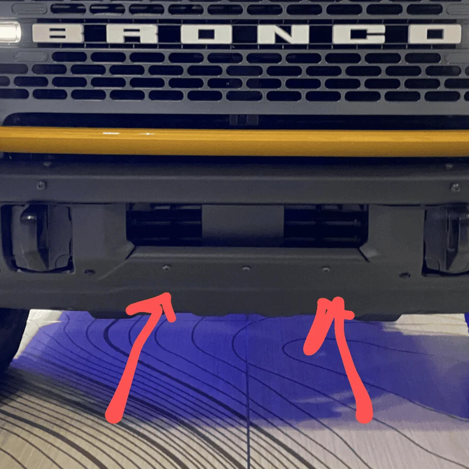

Getting an error message that my recently installed front license plate is blocking the break assist sensor - anyone else having this issue? The actual plate is no bigger than the temporary plate. Included 3 pics, last one with the trees in the background was with the original dealer plate, no issue.
Yeaaaaaah. If your plate is mounted there you're going to have a bad time 🤣.
That black box in front of the Intercooler is the ACC (adaptive cruise control) radar.
I'd simple change it to utilize the "Bronco Bolts" for the top of your plate vs the bottom as it appears to be now.
Problem solved?

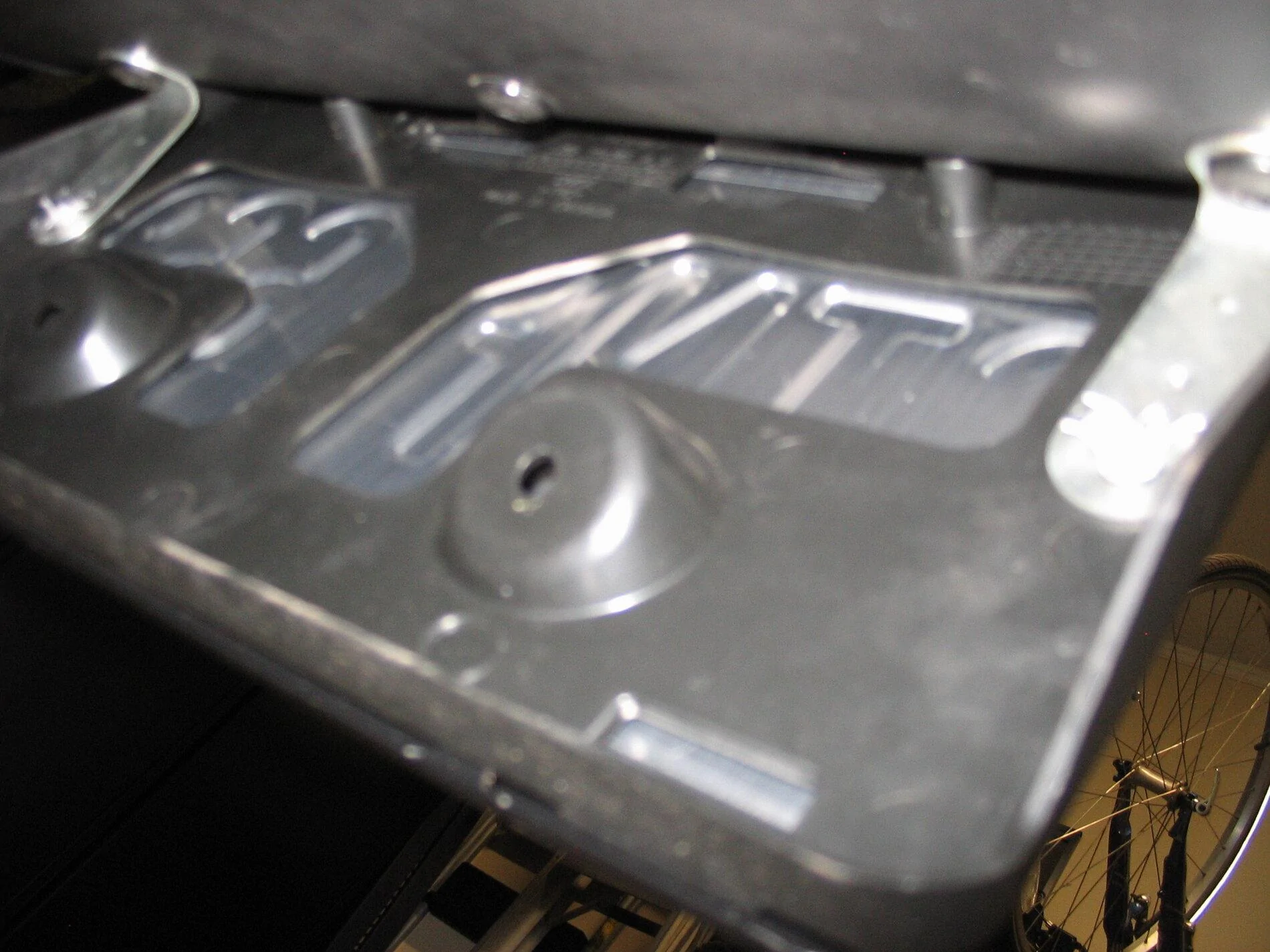

Do you know where I can buy the license plate frame for the top two pictures? This is what I want.
First 2 pics was a custom made out of sheet metal.
Second one is the oem bracket just modded to fit using the mod bumper bolt locations.
Here is picture from behind on that one:
Ford Bronco Front License plate blocking brake assist sensor IMG_5856
