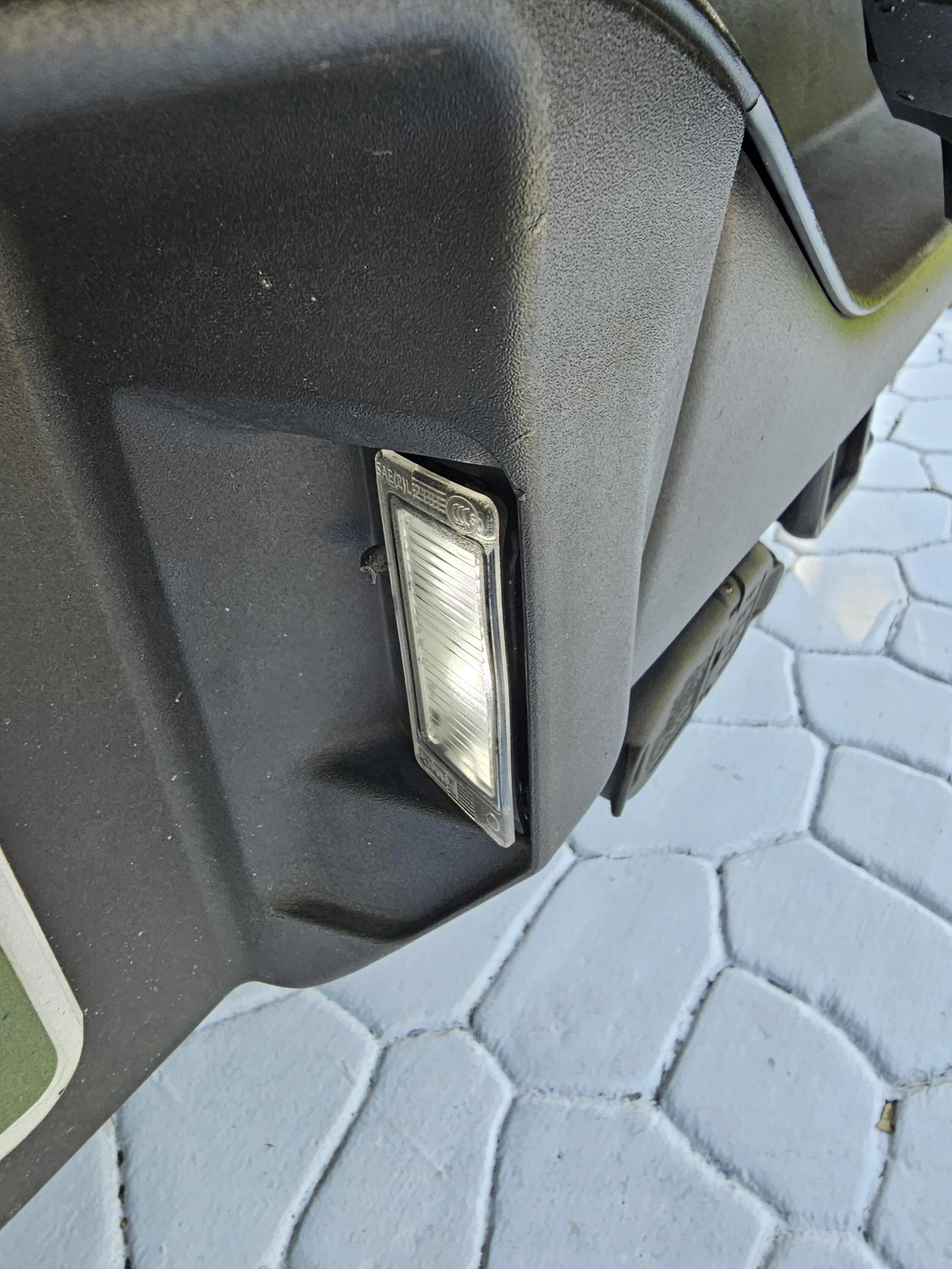

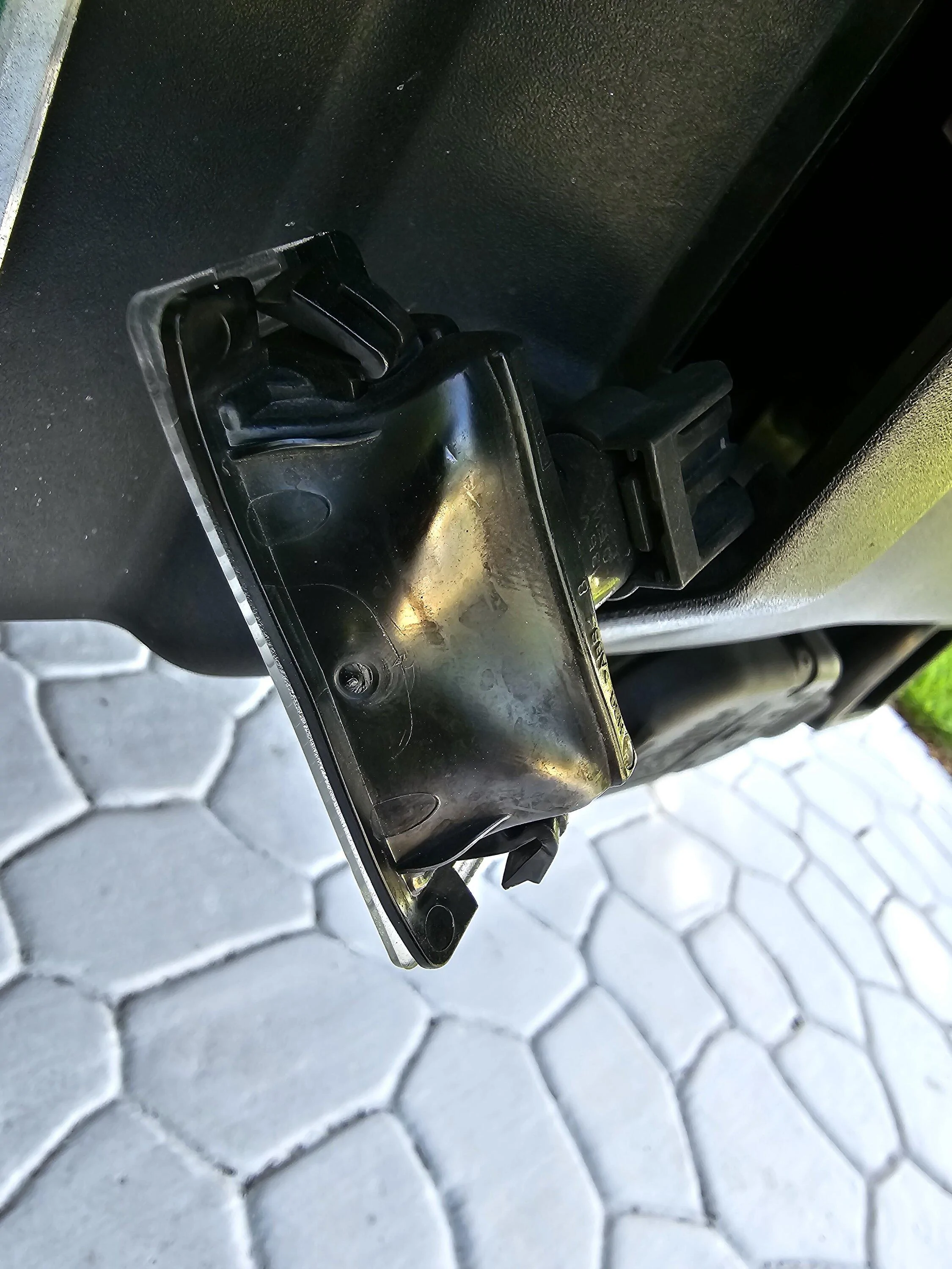

Well this is a first...
I've been running without a muffler for a few days while fabricating a new muffler delete pipe. I noticed last night that the light on my tag seemed a bit uneven - come to find out that it was basically hanging by the harness. Seems that the heat from the exhaust connection point shooting straight out towards the bumper is hot enough to melt the license plate light assembly to the point that the mounting tabs shrunk inwards with the rest if the unit and could not longer hold onto to the mounting points.
Pretty wild...good reason to make sure the new delete pipe is angled down fair enough below the tag to prevent this from happening.
