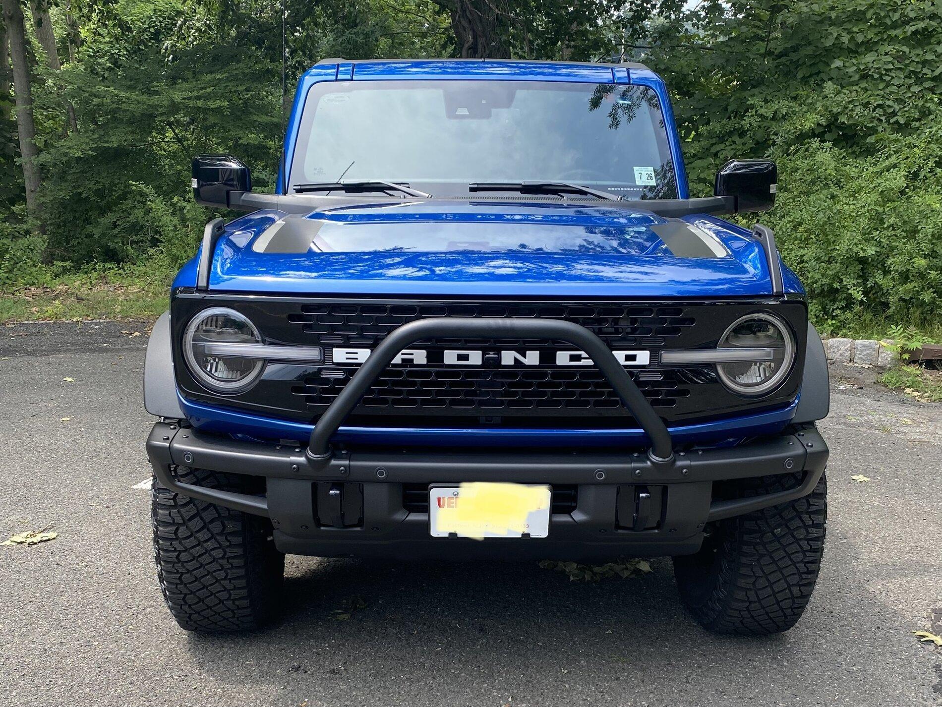

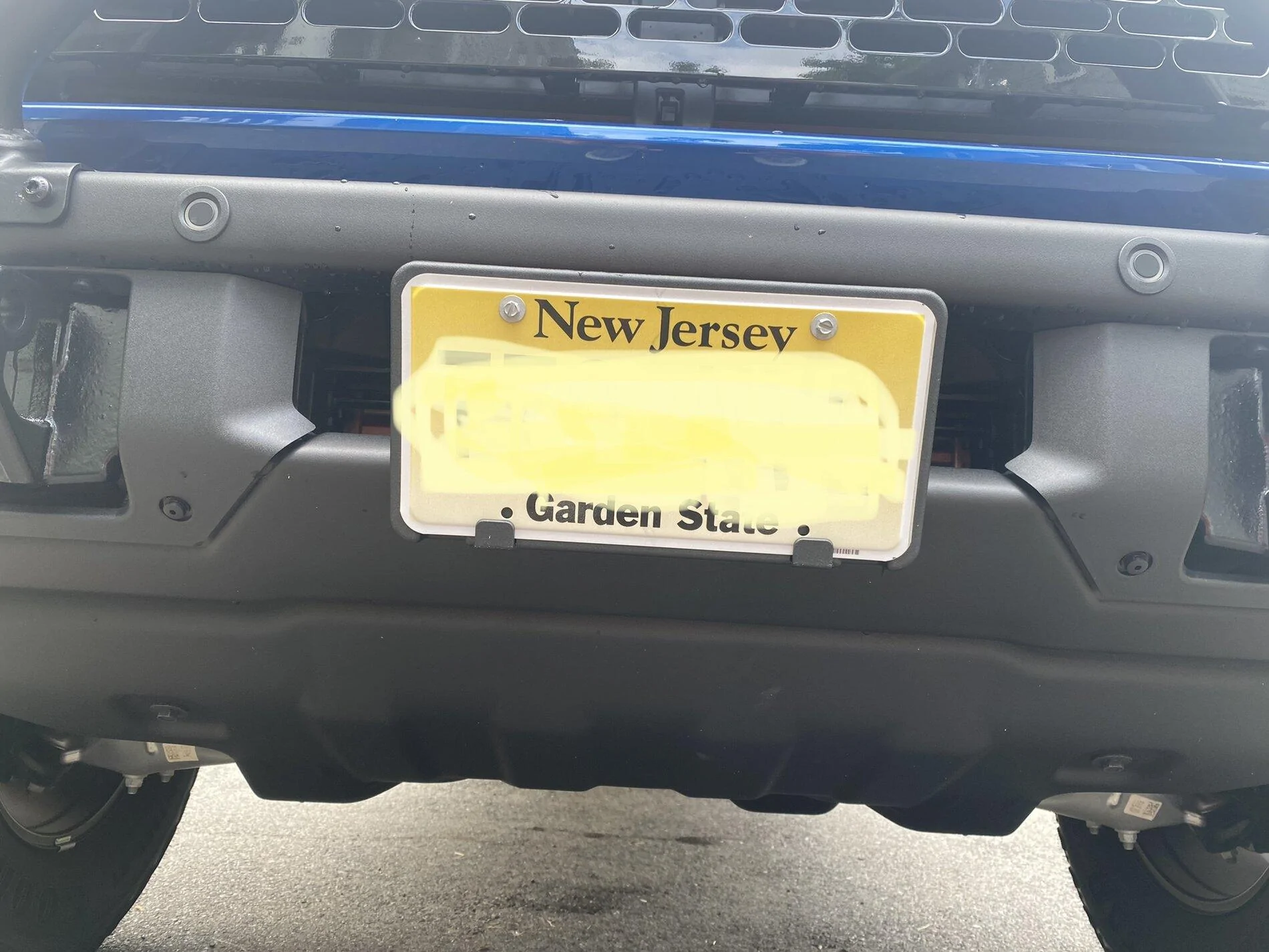

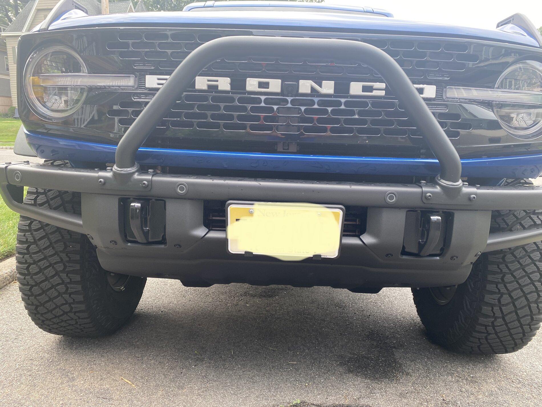

Getting an error message that my recently installed front license plate is blocking the break assist sensor - anyone else having this issue? The actual plate is no bigger than the temporary plate. Included 3 pics, last one with the trees in the background was with the original dealer plate, no issue.
Whoever installed your plate installed it in the wrong spot the modular bumpers have the plate installed up high we’re the plastic trim first starts
