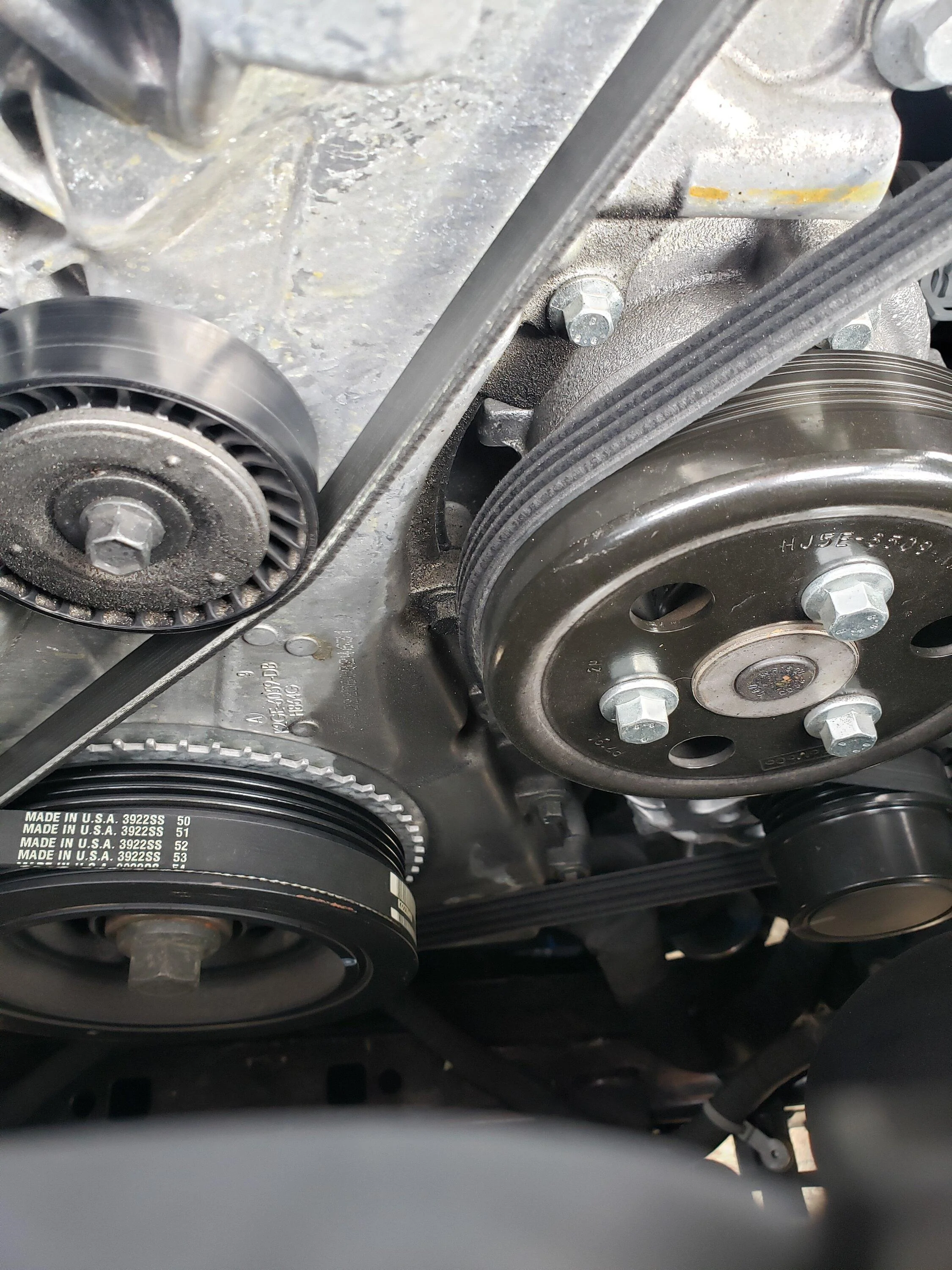

I noticed that mine has a slow leak at the timing cover as well. Same spot, near the alternator pulley.

Just noticed it on my 2021 2.3 the other day as well... yay.

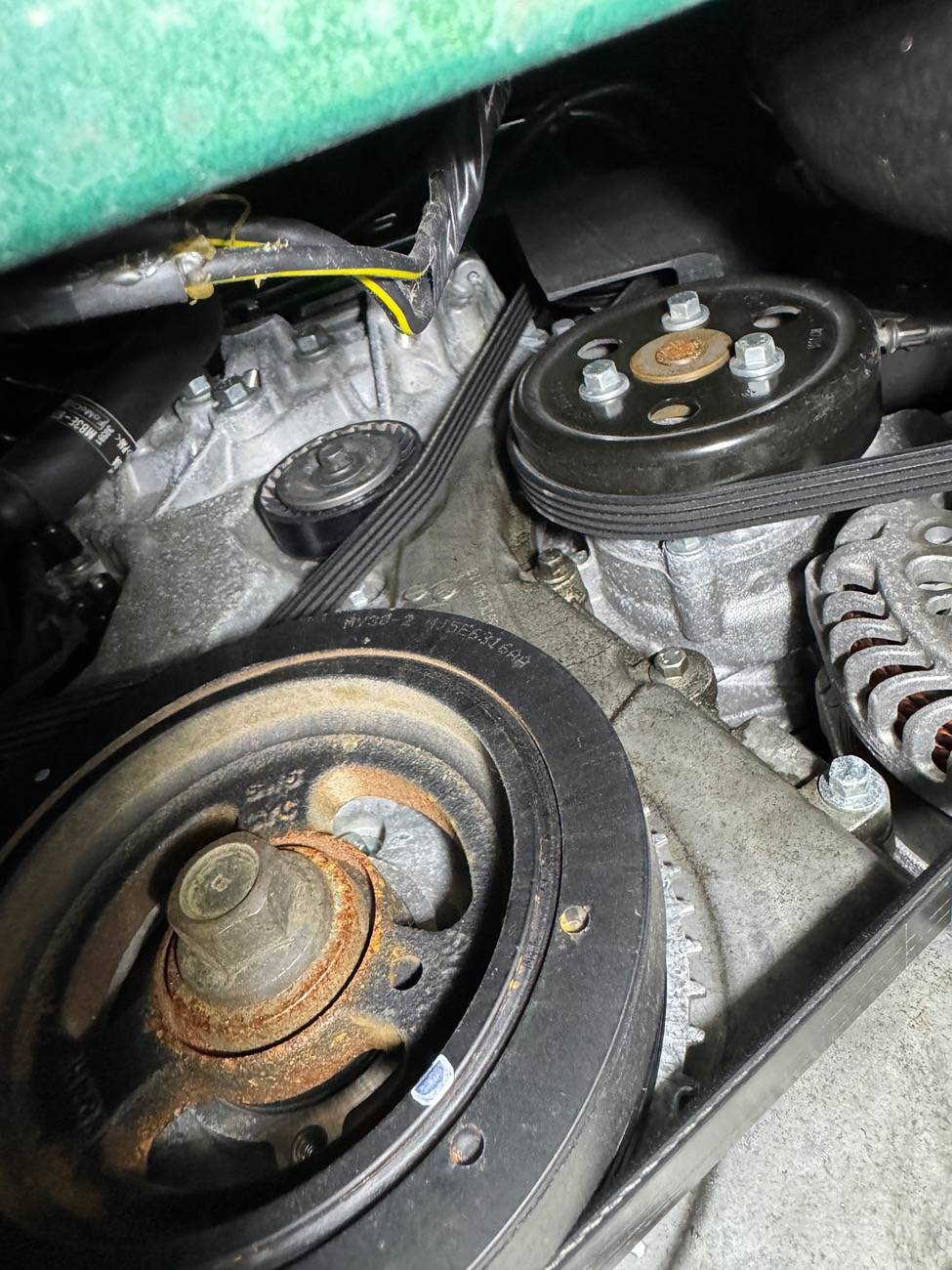

The timing cover on mine still leaks. It’s covered in dirt and spreading and making a mess. I’m thinking of making an appointment at the dealership but before I do. Does anyone know the torque spec for the timing cover bolts? I want to see if they’re just loose.

Just noticed it on mine as well, gonna try to check torque if I can find the specs, time to call the dealer.

I sent my dealer this picture and they got me in the next day
Hmm. Mine looks kinda like that, but no drip or drop on the floor so I'm thinking its fine. Maybe I should reconsider.

I dint have a drip either but it’s under warranty and shouldn’t have a leak like that at 11k. Dealer didn’t put up a fight at all.
