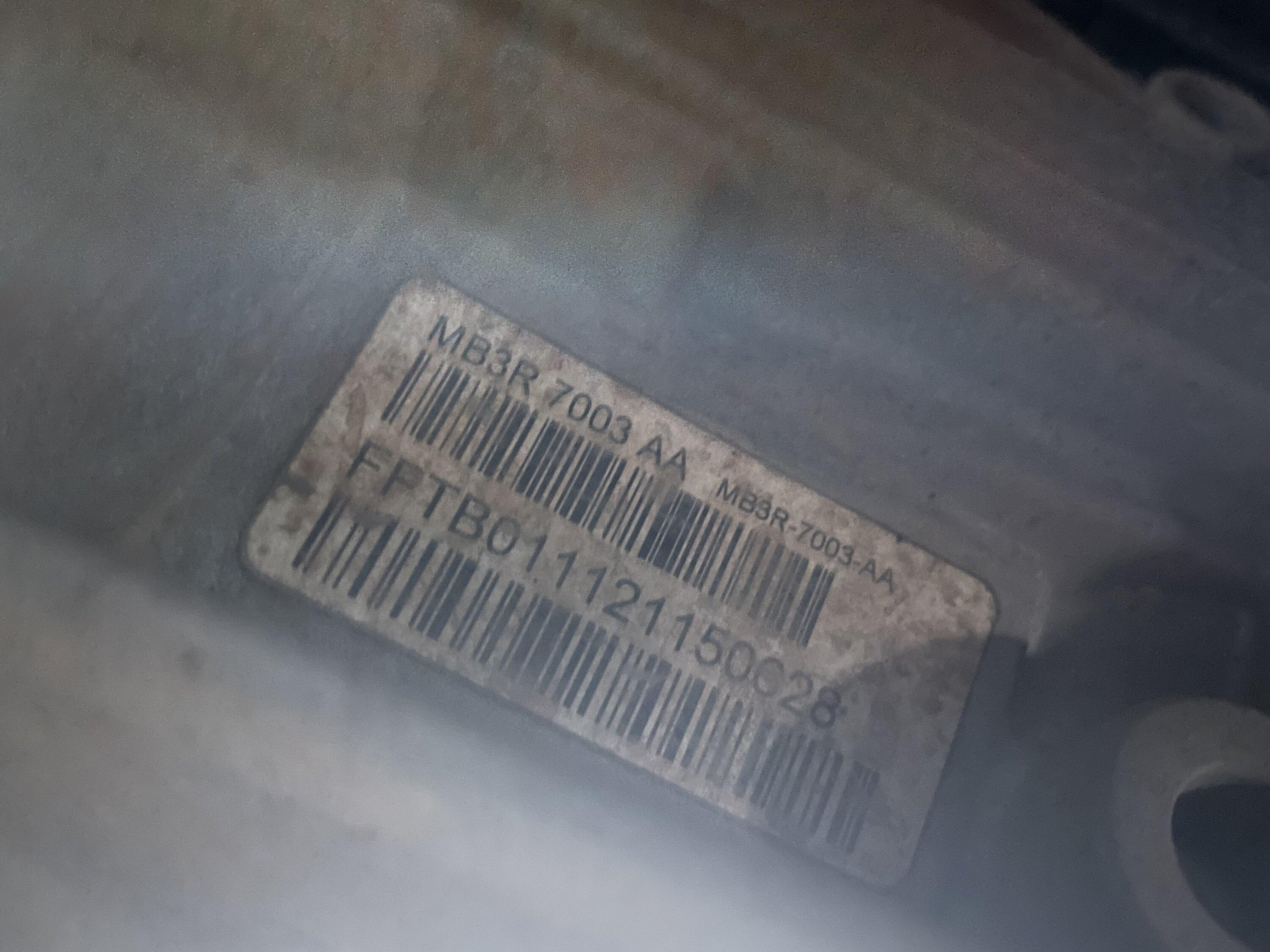

can you share picture of the sticker on your tranny please ?

can you share picture of the sticker on your tranny please?
I have a transmission skid...lemme see if I can easily access it without removing it this morning. Otherwise, it will have to be on Monday when I have some garage time.

@djp - same as all of the other culprits, correct?
Ford Bronco 2.3L Manual Transmission fluid discussion 48E1F95C-F1C6-4414-9933-2CFB1B2DCA1A
Yep, that's identical to mine: 2022 Badlands
We both have -AA
My 2022 Badlands has tranny build date: 12-08-21
Your is 01-11-21
We both have -AA
Your is 01-11-21
Now I wonder when that July 2021 blend date trans was built…
