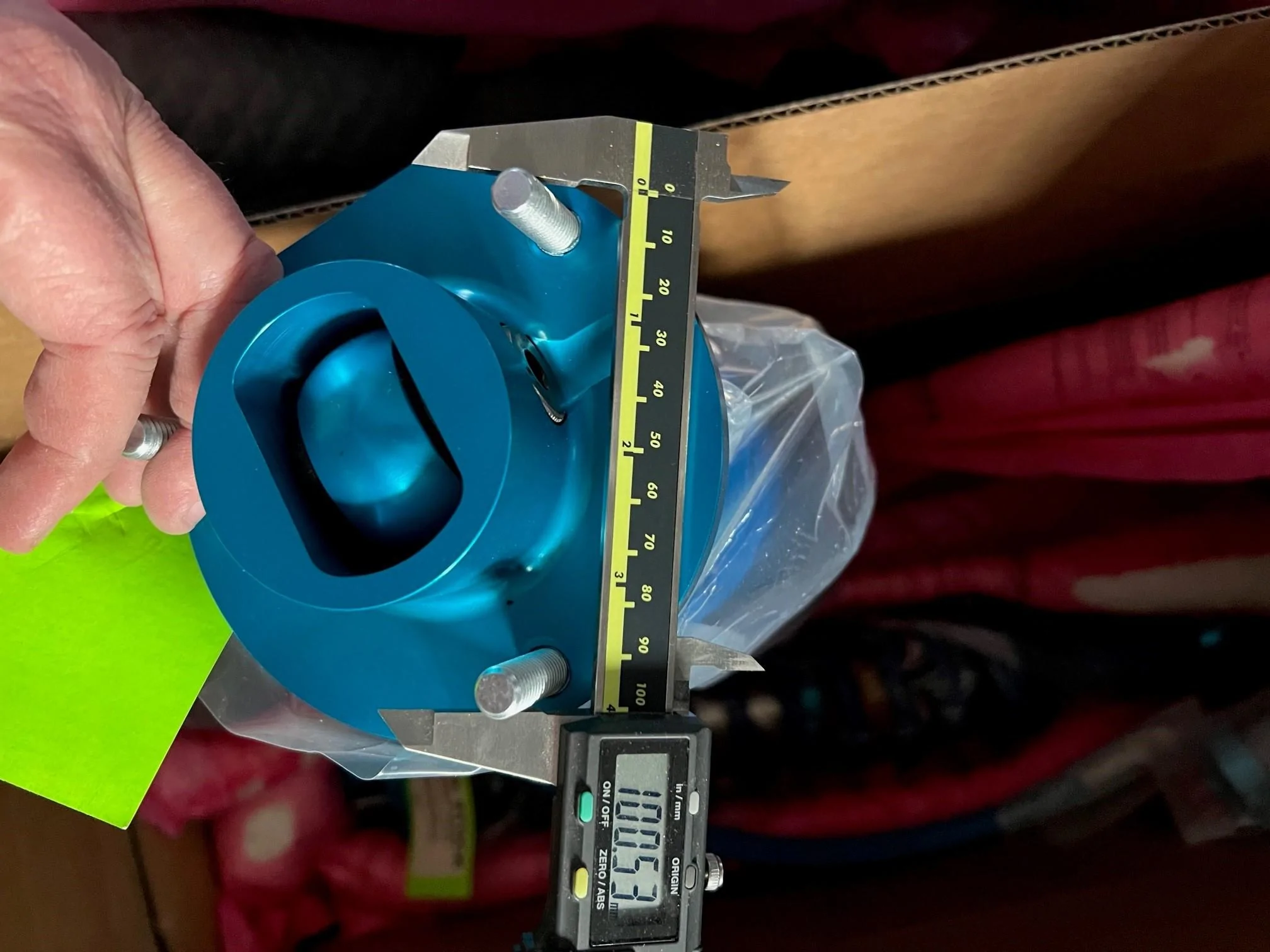

Thank you for the summary of your install experience, I have a set of these arriving Monday, and it would sure be nice if I could inspect them for the incorrect upper mount condition that you had, before tearing into the install....Can you elaborate on what was wrong, and what to look for? Thanks! -Rob

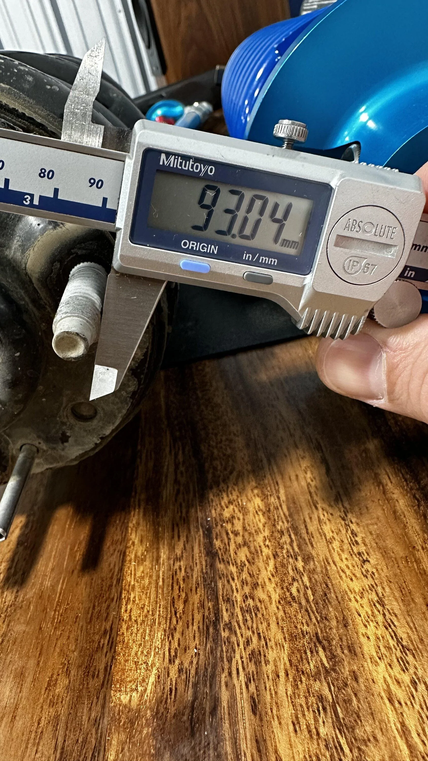

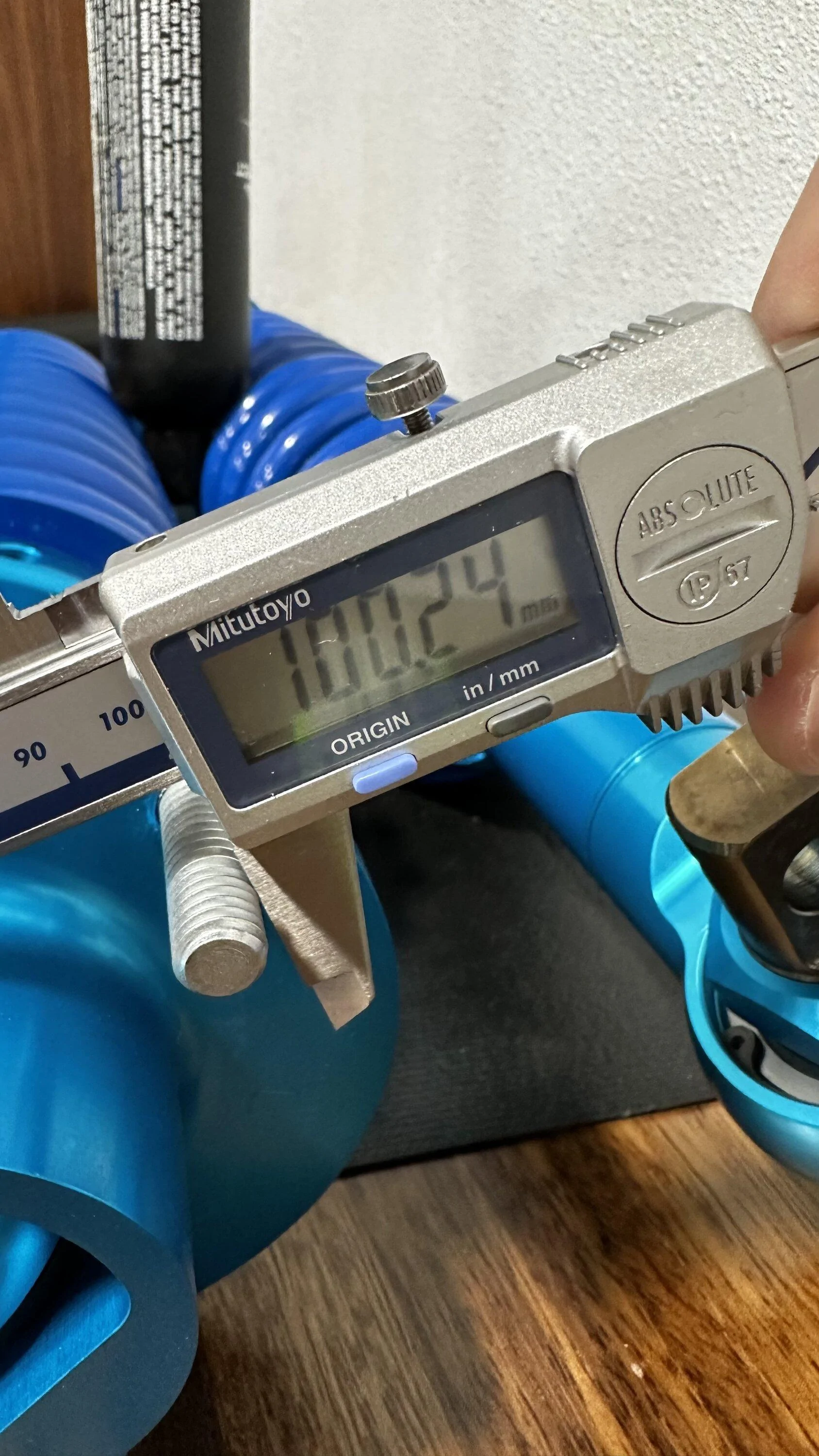

Sure thing. I installed the rears first. Those went off without a hitch. When I went to install the fronts, I found that the upper mount stud spacing was off. The studs and OEM holes did not line up. Pictures of OEM and what I was working with from KING. 93mm OEM stud spacing Vs 100mm. Shot KING an email and pics and they sent out replacements.

Ah, I see. Off just enough to not go in.... I'll be checking mine for sure. Thank you!
Yep :/ we got a batch with the same. They are Tundra top hats.

Just received my fronts and checked them, sure enough, they have the wrong upper mounts on them. Thanks again OP for the info, would have sucked big time to discover this after tearing into the install. Fired off an email to King, hopefully they can send me the right ones quickly....(Update: King was super responsive, and is sending out new mounts immediately)

I also had the wrong top hat on one side. Got I new by the next day from King. Now I have a weird issue of the front sitting over 2" higher then SAS at the lowest possible setting. Me or the shop can't understand why its sitting so high. I want to take out 1/2" but physically can't.
going to pull mine out of the box when I get home from work to check but are front and rears both 93mm spacing?
I never measured the rears, since they went right in and I did the rear first. I would think that they're the same stud diameter and spacing.
