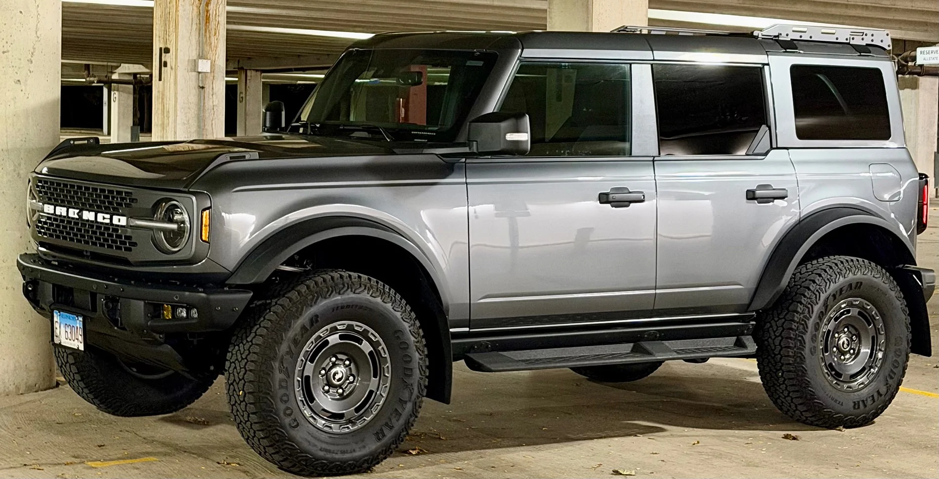

Thanks! Looks great! Did you setup your springs as the instructions say to or did you find that you needed to increase or decrease pre load using the adjustable collar?
Looks great with a little extra lift. What size KO2s are those?
Dust Hazard
Aug 28, 2025
Las Vegas, Nevada
24 Ford Bronco Badlands Sasq.
No worries and thanks! Mine were pretty close to the lowest setting right out of the box, but the shop backed them off a bit more to get as close to factory preload as possible while still keeping some tension on the spring. That said, with the OEM Sasquatch springs, you really can’t go much lower — the springs are tall and stiff, so even at the lowest setting, I still ended up with about 1.75" of lift up front and 1.25" in the rear. What’s really nice about this setup is how easy it is to make adjustments later on — whether you want more height or decide to run larger tires.

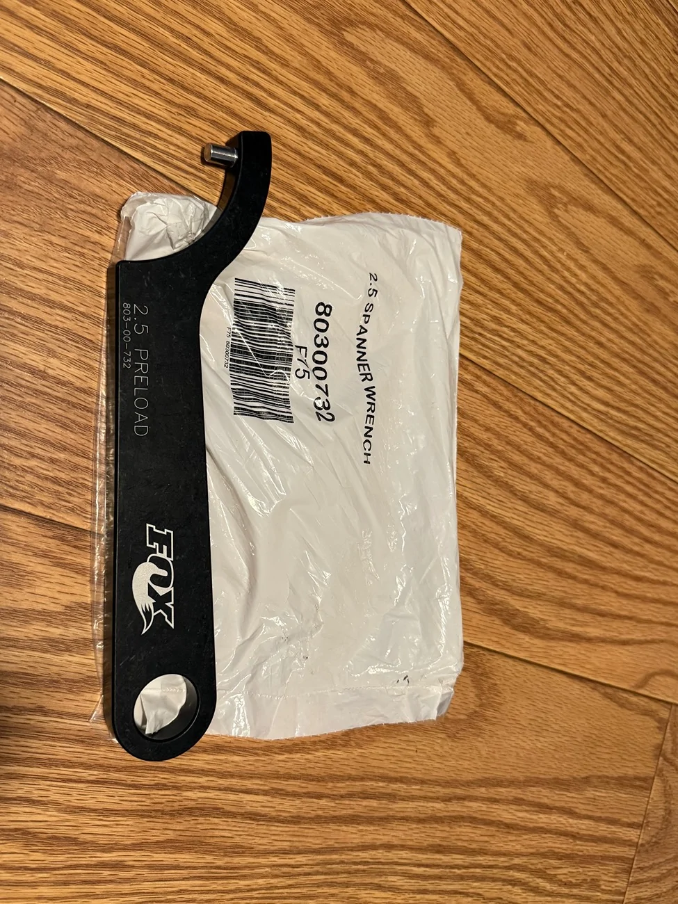

Can anyone share what spanner wrench they used on these? Fox gave me a part number of Fox 803-00-732 and it does not fit. Called back and well, they are not sure
this is the one that does not fit
Appartenly, Fox has the same issue with their own spanner wrench not fitting their 2.5" Performance Elite coilovers too.

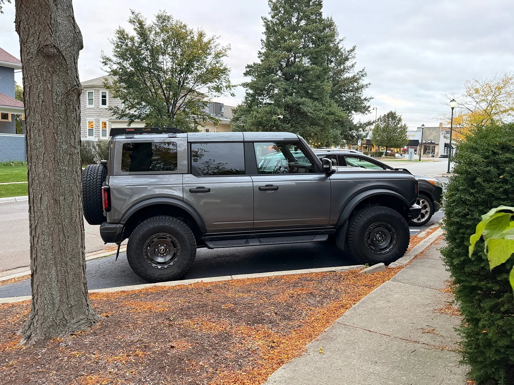

Well, got em in finally. Went up 1” up front and 1/2” back. Still have 1/2” lean that I wanted
Only got 20 miles on it but so far it’s good.
A trusted off road speciality shop did the installation and said they are not adjustable on the rig and had to pull them 3 times to dial it in

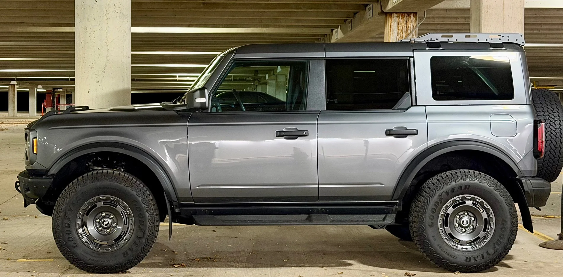

Just did my maiden voyage to work on a route I’ve driven daily for years and know every bump.
Can’t speak for off road yet but on crappy washboard roads this setup is great! Potholes, railroad tracks can barely fell em, have a highway circular off ramp that’s 25 mph. Tried 50 mph last night and had almost no lean.
comparing to a stage 3 Halo setup on a 150 Tremor that was near $4k, these ride as good if not better
