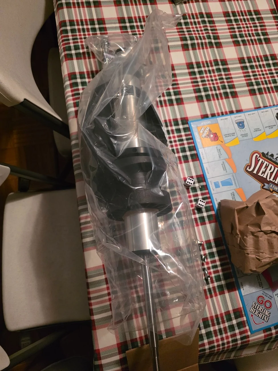

Just got mine delivered, now I have a big bend and I'm using them to level out the front of my bronco along with whitline upper control arms. Now do i use the oem springs or buy new ones. Oh my big bend is a 2025.
