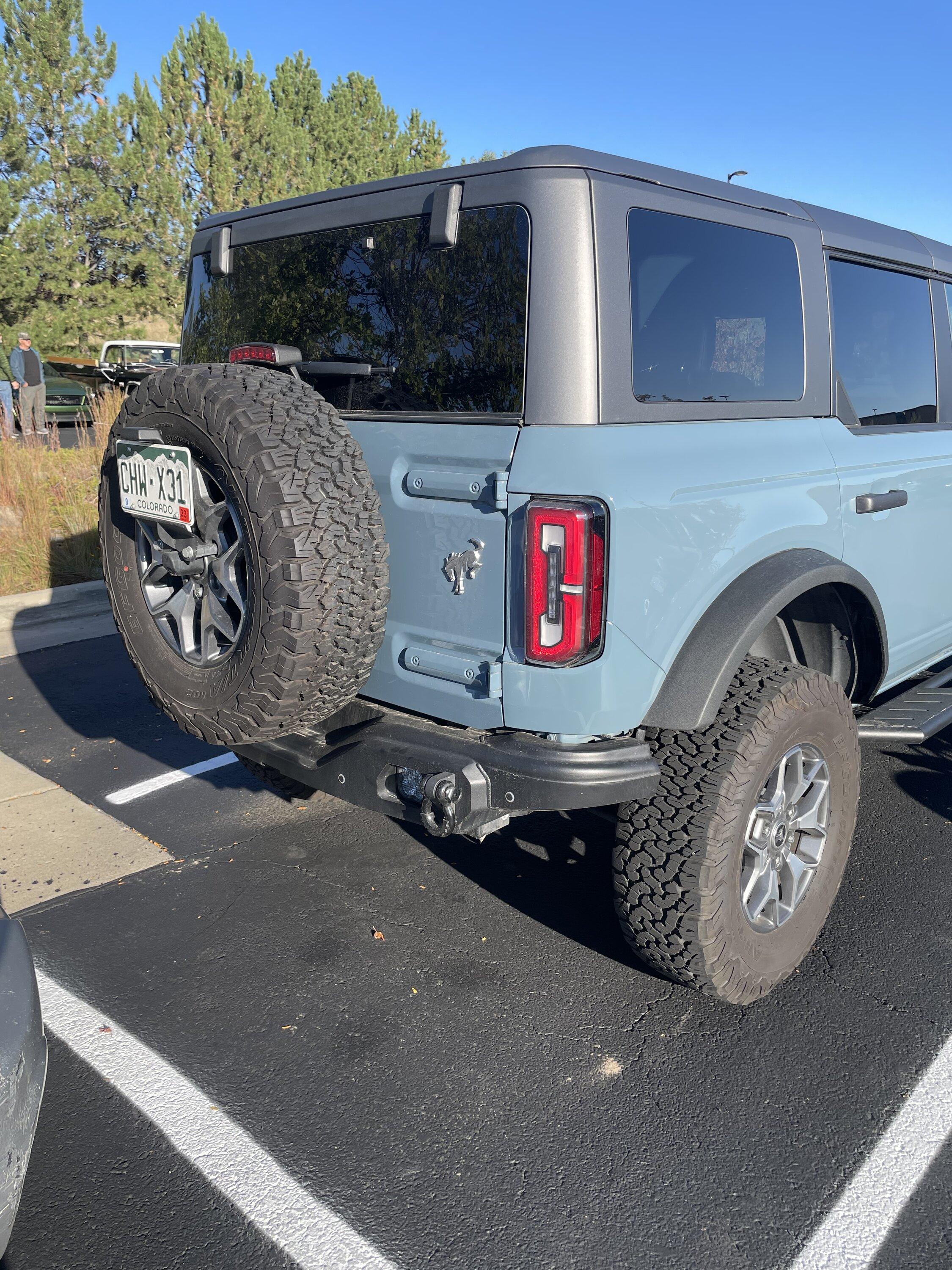

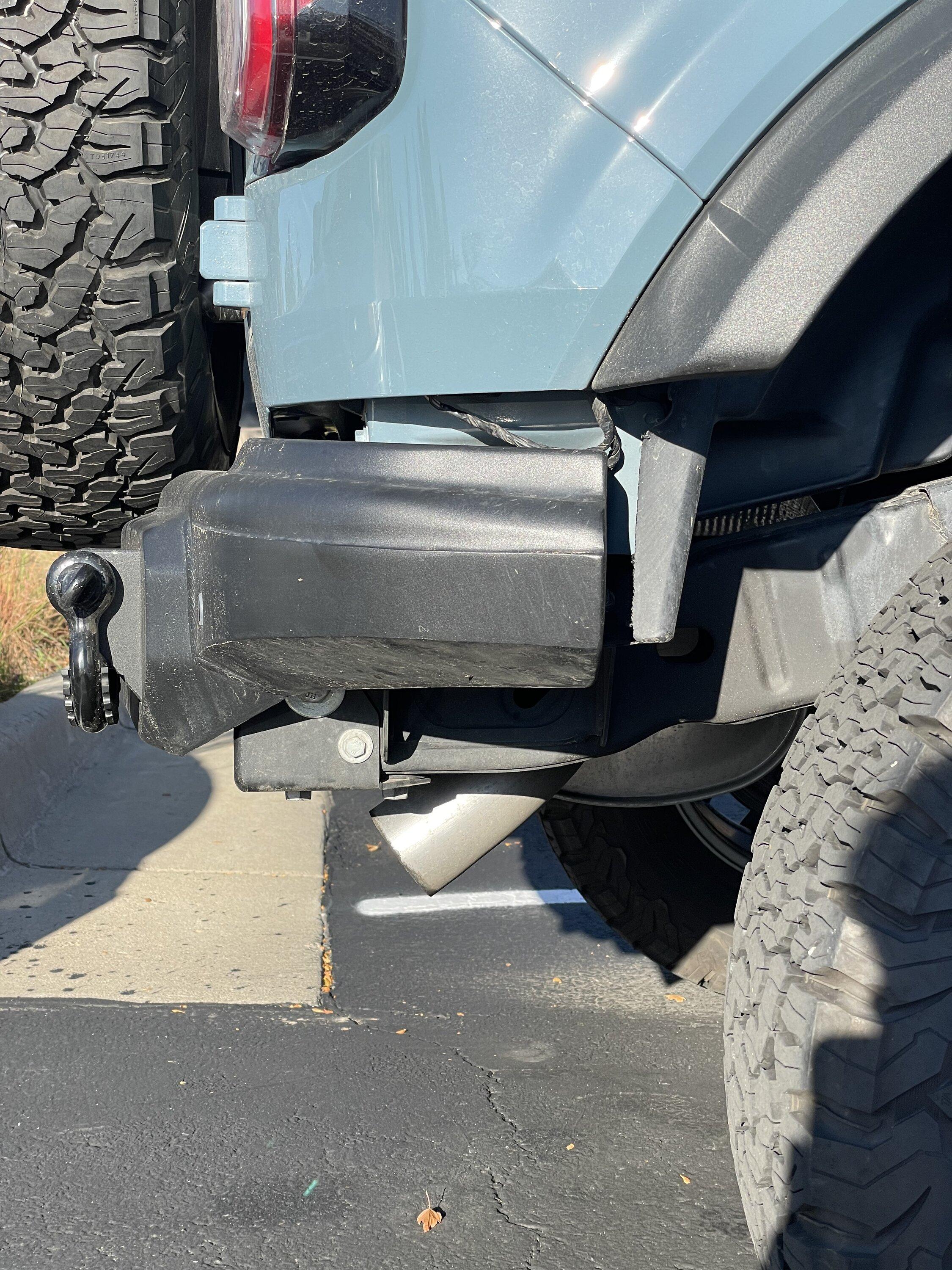

Well, shit.... 🤦🏻‍♂️🤣
I was doing a u-turn at full lock and drove over a curb. I heard the crunch and knew immediately what happened.
I've got the JKS extreme clearance kit coming and am waiting on the email for ordering another resi clamp. I think the best option for me is to stick it up where it was, but further in-board/forward by getting rid of the crash bar mounts.
Bungee'd up for the drive home.
If i remember right those those brackets install on the bottom not the top . @ragingbullmarketingrbm
Evolkidbell
Jul 17, 2020
588
837
Northern Colorado
1966 Bronco, 2013 F-150
He couldn’t mount to the bottom as it interfered with his bumper.
Skid plate, but yes, there's a picture of the issue posted earlier.
My replacement clamp will be here later this week.

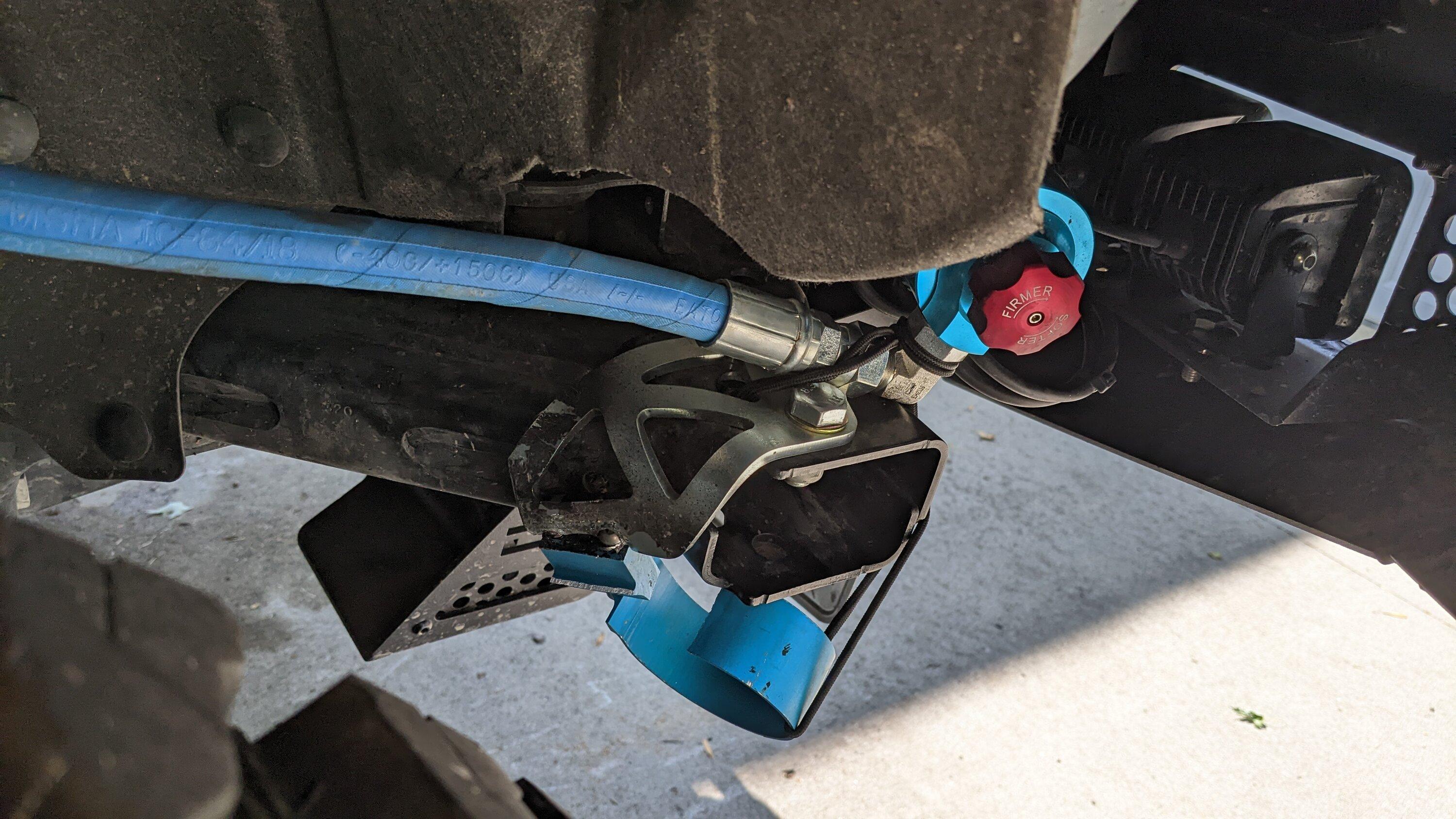

Well, with a little creative engineering, I was able to modify the reservoir brackets to mount to the top of the crash bar mounts, tucking the resi's nicely up behind the bumper.
My first attempt was to have the resi's follow the frame line but between the chassis and body mount. It just wasn't a good fit as there's a flange that's in the worst spot and prevents the bracket from fitting.
The "fix" just required one hole to move the bracket over, and then cutting off the "extra hole" point of the bracket. Once in location, I used an adjustable wrench to bend the bracket down about 10°, then put the aluminum collar mount on. The brackets are hot dipped or some such mild steel, so I shot the new hole and cut end with some black paint.
I did trim the fender liner a bit to make a hole as well.
The lower OEM shock studs are the same size as the crash bar bolts, so I used those nyloc nuts to secure the bolts King provided. Too easy! 😎
I still need to finish greasing everything, but she's installed.
Be careful with that trim up against the reservoir hose. Had trim against mine in my f150 and it really wore it down to the braiding underneath. That trim in the bronco may be softer but it can still happen.
