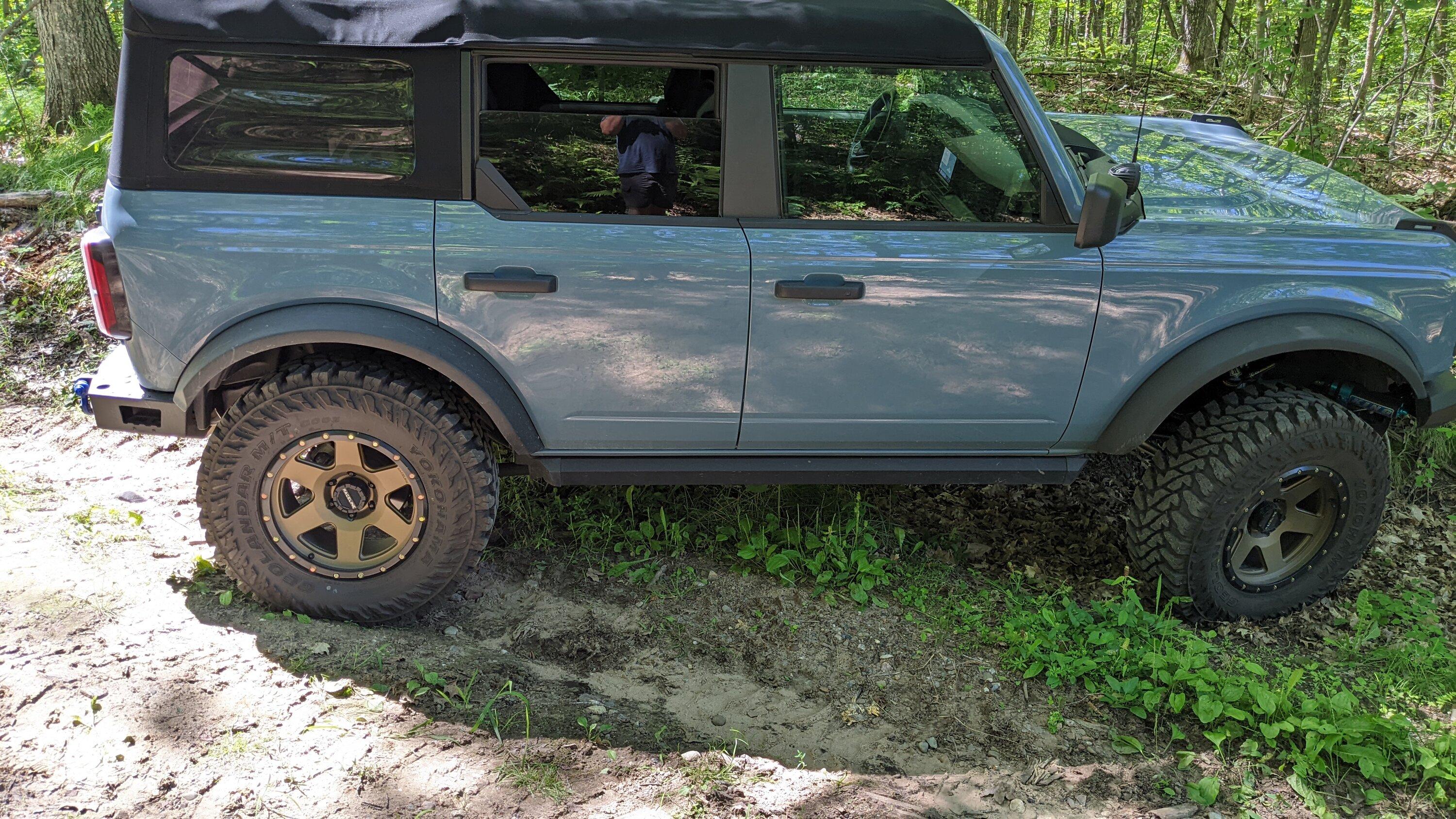

Just a little flex in my woods.
Ford Bronco King 2.5 Bronco kit installed Polish_20220810_140609769

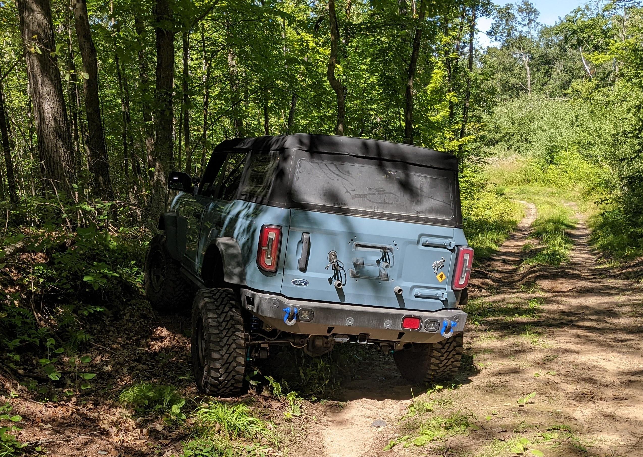

Anyone who says the grab handles are in a dumb spot hasn't tried re-entry from this position. 🤣

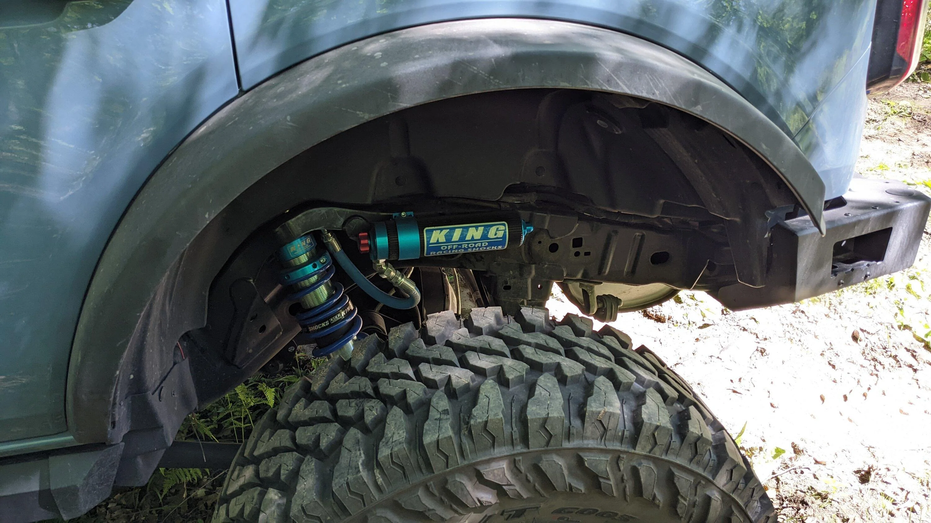

There's plenty of room around the rear reservoir when tucked this much. I can get the thickest part of my hand between the cylinder and sidewall.
I could've pushed higher, but this was a downward slope and rolling is a possibility. lol

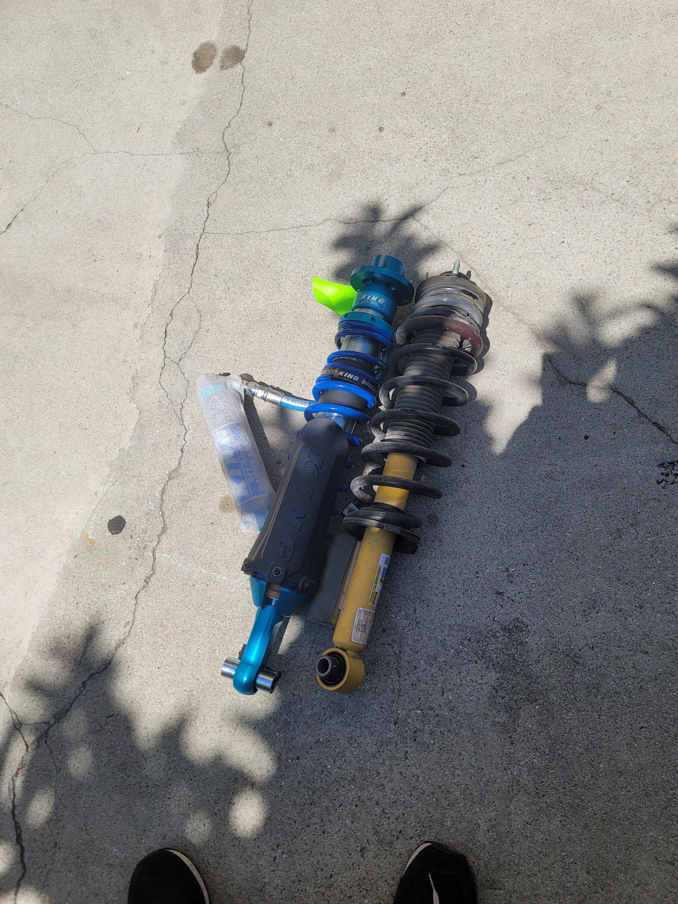

Removed the stock BB Hitachi units that had a 2” spacer lift installed and still gained a full inch over previous height. Ride quality is firmer, but noticeably improved across the board.
One note for anyone who is removing a similar config as mine - I had to use a coil spring compressor to remove both fronts and to install the driver’s side unit. Didn’t bother to determine why that side was different, but it’s a simple fix.

I didn’t. Disconnected the track bar and tie rod then used the coil compressor and a long prybar to get them out and back in. Don’t think the passenger tie rod was absolutely necessary, but driver side definitely was. Without the coil compressor, I think I would’ve needed to remove the Lower arms as well.
This may be different on stock shocks with no spacer lift installed, but with the added height of the lift spacers plus the top-mounted lower shock bolts that have to come all the way through the lower arm, I didn’t have enough space without compressing the springs quite a bit.
Thankfully, the Kings come with bolts that are installed from the bottom side of the control arm after the shock is in position.

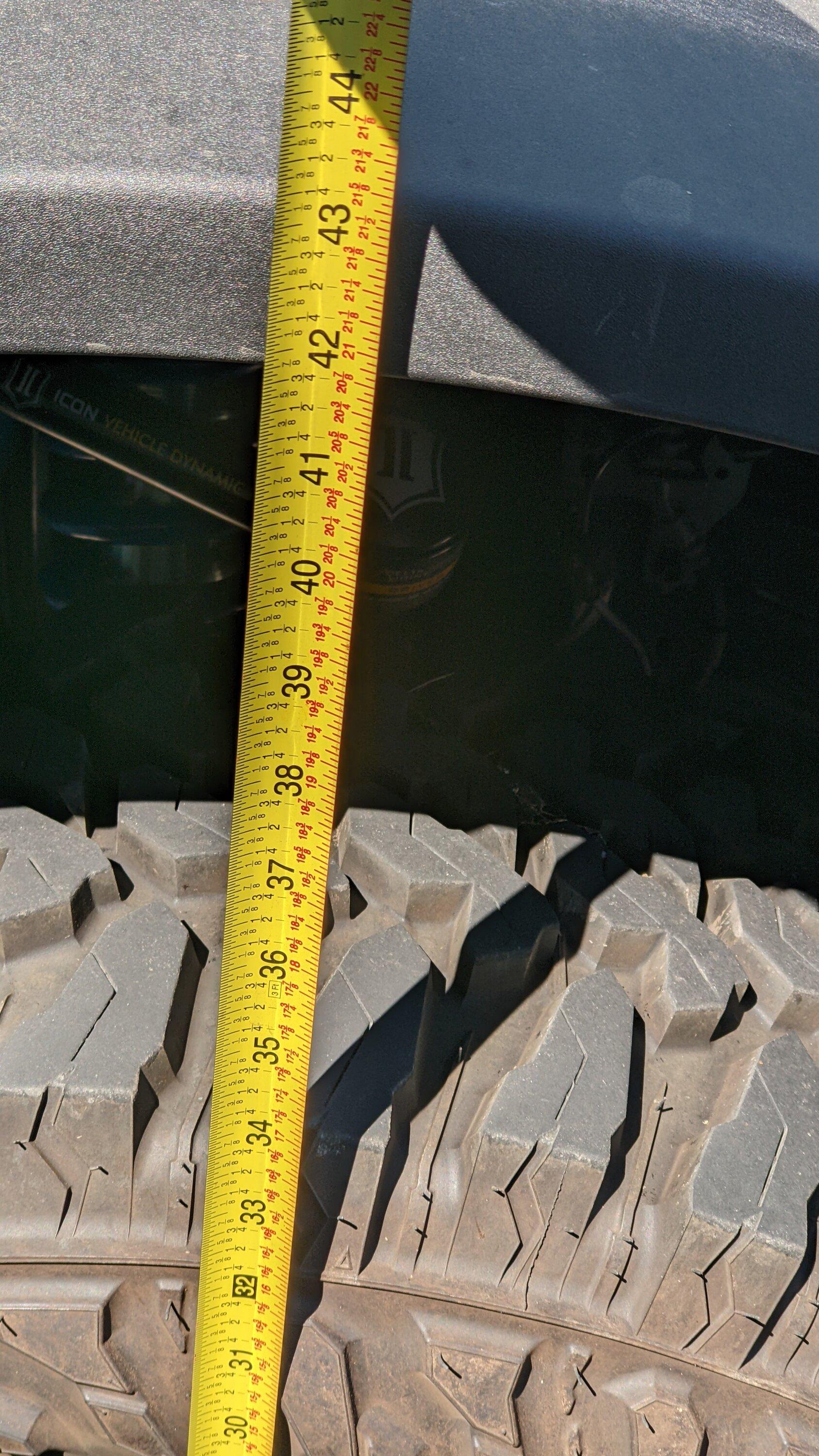

I’ve got 315’s on mine that are almost worn out (will have 37” KM3’s in a couple of weeks!). It’s sitting at 40 3/4” in front and 41 3/4” in the rear. I’ll make small adjustments to level everything out once the new tires and wheels are on.
For reference, The Kings gained +2” over the stock BB non-squatch shocks with a 2” spacer lift installed on my 2DR.
