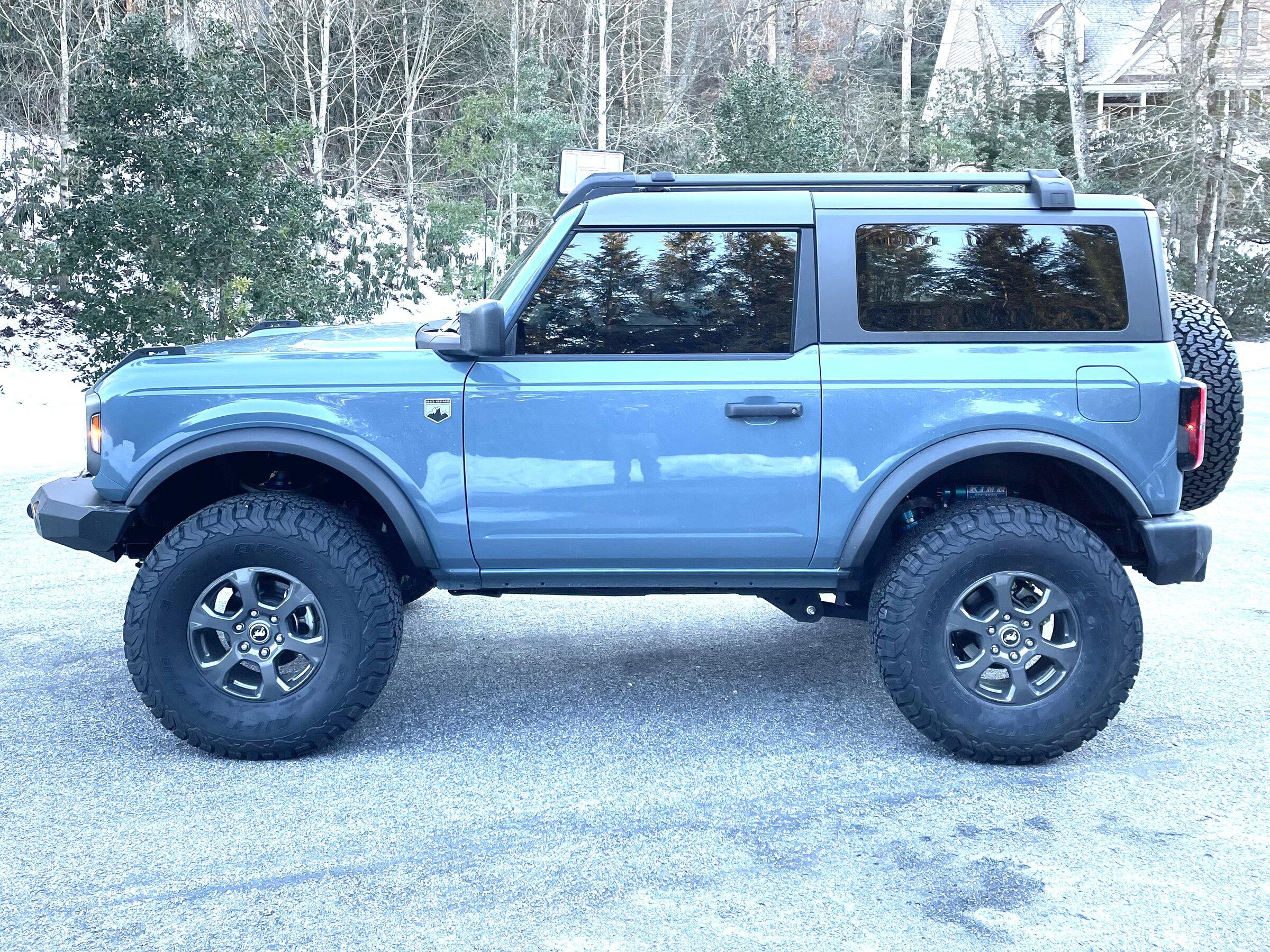

2.5" according to their website, but I swear it feels like a lot more over stock! I just popped these on over the weekend with 37's, and it's a beast!
Ford Bronco Bronco King Shocks 2.5 are available IMG_1823

Those are stock rims? How is the clearance on the front reservoirs with 37’s? In your opinion would 35’s pose any issues?

Correct, stock rims with a 1.25” wheel spacers. The 37’s actually did rub the reservoir but I moved it forward just a pinch and it clears fine now. I need to see how it does under articulation still. You should have no issues with 35’s- these 37’s measure about 35.5” on the vehicle, so you’ll be under that for sure.

2.5" refers to the shock diameter not the lift. the lift is determined by spring rate and spring preload. probably set a little over 3" from king.
