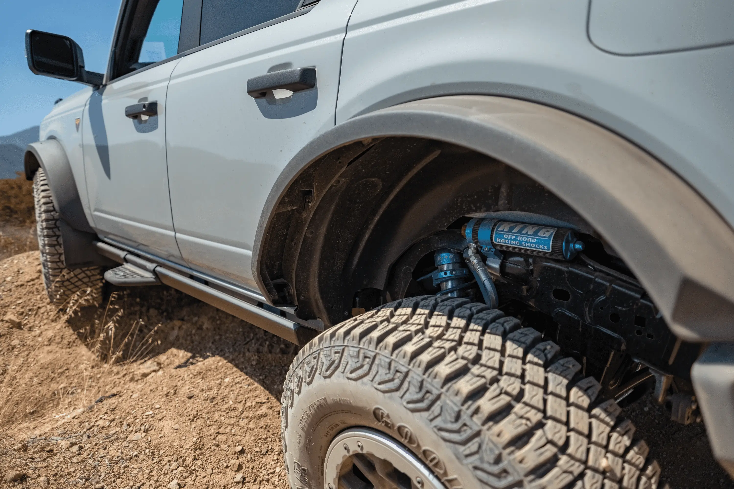

Great install. I have the Bronco King's 2.5 on my Badlands.
I had to have my off road shop install mine then went to Ford for alignment. For those of us without the skills, time or ambition to self install I paid $475 for the install plus I had to have an alignment after.
Just had them installed a few last week and went off roading on a 25 mile loop of old mountain fire trails with some washed out ruts and rocks. The King's performed great. The trail I took was on is very similar to the higher speed trails at Nevada Off -Roadeo. I noticed their Badlands SAS would bottom out and I exceeded the suspensions limits a few times. (At Off-Roadeo, I was the lead Bronco so our instructor let me drive faster than typical.)
I knew after my Off Roadeo trip, I needed to upgrade the shocks or live with slowing down...My set up with the King's on a similar trail to Off Roadeo this weekend while driving faster, I never felt like I was even close to the limit of the shocks. On small chop they are very smooth, but on the big whoops or washouts I found they excel.
Looking forward to trying them on higher speed desert runs, just waiting for cooler weather. But even on switch back mountain pass trails where you can get up to 40mph, the shocks make a noticeable difference. Noticeably a lot more comfortable off road and when the rut pops up in-front of you, you just soak it up.
On-Road,,, A little stiffer than stock BL SAS shocks, but in a good way. Not hash, just noticed less body roll and overall stiffness had a slight increase. But off-road they had the bronco performing at a noticlby high level and gave me way more confidence.
I had the adjuster on the King's set in the middle of the range.
Ford Bronco King 2.5 Bronco kit installed DSCF1864[57]
