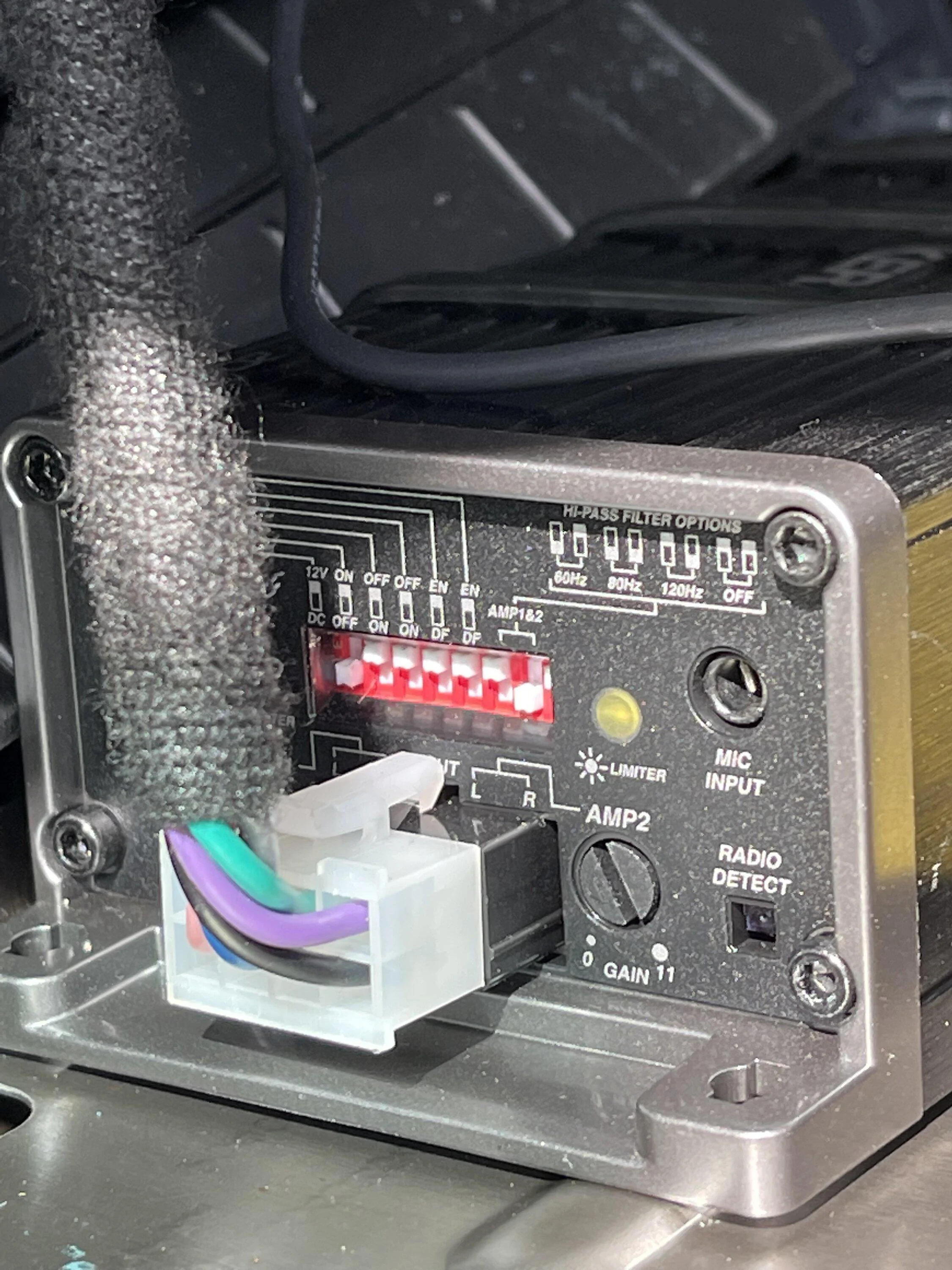

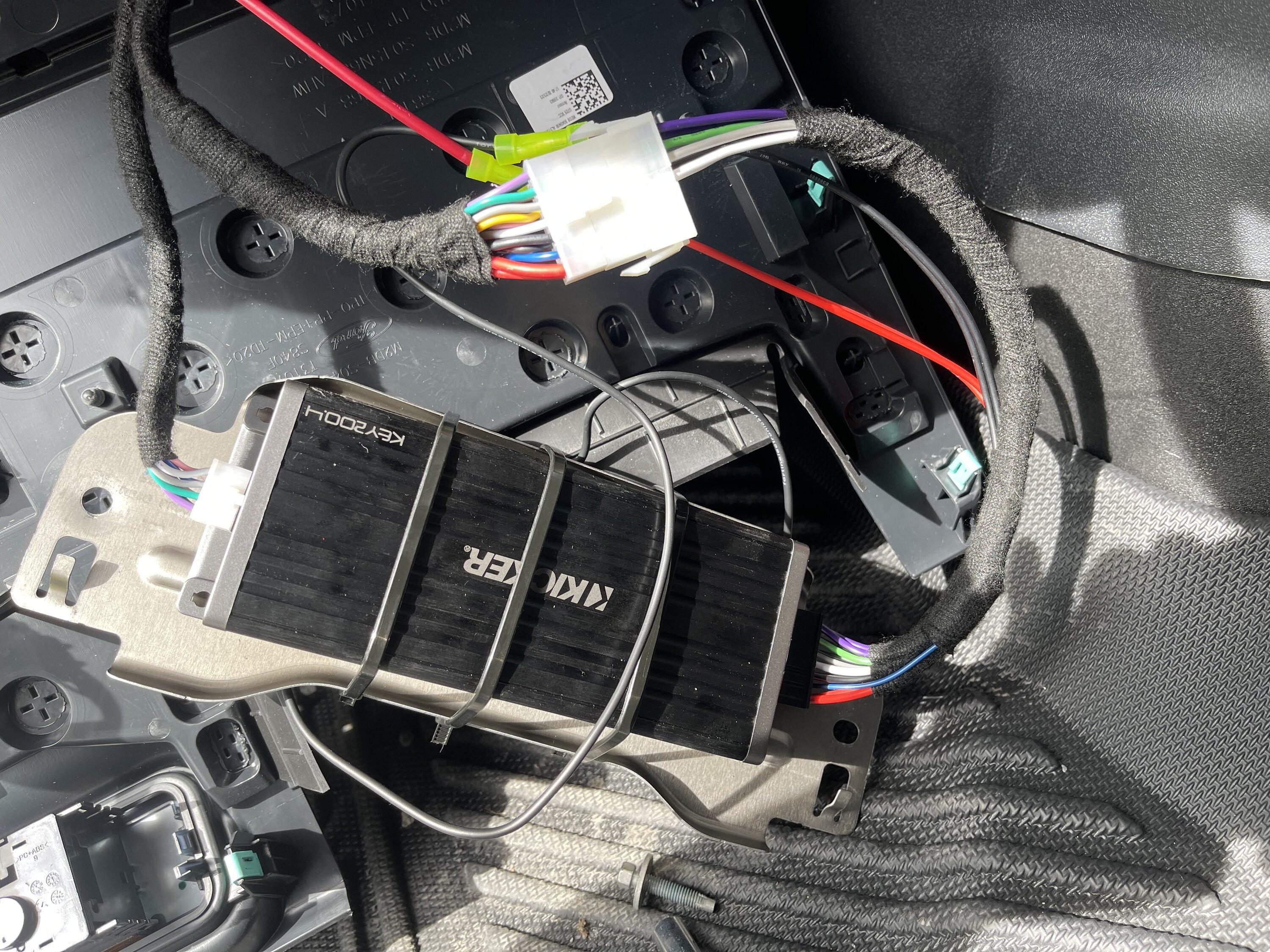

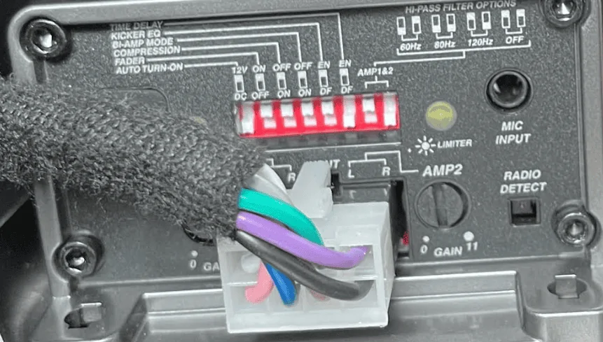

Okay...did all the tweaking. Here's where it landed, and I'm pretty f--king happy.
Turned the gain adjustments on both sides back a 1/4 turn The chimes are now a reasonable volume AND the audio clarity is vastly improved. I couldn't go above 10 in volume before the tweaks without distortion. Now 15 is no problem?
I turned on the hi-pass filter on the amp. Helped a lot. You'll see which setting in the picture.
I didn't touch Forscan.
Pics of the couplers and the amp dip switches are here...you can't see the last switch...It's set for 60hz
I think the difference between me and you right now is that my pods are in forescan as tweeters, not tweeter and speaker. Did you notice a definite increase in output when you made the change from just tweeter to tweeter and speaker? Think I am going to do this next.
