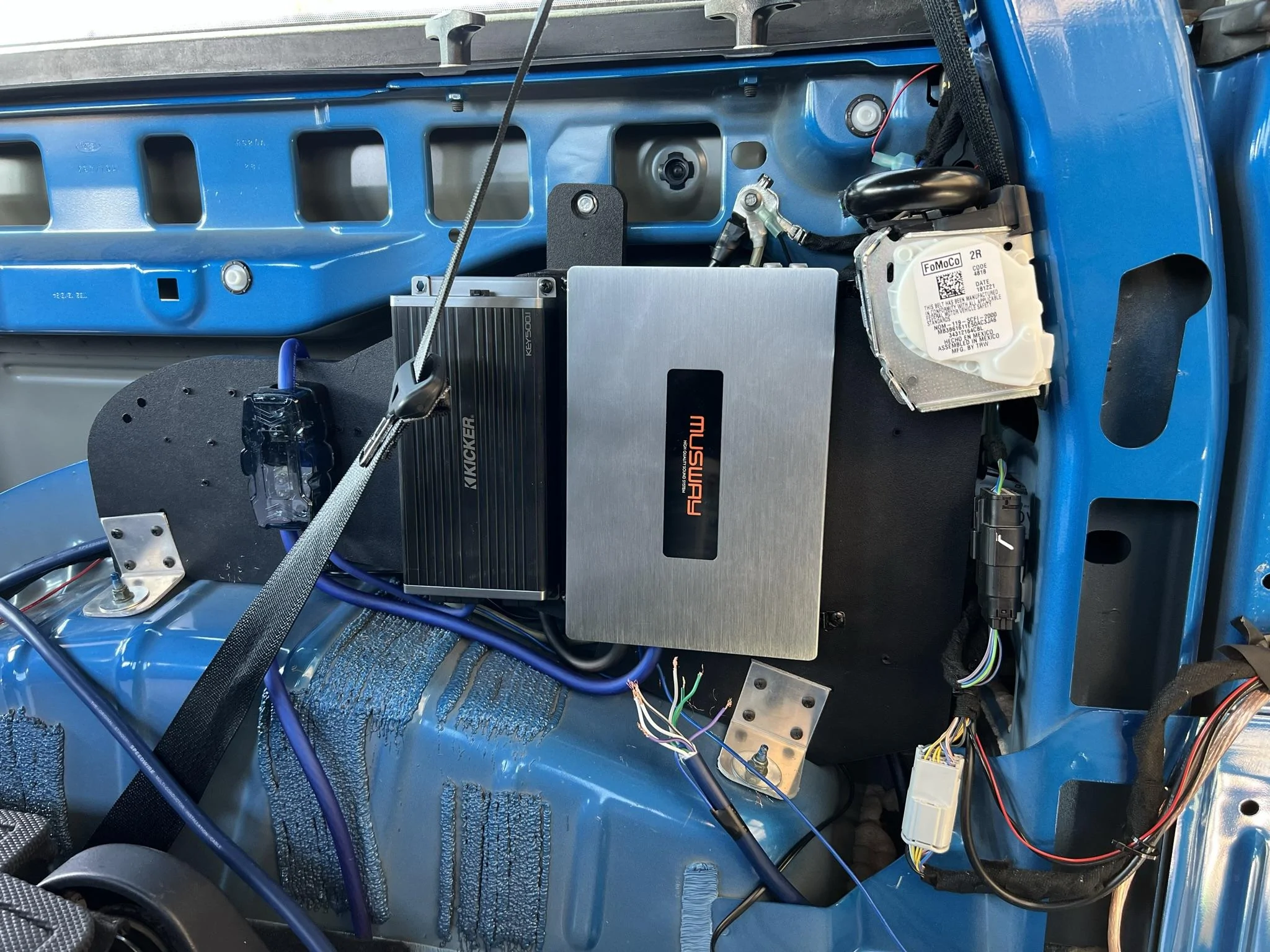

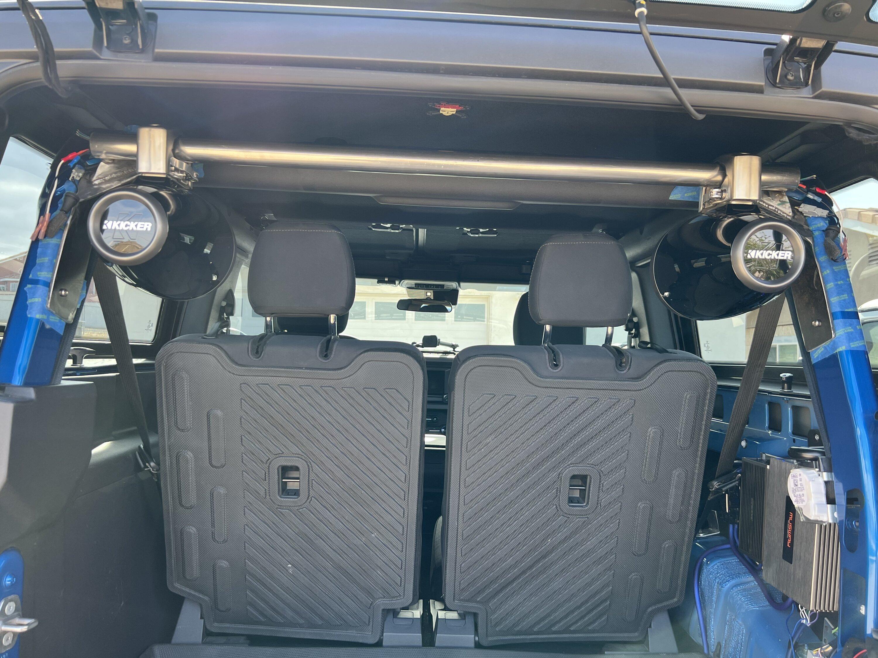

Check out the plug n play musway kit
More adjustability for the front and rear channels.
just swapped out my kicker key 200.4
Sounds great now
