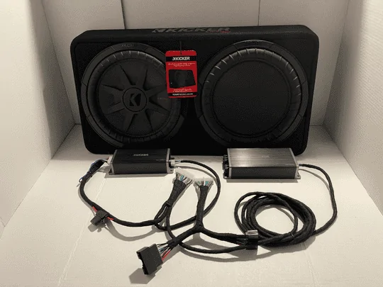

so basically the way its laid out is that he has a harness and then pairs it with what you want
maybe you want a sub or a line out converter or a whatever
auto sound electronics are too complicated thats why its seems all over the place but if you know what you're looking for its actually really cool.
the best deal to me is the kit 26 because you get the kicker key 200.4 and the 500 .1 which will you give power for the main speakers and a power for a sub and the sub all prewired so you basically plug it in and your golden! i mean that's a 3000$ system at a shop and hes got it all buttoned up !~ for only $900
This is exactly what I want to do. A few questions…
(1) Has anyone tried these plugnplay harnesses that include the sub connection?
(1a) How do you connect the sub from the 500.1? Stupid question, but is that plug n play as well?
(1b)Do you still have to run power for the sub to the battery
(2) Any good ideas of where to put the 500.1? It would be nice if it was only the sub exposed.

If you message plug n play they will point you in the right direction as to what you need for a sub. The plug has empty slots on the amp side that he uses for the power sub taps. Like myself I ordered the wrong harness but was able to make it work because the harness is set up to add the sub taps.
you will have to run a separate power and ground for the 500.1.
for mounting you could go under the dash, a seat, or in the hidden cubby in the cargo area.

I’ve seen the 500.1 mounted under a seat: that’s what I’m planning on trying.
