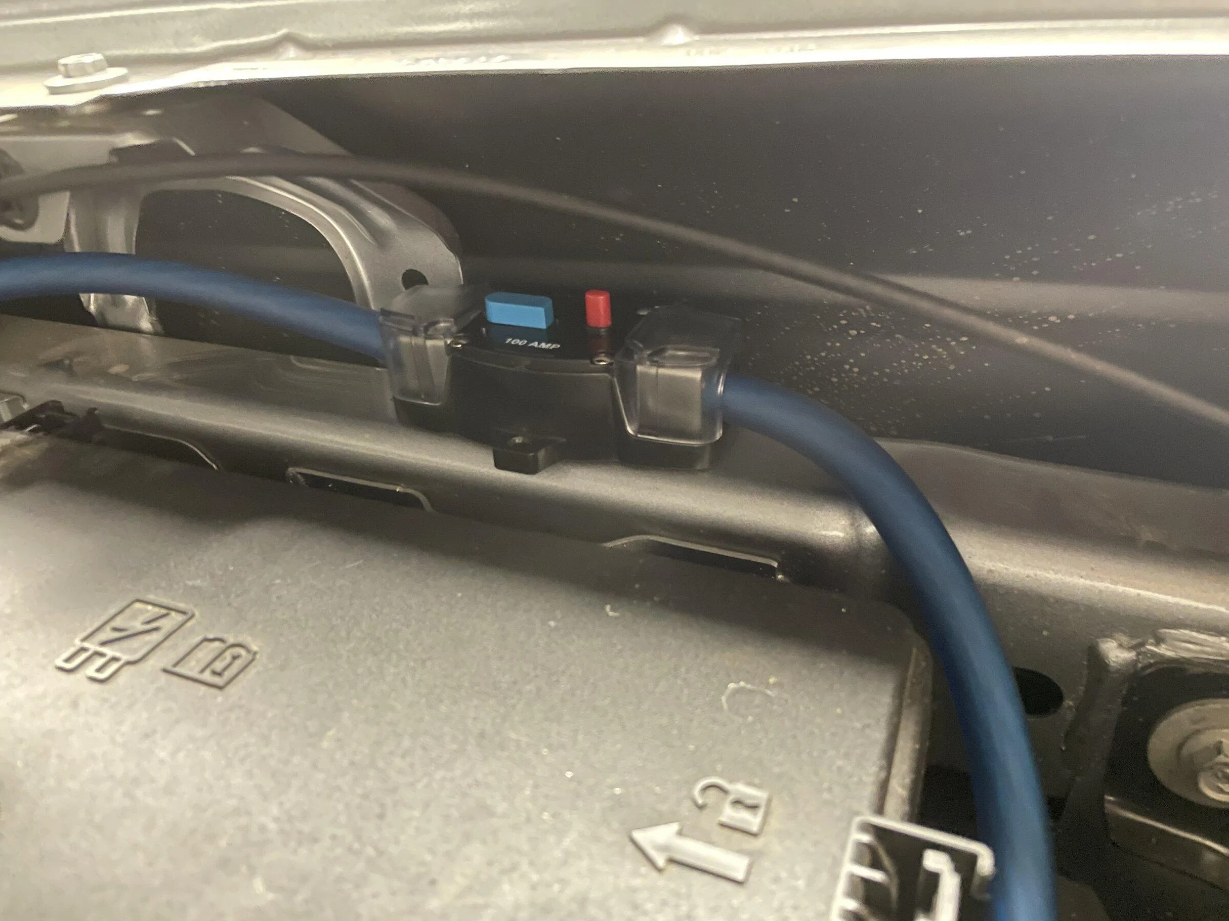

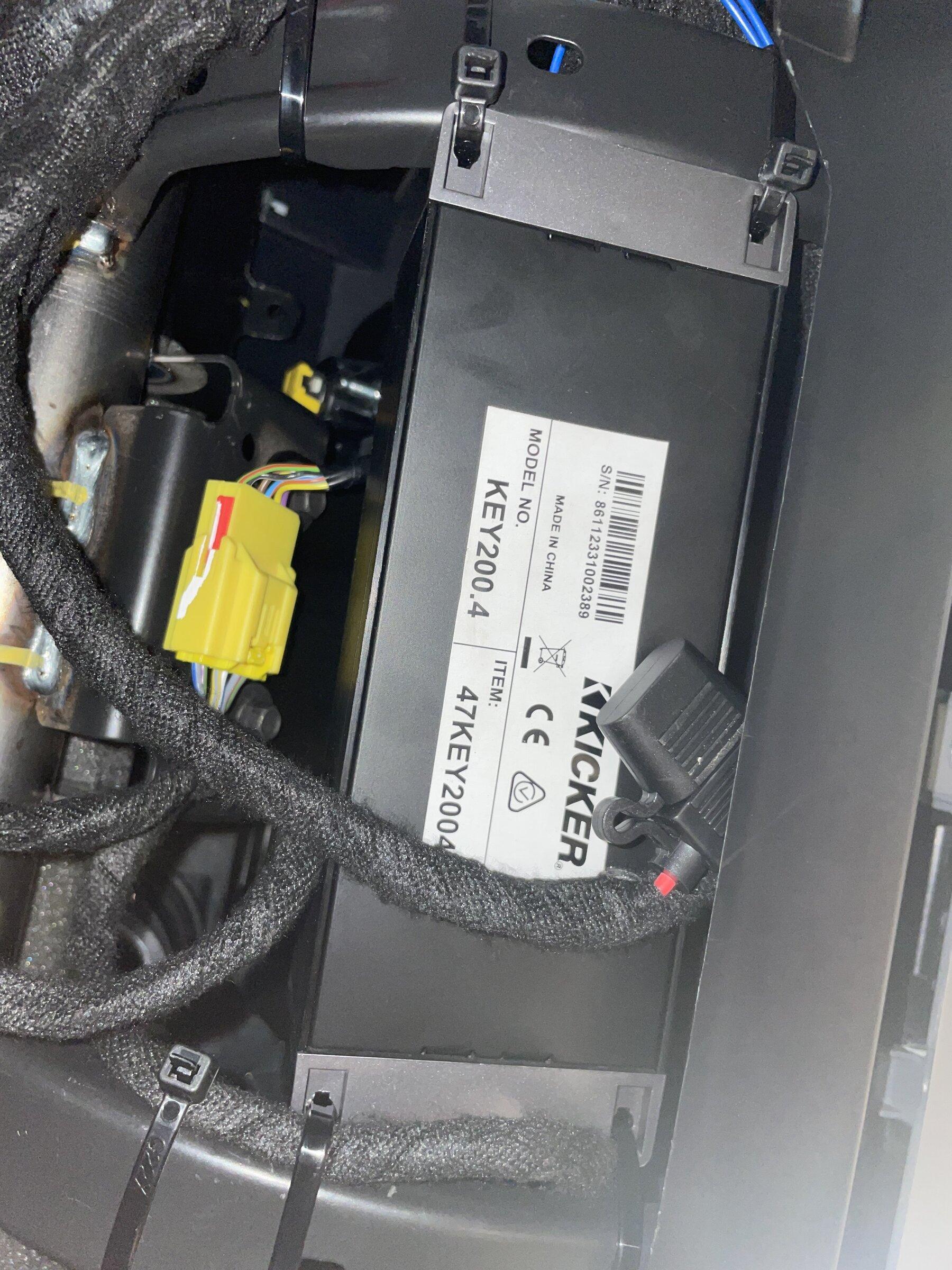

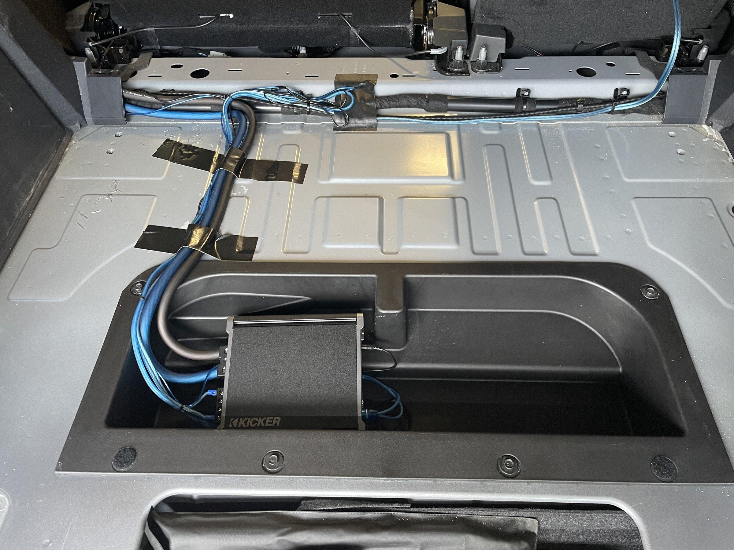

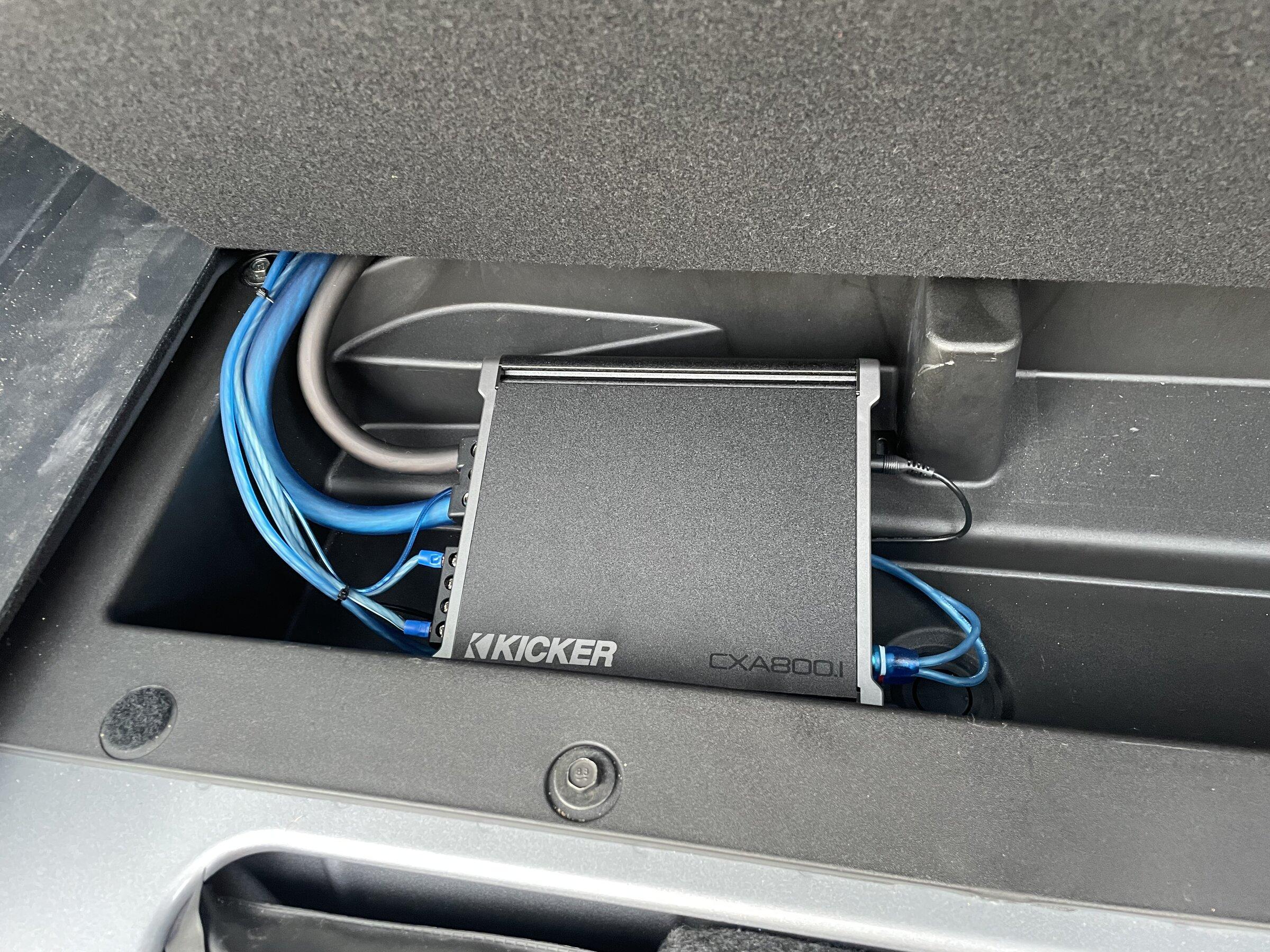

I installed focal RCX speakers all around, the kicker 200.4 (obviously), LCI2, kicker 800.1 amp & bass knob and a loaded kicker L7S. I had to add bass blockers for the dash speakers, other wise they would be "overloaded". I set the 4 channel to 60hertz, I would highly recommend this.
I also used a 100amp breaker in lieu of a fuse, this will make resetting and turning off power much easier. Used Skar 0ga wiring kit for the mono amp.
I mounted the 200.4 behind the glove box, the LCI2 got mounted under the steering column and the mono amp is mounted in the trunk under the compartment.
This is seriously the best audio system I have installed!

Warning that that cubby collects water if you get rain in the car. Where you have the mono amp in the back was half-filled with water after a little rain.
I added a rubber mat from Ford that covers the whole area. But I don't think I'd trust electronics in there.

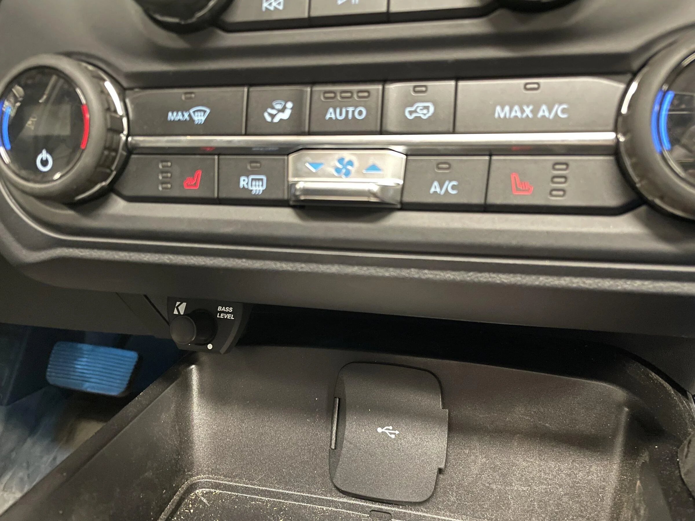

I installed a Kicker Key 200.4 amp in my BaseSquatch today and it made a HUGE difference. It was a straight forward install that took about an hour and a half. The install was made easy because of the harness from plugnplaykits.com. There was no need to cut, splice or drill anything. As you will see in the video below, it litterally was a plug and play operation.
Thank you for the video, I installed Kit 11 on Saturday. I probably should have gone under the steering column but I saw your video and ended up above the glove box. A bit tighter to work in, but doable.
It's certainly more power, but I def need to upgrade the speakers as well. After reading 19 pages it seems like Focal, JL or Kicker are my best options. I'm leaning towards the Kicker KS speakers but I'm all ears for recommendations. Right now the 6 speakers are $300 on Amazon.

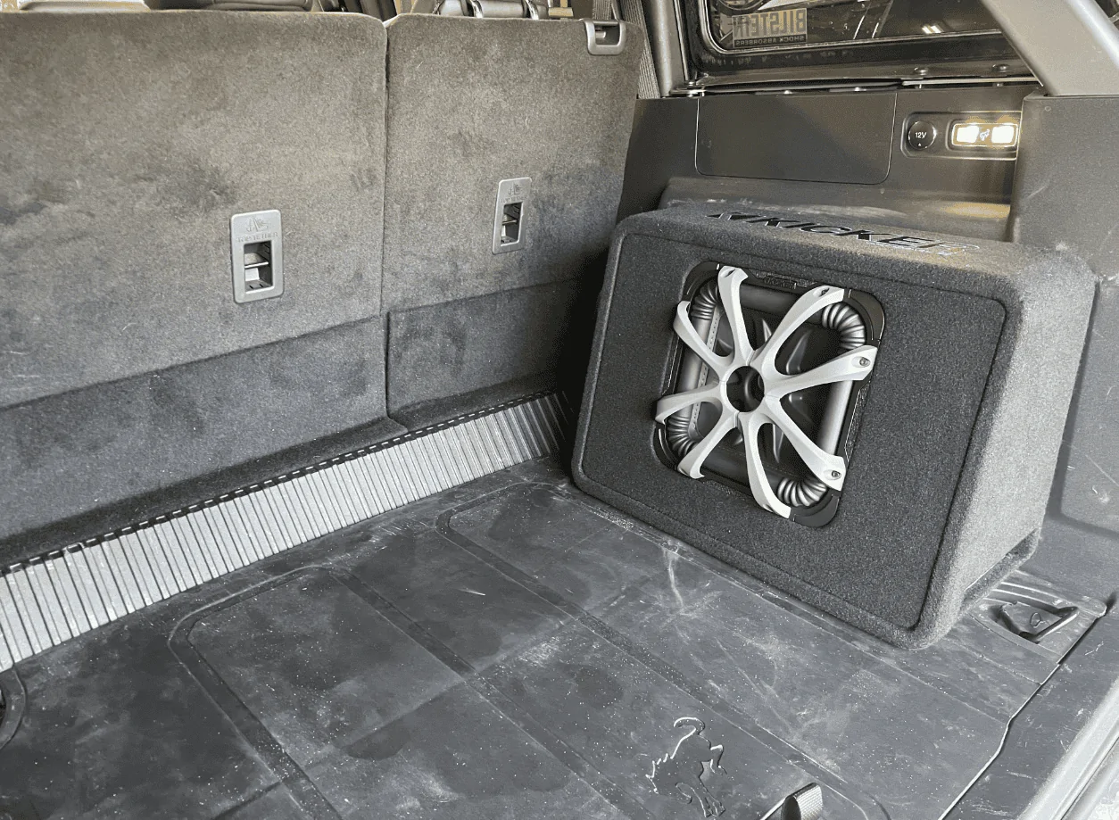

Thanks for the update! Did you secure your subwoofer in the back or is it "unattached"?
Added a ratchet strap to it, the sucker weighs like 60 lbs. It would rip screw out of the plastic panels or floors if I went with that attachment method.
