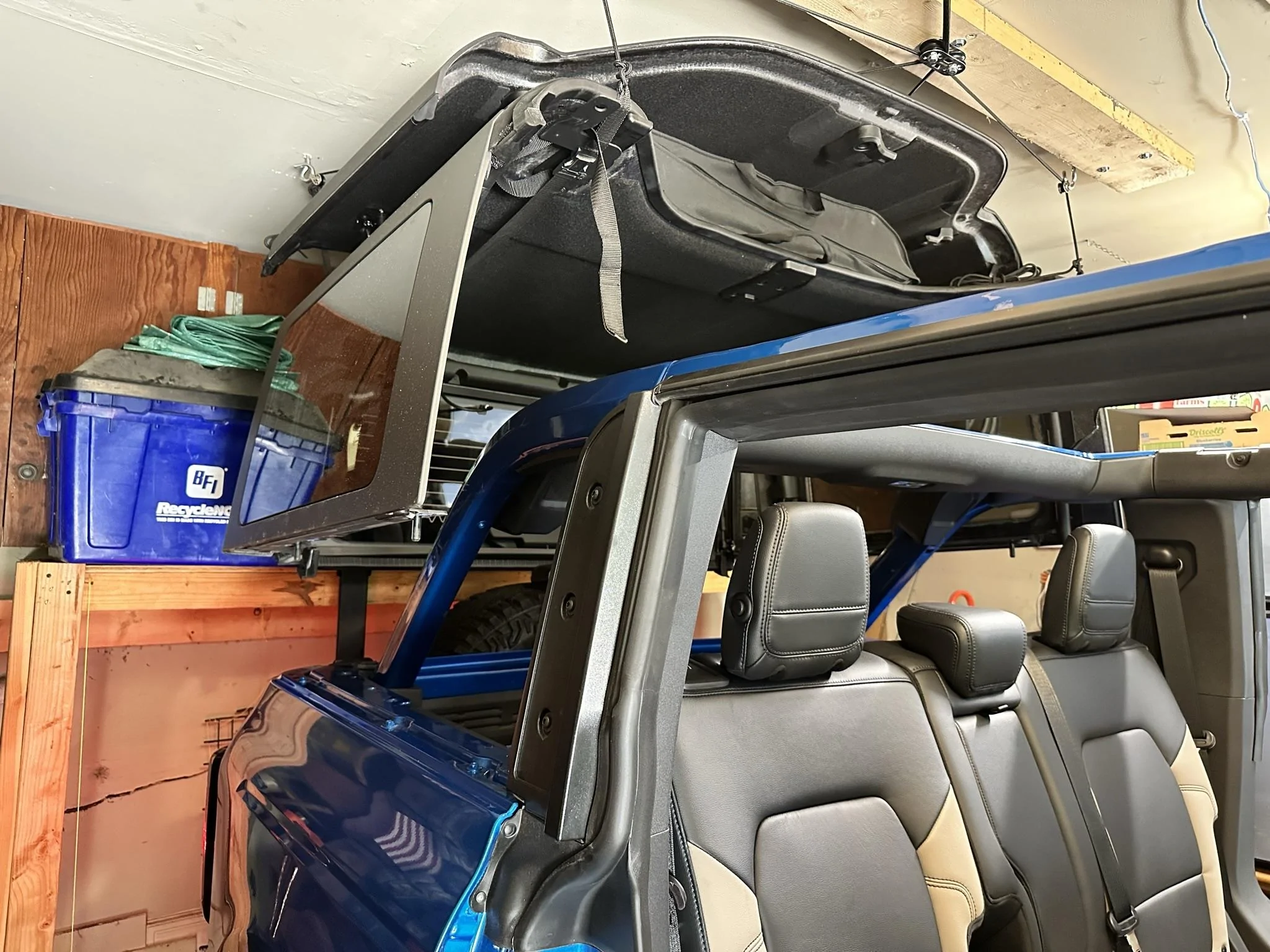

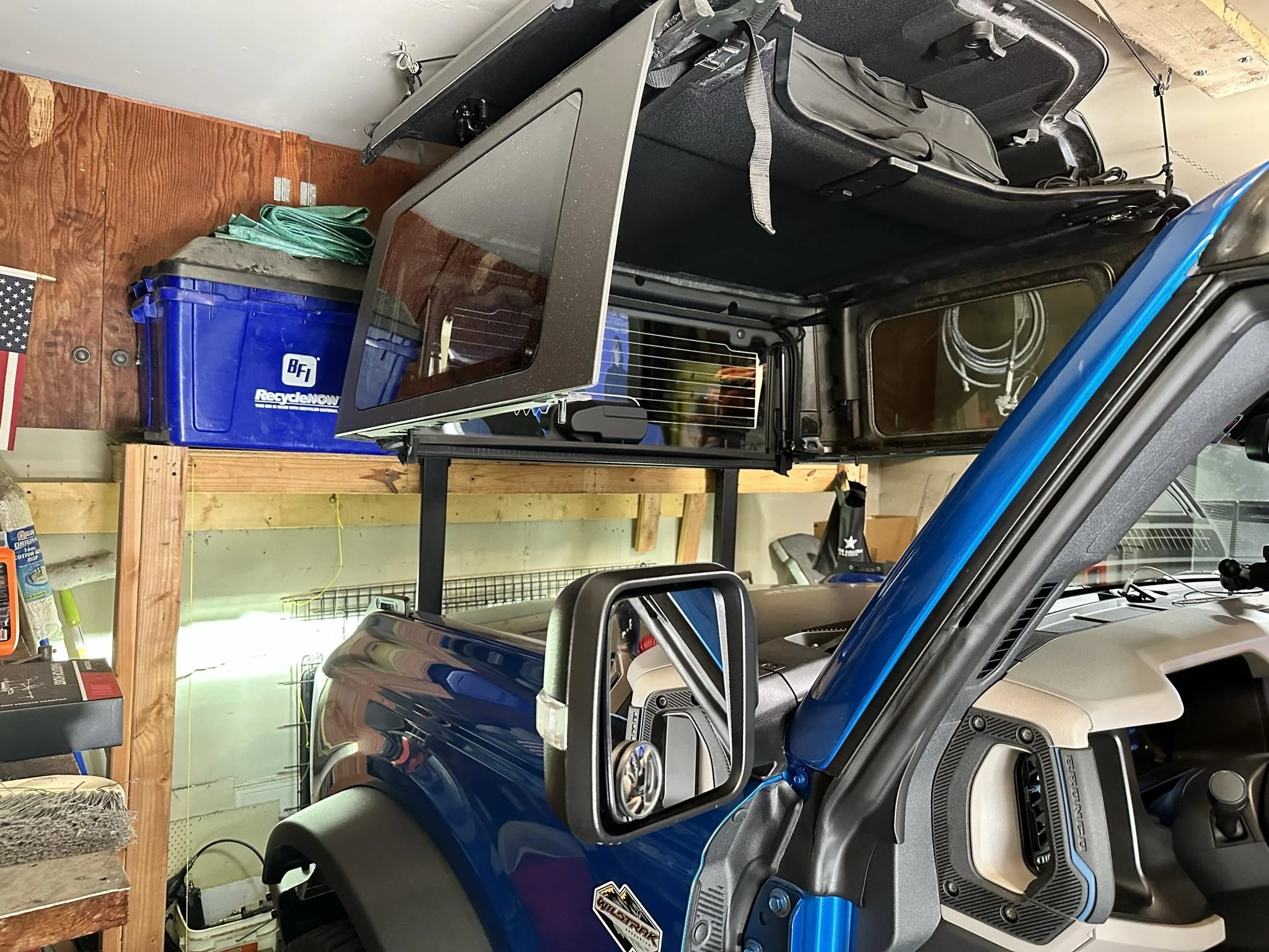

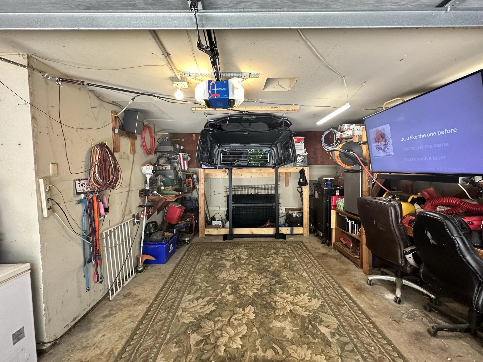

Ford Bronco Just removed hard top for 20th time. Observations & tips IMG_1416
I have some scratches on my roll bar where it rubbed while parking. Looking for some edge molding to prevent that.

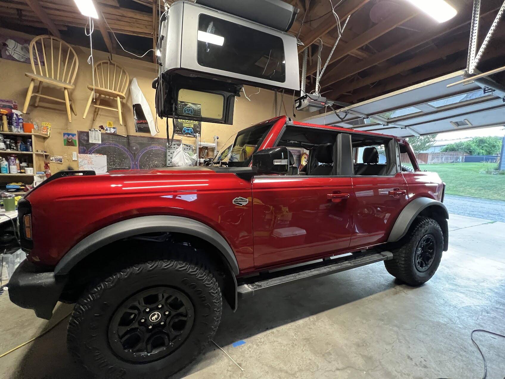

Bought a hoist system for $185 as soon as I got the Bronco and can attest to them being worth it. I put the middle section on top of the rear section then hoist it up. I don't want to overload it too much so the 2 front sections go in the bag and are set aside. Also bought some knock-off RockWorkx toolless fasteners for $62 to replace 8 of the T50 bolts.
Not sure why people say you have to store it with the hatch window up - that just makes it unbalanced on the hoist system. I also removed the guide pins since one of them had caused the fiberglass to crack from the previous owner. Pretty pointless if you ask me.
I put tape on the garage floor so I can back up the Bronco in just the right spot to lower the hard top on. Works great, 1 person job, no strength required.
Now I'm trying to figure out how to get the soft-top platform up on the same hoist system to store it during the winter months. The hoist doesn't go nearly low enough to strap onto the platform so I'm spit-balling other ideas.
