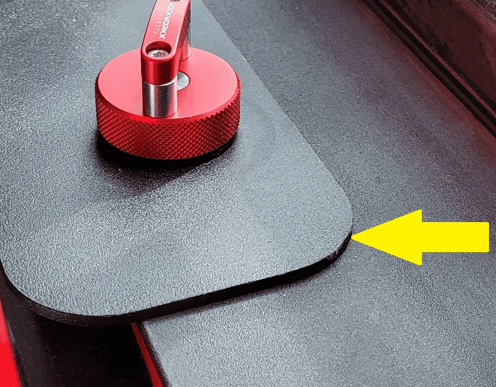

Great tips, one question about the order of the T's - I didn't know their was a prescribed order - driver first, passenger? Which ? Thanks
On the 2-door, the lip/seal on on the drivers side sits over the pass side. But I guess you could sneak the pass side under that if you do in the opposite order.
