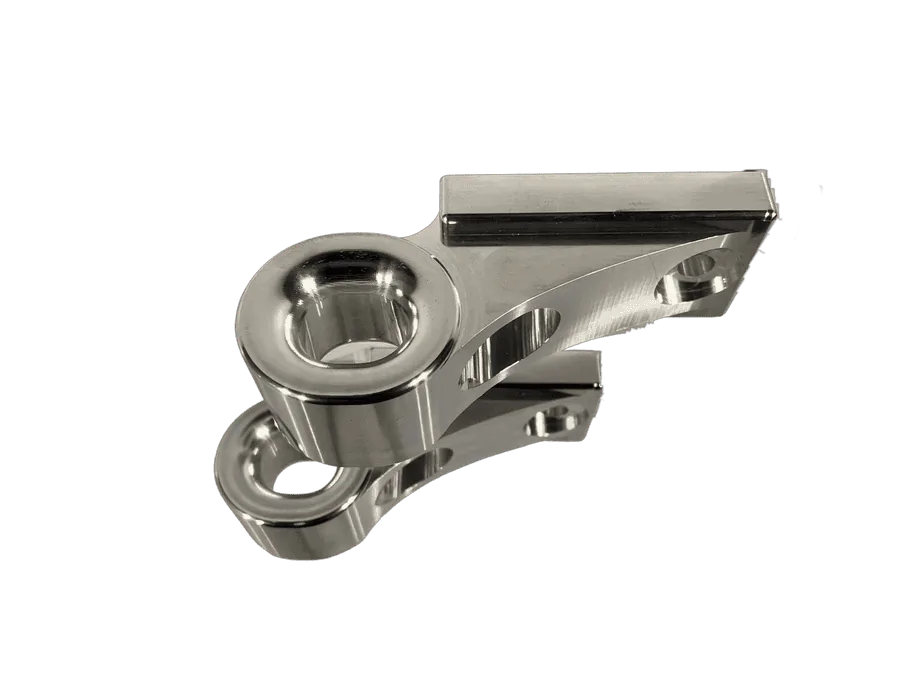

If the concern is recovery points mounted to a lateral frame member, does also make the recovery points welded to aftermarket rear bumpers also suspect? My understanding is that the bumpers themselves are bolted to lateral frame members as opposed to longitudinal frame members.
Also, if the OEM rear recovery points should only be used once, how do you go about beefing up the recovery points so that they can be dependable? Is there a particular product that is recommended? Thanks.
Monster Hook, a sponsor here, makes a solid metal replacement for the OE recovery point on the rear of the Bronco. I just got some, need to bolt them up. They are for designed for soft shackle and bolt directly to the longitudinal frame area.

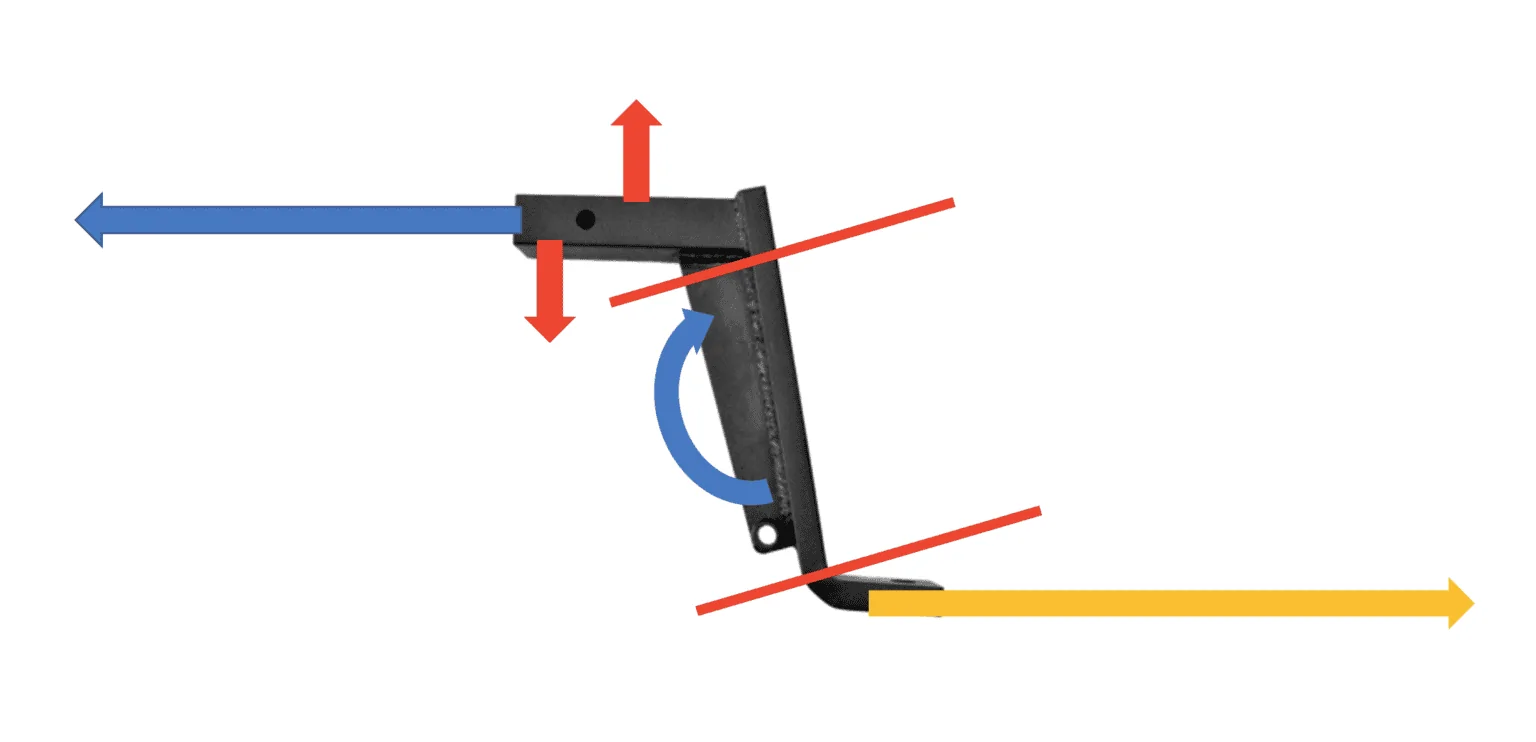

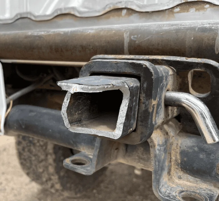

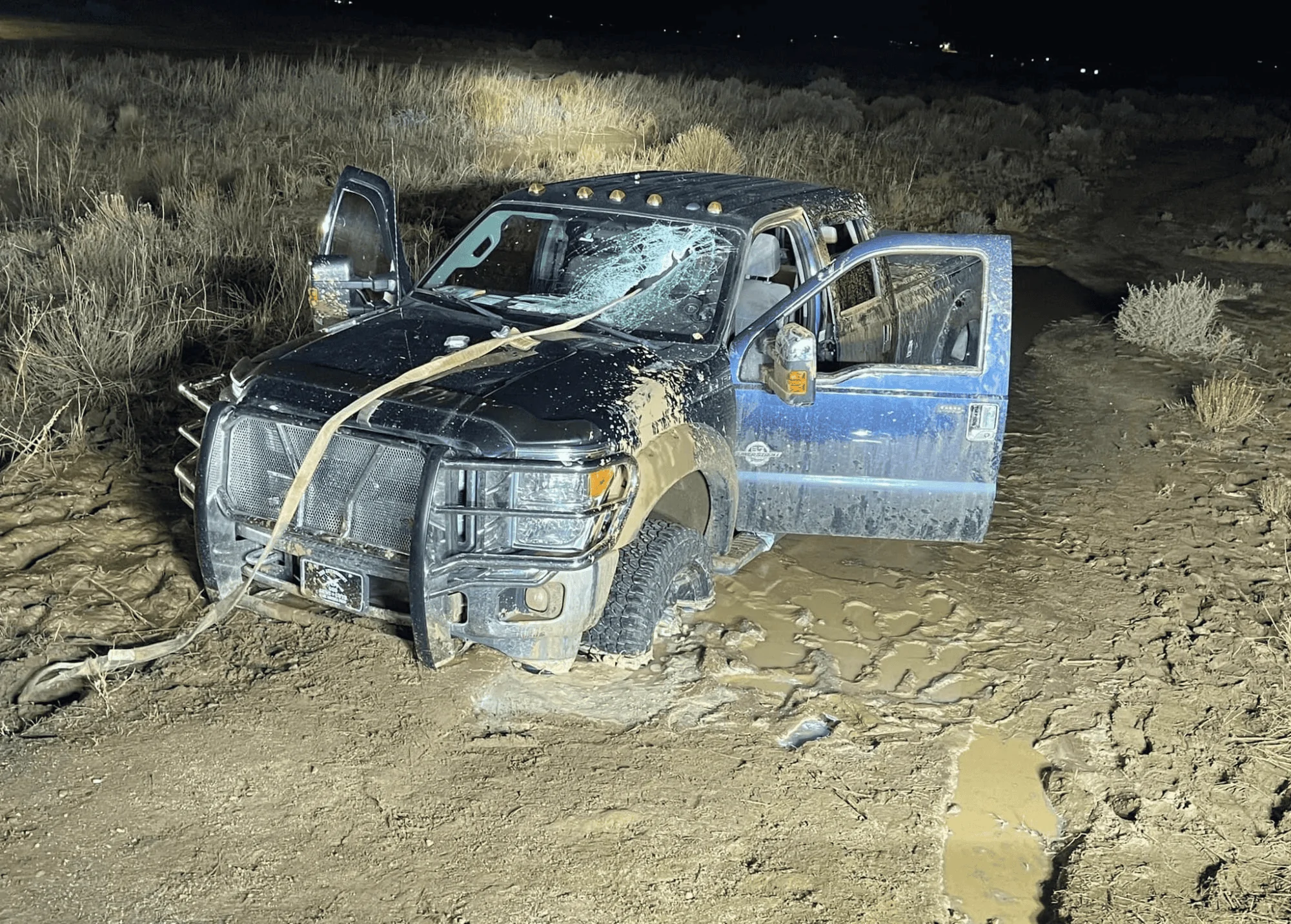

The tow hitch on any vehicle is designed for towing and attaches to a lateral frame member. The forces incurred in towing is different than that of a snatch to overcome a vehicle stuck (mud having the greatest suction force to overcome). You want the force used in such a recovery to be applied to a recovery point that is a part of the longitudinal frame member.
It was just a week ago that a recovery went wrong at the Ol' Florida offroad park. Landcruiser was stuck and recovery was attempted from the tow hitch. In a split second, the entire hitch carrier was torn off the LC and sling-shot into the rear gate of the recovery vehicle. People standing around in the kill zone unknowing the danger that they exposed themselves and their loved one too. In that split second, the carrier could have easily killed them.
The hitch is as reinforced as the front recovery hooks. Hell, most aftermarket bumpers attach the the same points that secure the actual hitch. I have not had this bumper off, but the Tacoma uses the same 4 bolts for the hitch and aftermarket bumpers. The factory bumper only secures to the hitch itself. The pic above wasn't a hitch failure, it was a mounting point failure and I'd be interested to see that up close. There is always danger in recovery. I have no issues using a good hitch mount recovery point.

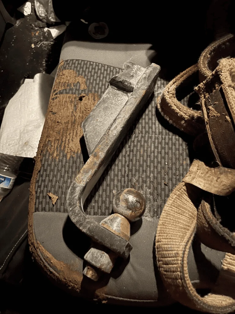

https://l2sfbc.com/drop-hitch-failure-leads-to-death-during-4x4-recovery/
Some good reading. ^^^^
This is the hitch type failure that most are reffering to, as well as the incidents where the ball shears off and gets sling shotted into somebody's face at 200mph.

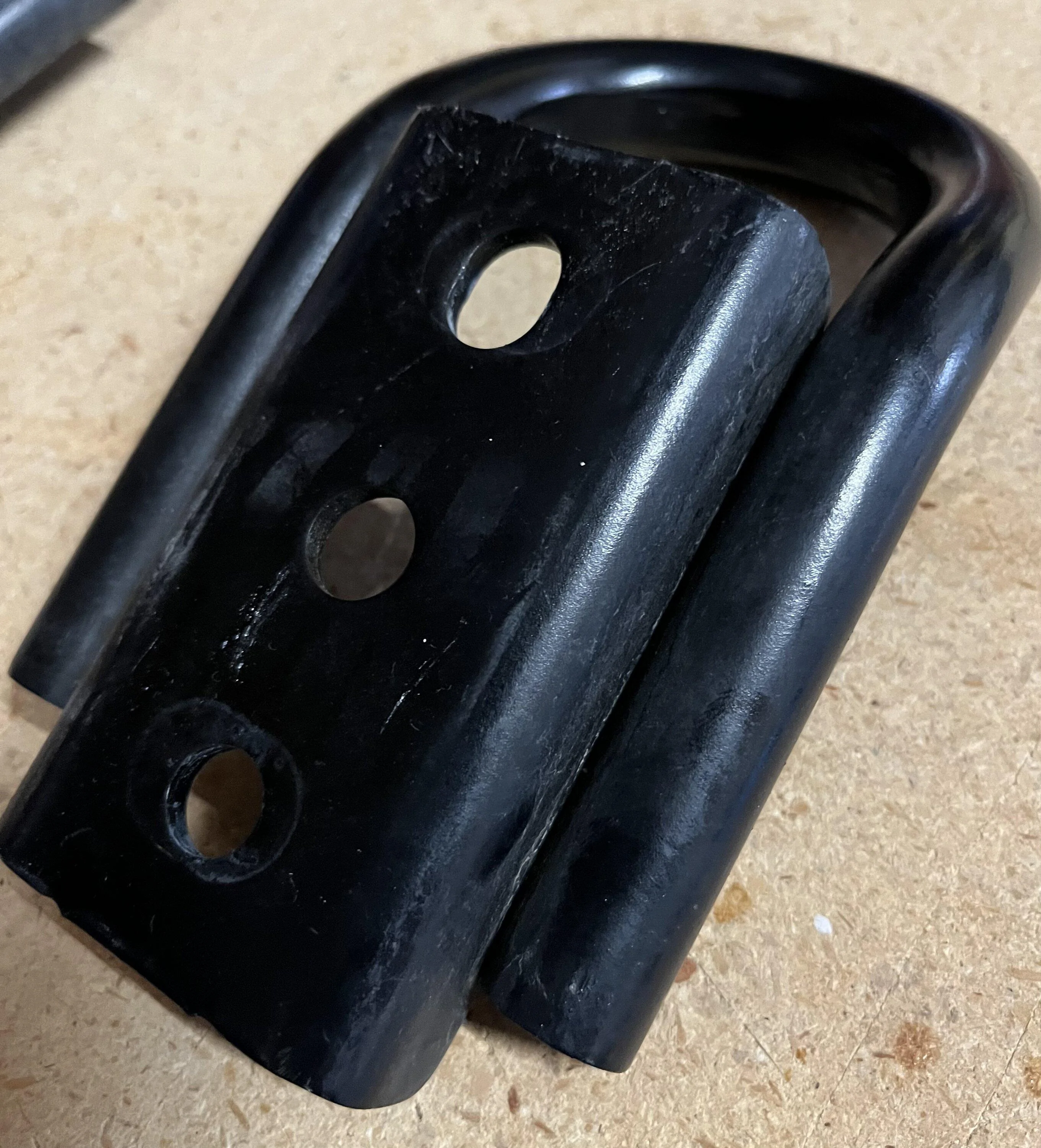

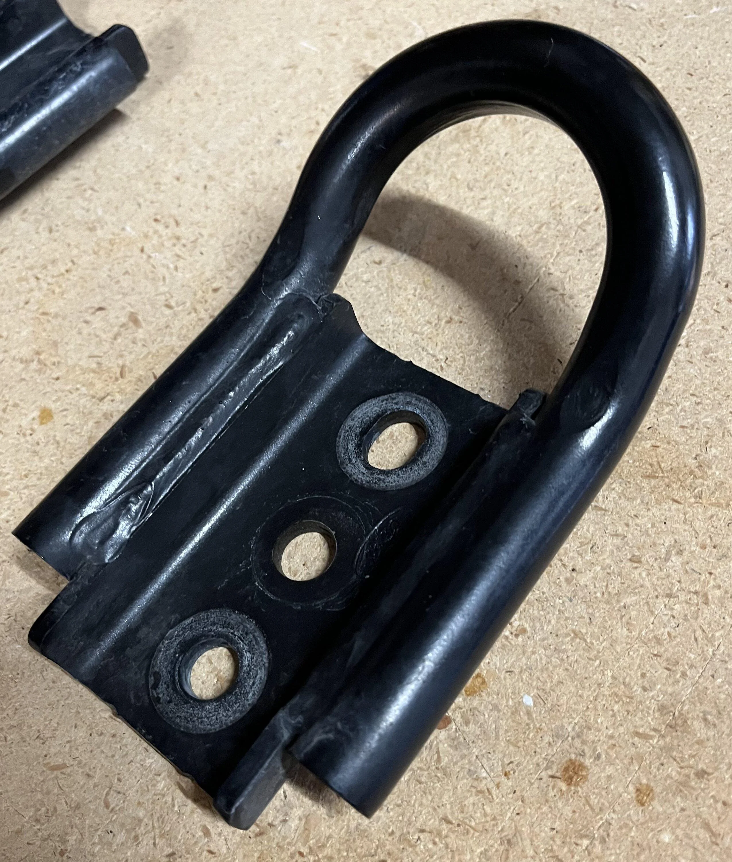

Fords 2 piece recovery point isn’t even completely welded. Just on the side you can see. Not sure how much you should trust that.
Ford Bronco Just put this shackle on IMG_0218
Ford Bronco Just put this shackle on IMG_0217
fourdayoff
Apr 28, 2023
138
145
Boulder City Nv
2022 Bronco Badlands/sasquatch 2.7
JR, thank you for the pics. I will be welding the backside. Jim.
I'm guessing that Ford doesn't publish the weight ratings on any of the recovery points?

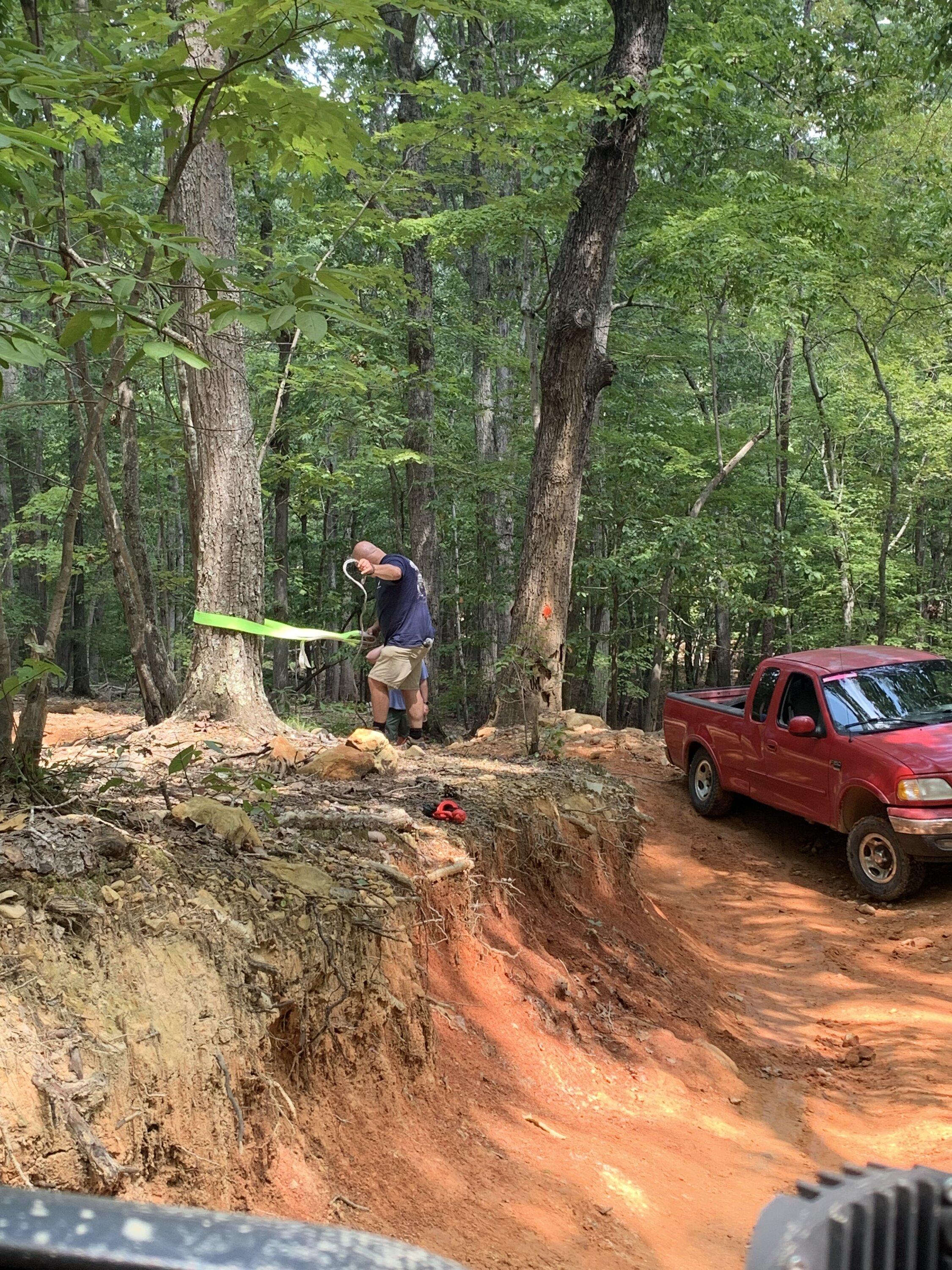

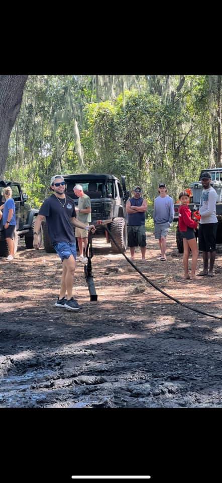

I was not the best example for a lot of the new people with me, as I did not have a damper on the line, and at one point I placed myself in the danger zone.
We all can learn a bit more.
Isn't a line damper preferred but not required for a synthetic line?
There is no rating on the factory recovery loops.
Not required but a few reasons why I should have:
1) Most of that group were very green. If I'm being watched and people taking notes on how to do things, as a responsible "teacher" I should show them the right way. If they don't see a damper used and ask "what is that for?" They may not even know about them or when needed...If one of that group gets a steel cabled winch and is unaware of what a damper does... Boils down to being a good role model. Show people the correct way if you are in that position of others watching what you do and how you do it.
2) granted a synthetic line should/would just snap and fall to the ground if the failure is the line itself between the two vehicles/tree/etc. However, if the failure is the shackle or recovery point at the end, technically it could still whip back and basically be a projectile due to the energy/force.
Probably best case to be more safe than sorry. And regardless, I should not have been so caught up in getting it done I was not a good teacher to those watching me.
It didn't even dawn on me until I watched the videos and pics of the recovery back at home.
