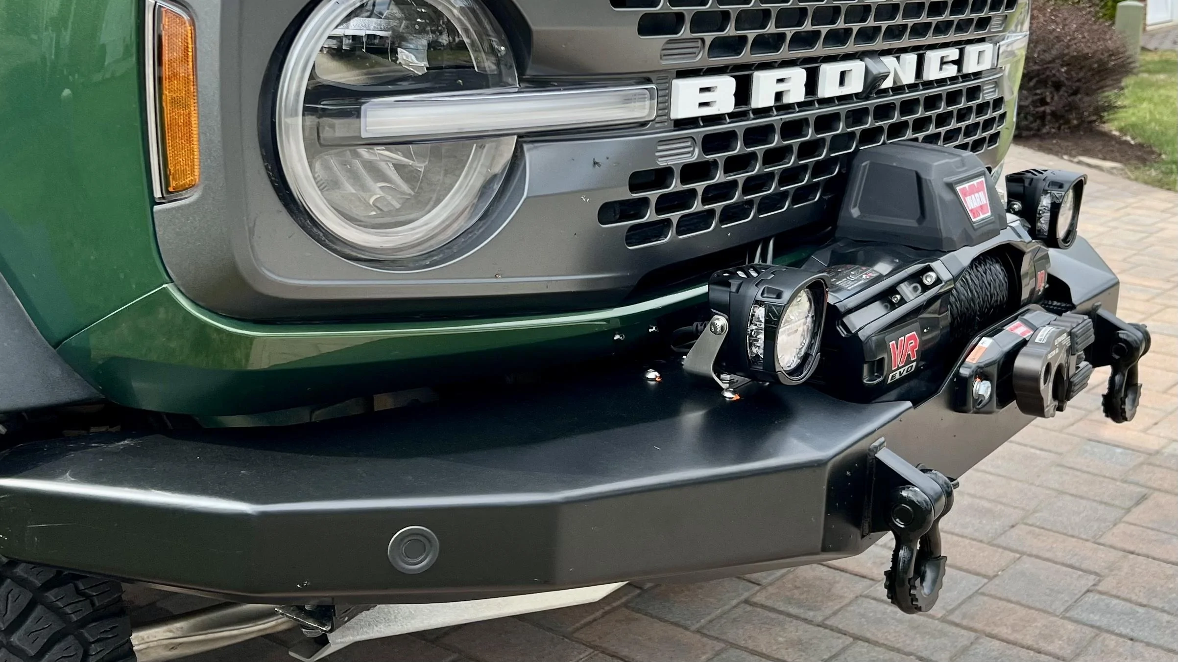

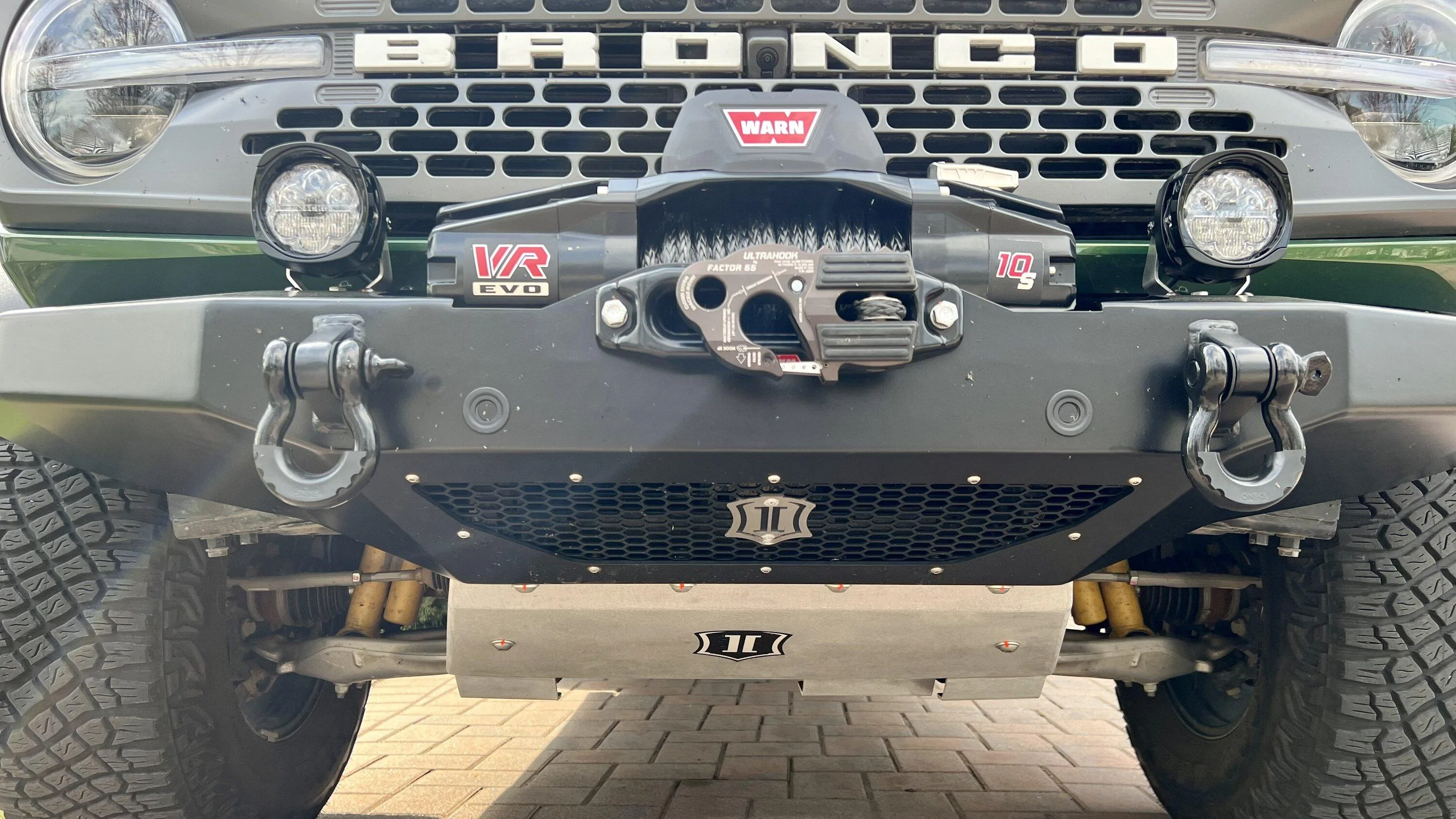

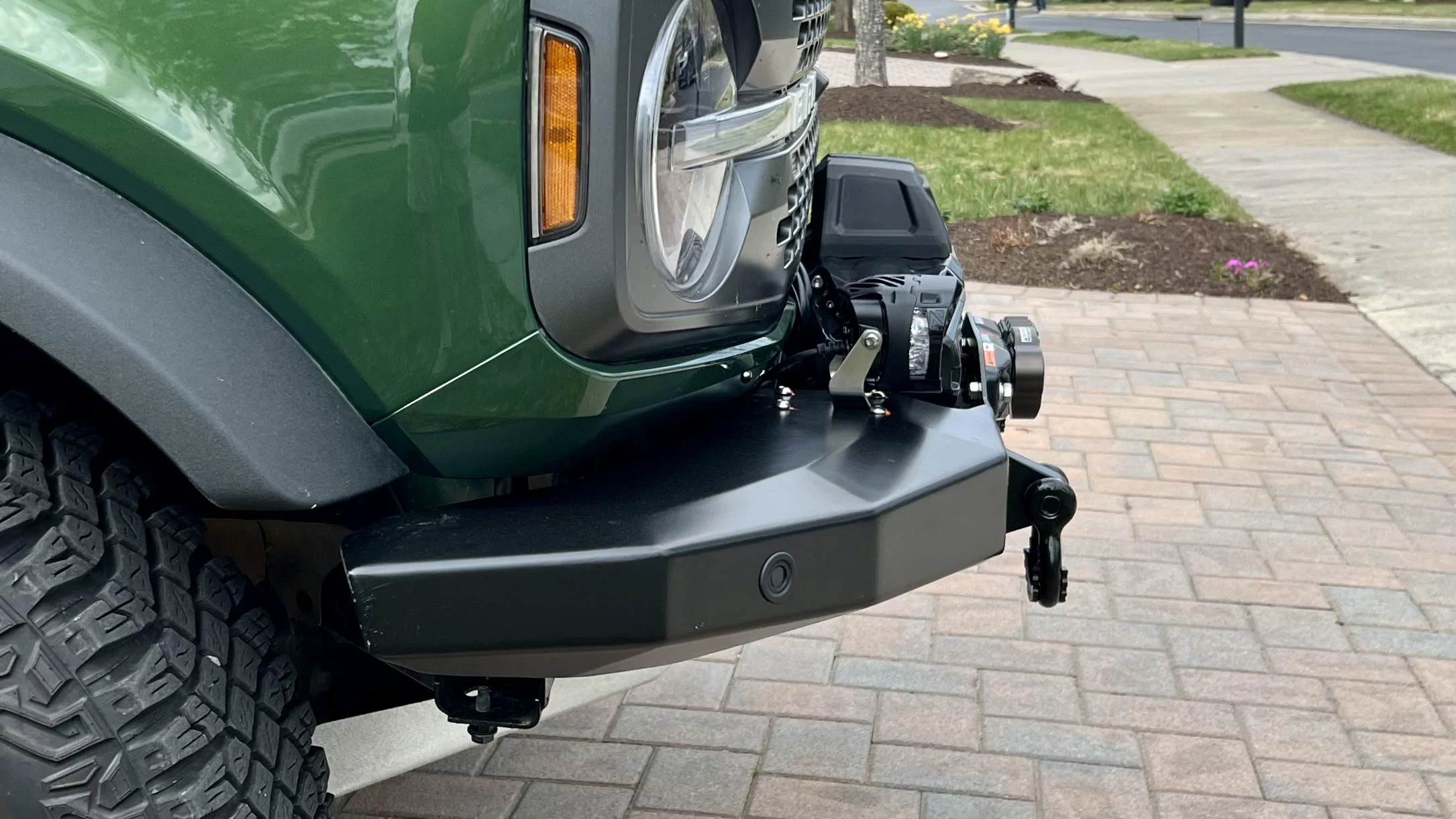

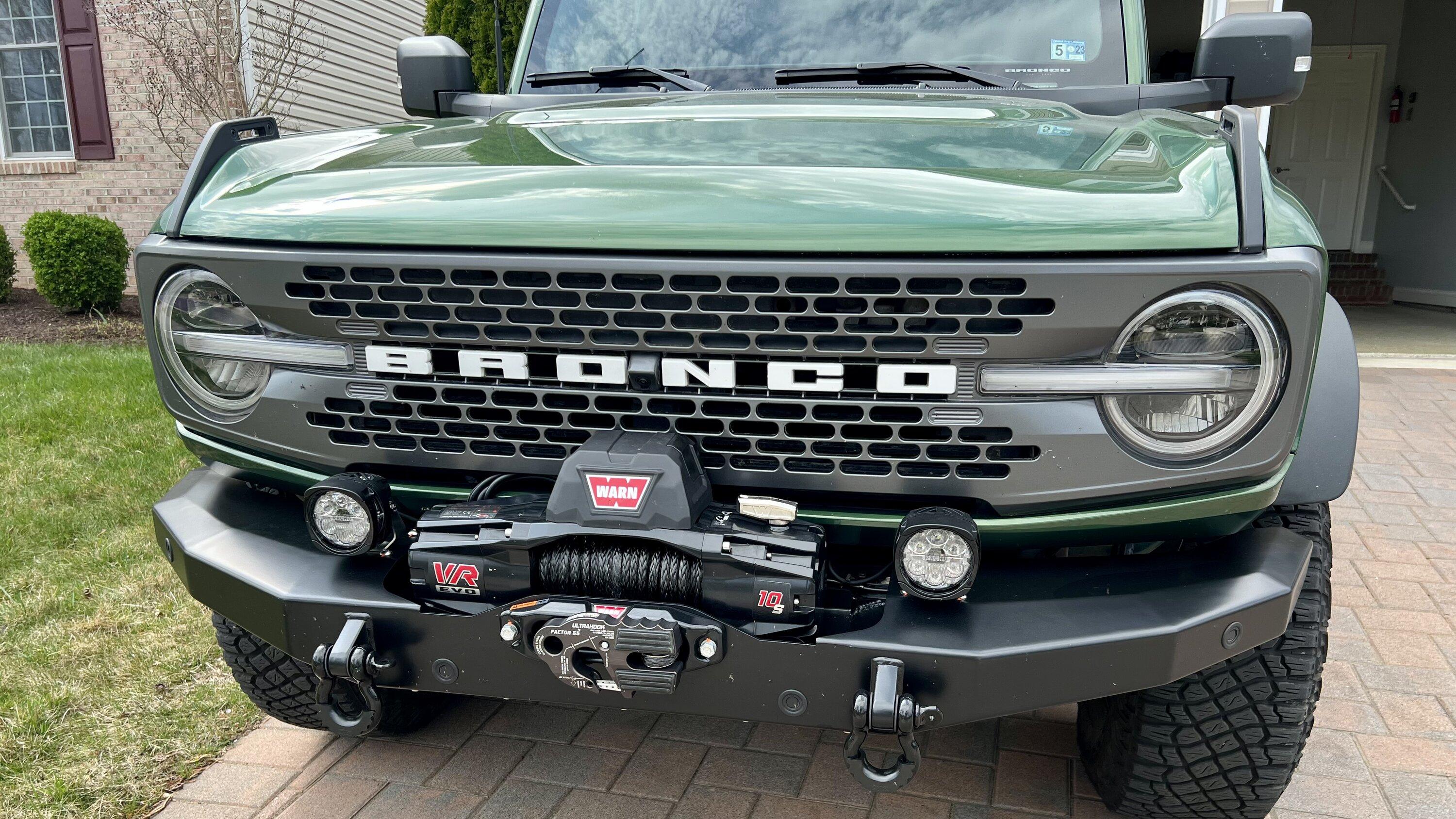

Cursed with the capable bumper and 2.7 (no real hidden winch options), it's time to look into winch mount bumpers. Searched every winch/bumper thread to no avail. Anyone care to share their setup?
Chose Icon bumper and skid plate after an extensive search. Reasons,
- Tight clean install, and very well made.
- Retains great approach angle, with easy access to cable, unlike the under bumper options.
- Retains airflow to the intercooler via screen in lower bumper.
- Considered BAMF but did not want to relocate control pack, and the winch appears to be inaccessible after install with BAMF.
Downside
- Blocks part of the camera…but not enough to be of a concern to me. The camera is still trail useable, not that I ever really use it.

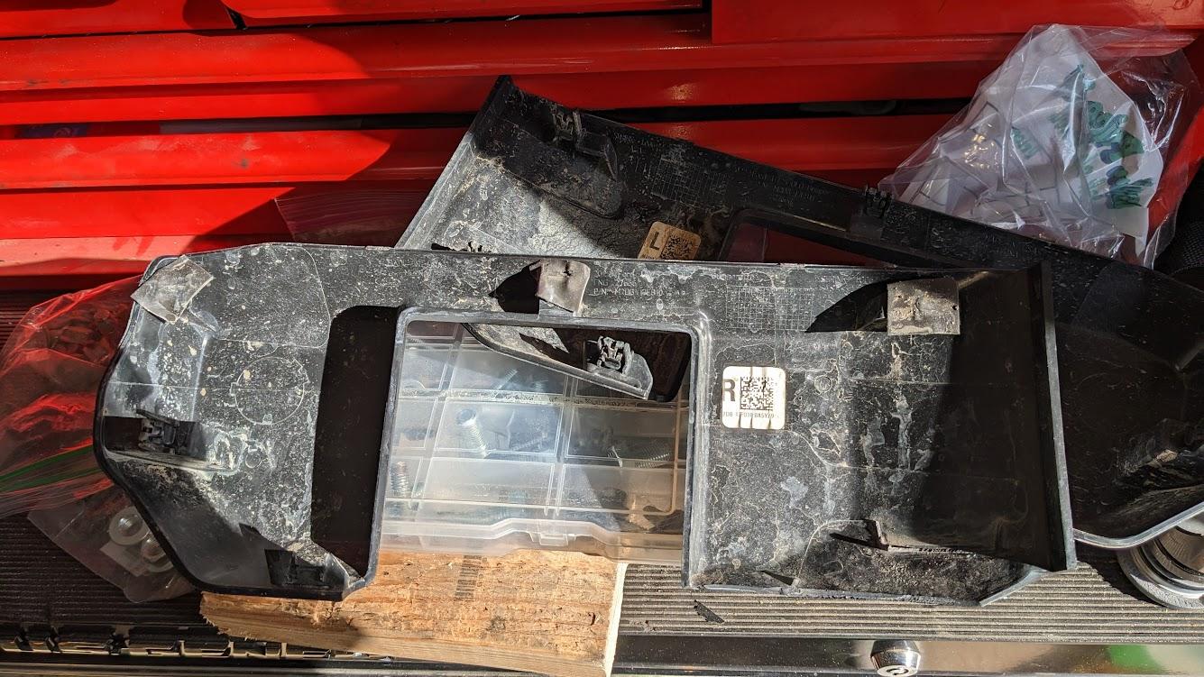

I would recommend a full bumper replacement over a just a winch mount. I have officially broken both my from plastic covers on my capable bumper from snow wheeling. These are $50 a piece online. Capable bumper is not that much of an upgrade over the plastic one I had on my Big Bend.
