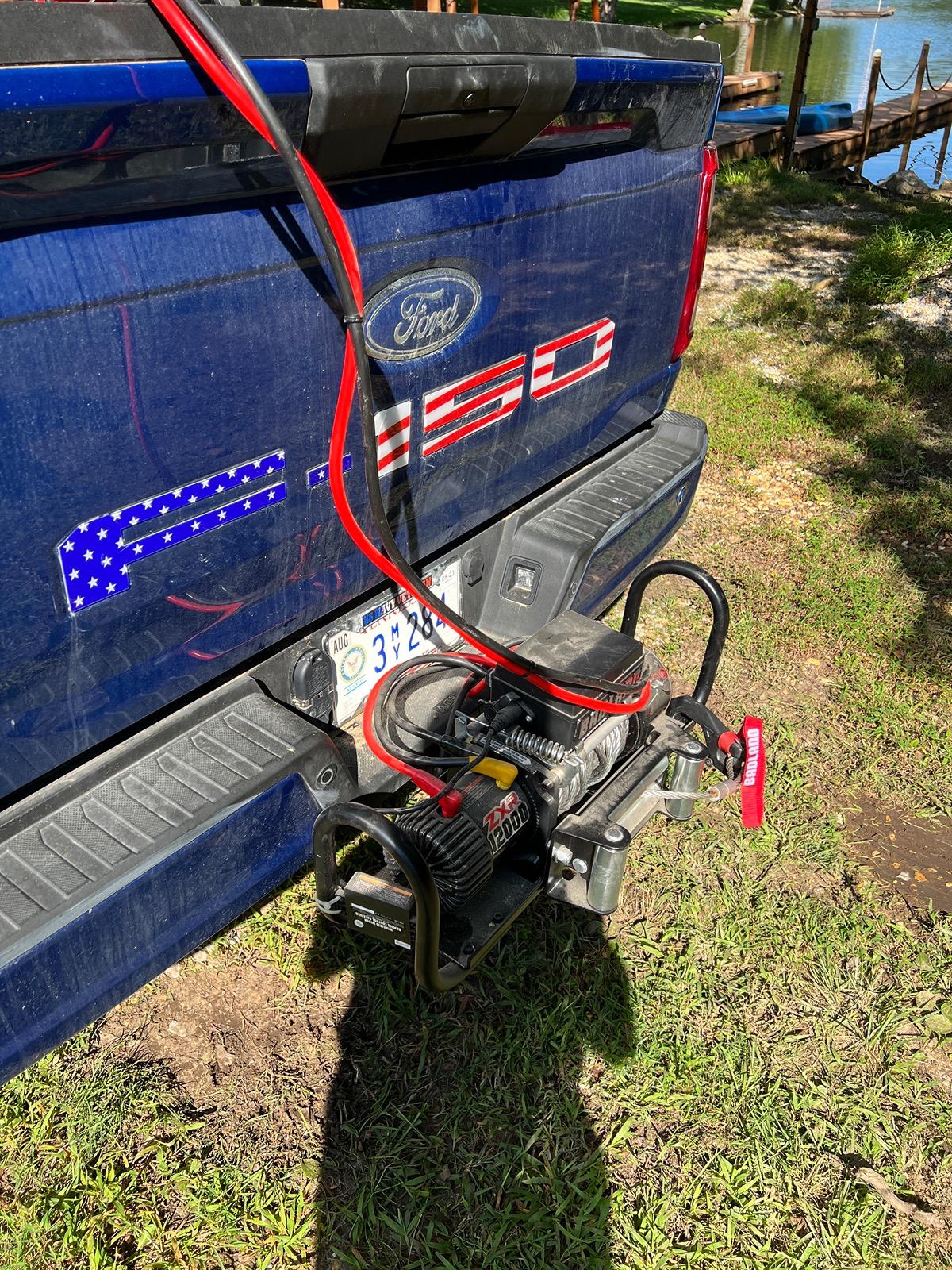

I have a Badlands 12K winch that came with the steel braid line. I replaced it with synthetic rope last year when I had enough of the steel. I use it on a trailer hitch plate that I attach to the receiver on the back of my truck to pull stumps and bushes etc.
The steel braid was thin enough to go through a hole in the winch drum, then a lock down screw held it in place. When I got the synthetic rope it would not fit through the hole. I put a magic marker line on the rope about a foot away from the end. I then pulled strands out until it would fit through the hole. I put heat shrink on it and installed it.
When pulling the strands make sure you do every other one, to a bunch of them in a row.
Not sure of how Warn attaches to the drum but keep this in mind when replacing.

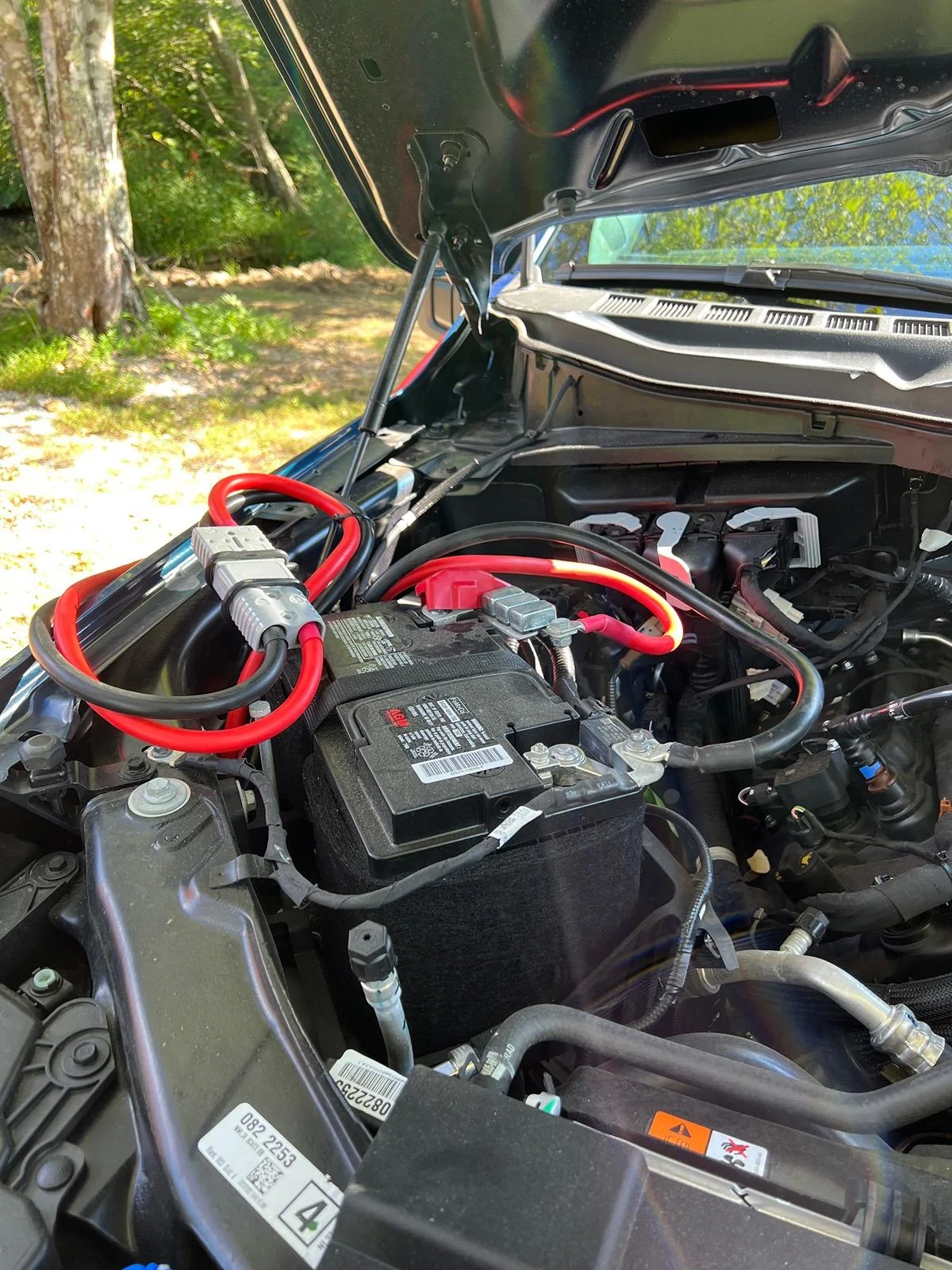

I used the Harbor Freight trailer hitch plate. It has held up very well with my use. I sort of cheated on the cable. I bought jumper cables from Amazon and cut one end off and installed the Anderson 250 amp plug. Jumper cables.
Ford Bronco Synthetic winch rope recommendations IMG_4479
Then I cut off I put another Anderson plug on so I could use them as jumpers also. I have the same connections on my truck and Bronco so I can just carry the jumper cable end or use the winch with either one.
