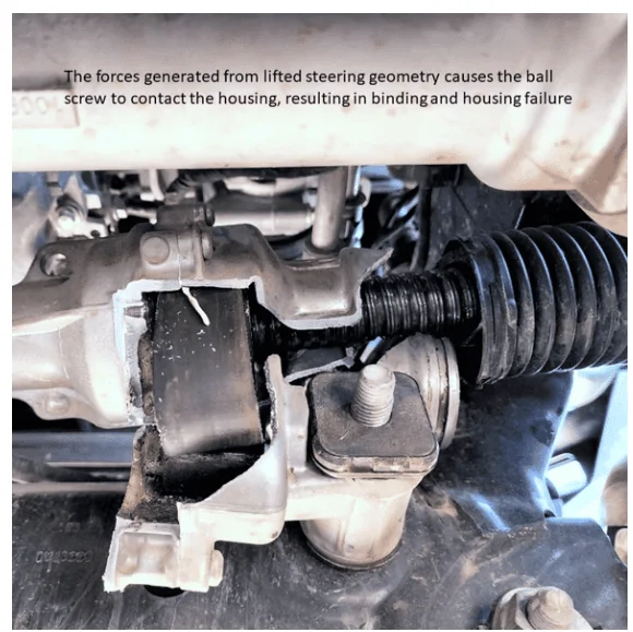

One theory held by very few people since no one can point to this happening with any bronco out there. Plenty are running 37s and even 40s and this hasn’t happened yet.
did this not happen to BroncBuster, leading him to CNC that new rack?

Not defending BroncoBuster guy but this is what he has posted on his site.
https://broncbustertx.com/
The inner will pull down on the black "threaded" part causing wear and eventually binding on the racks housing.
Thats why the WT 3.0 and Braptors have a much beefier housing. To alleiviate probems with folks like BB running masive wheel offsets that cause extra leverage on the rack, especially with 40 inch tires, and an ego to oversell overpriced junk bandaid parts.

so reading though all this, let me get this right. replacing the stock tie rod ends with these icon tie rods the consensuses is that the steering rack will be the weak point then? Is this just a theory or proven?
The standard answer for any part on your 4x4 - When you beef up a weak link, it passes the loading on to other parts.
On our Broncos... Beef the tie rod up, it will be passing that load into the steering rack.
The question is: Will the steering rack hold up to the extra load coming into it or will it break.
