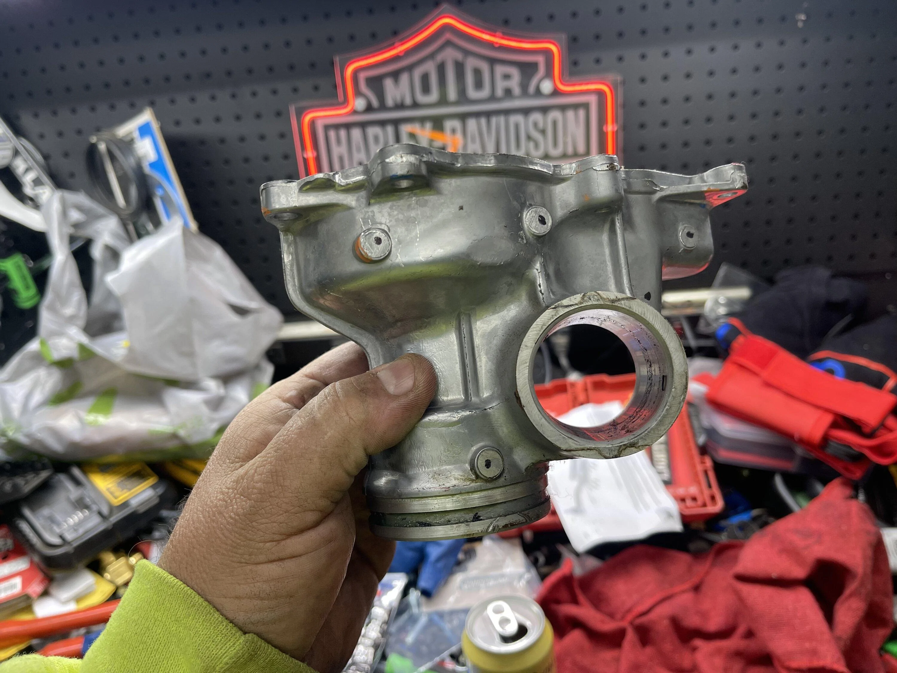

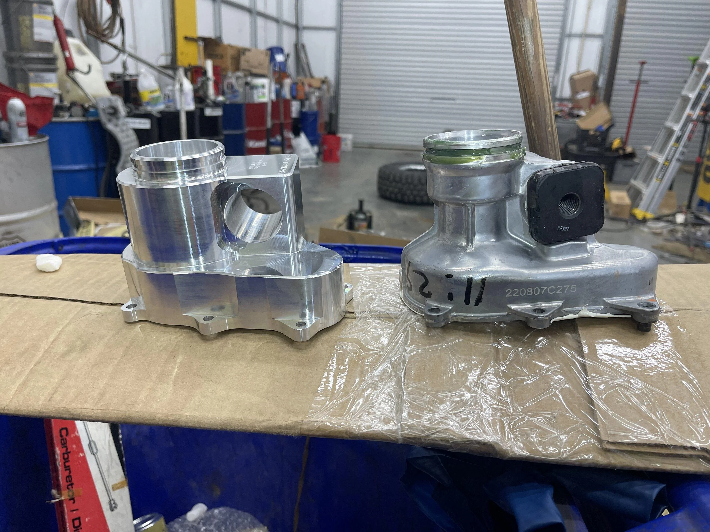

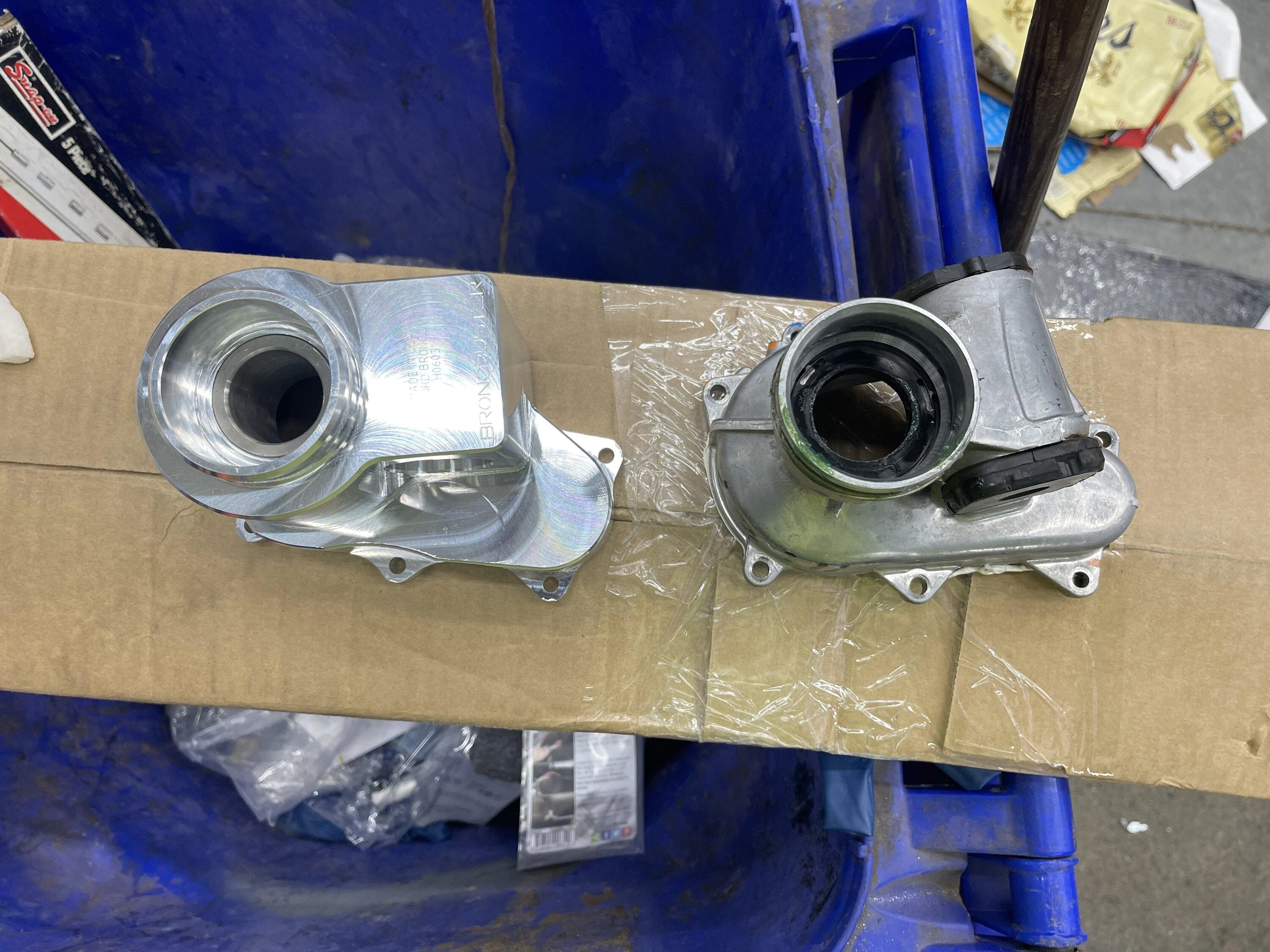

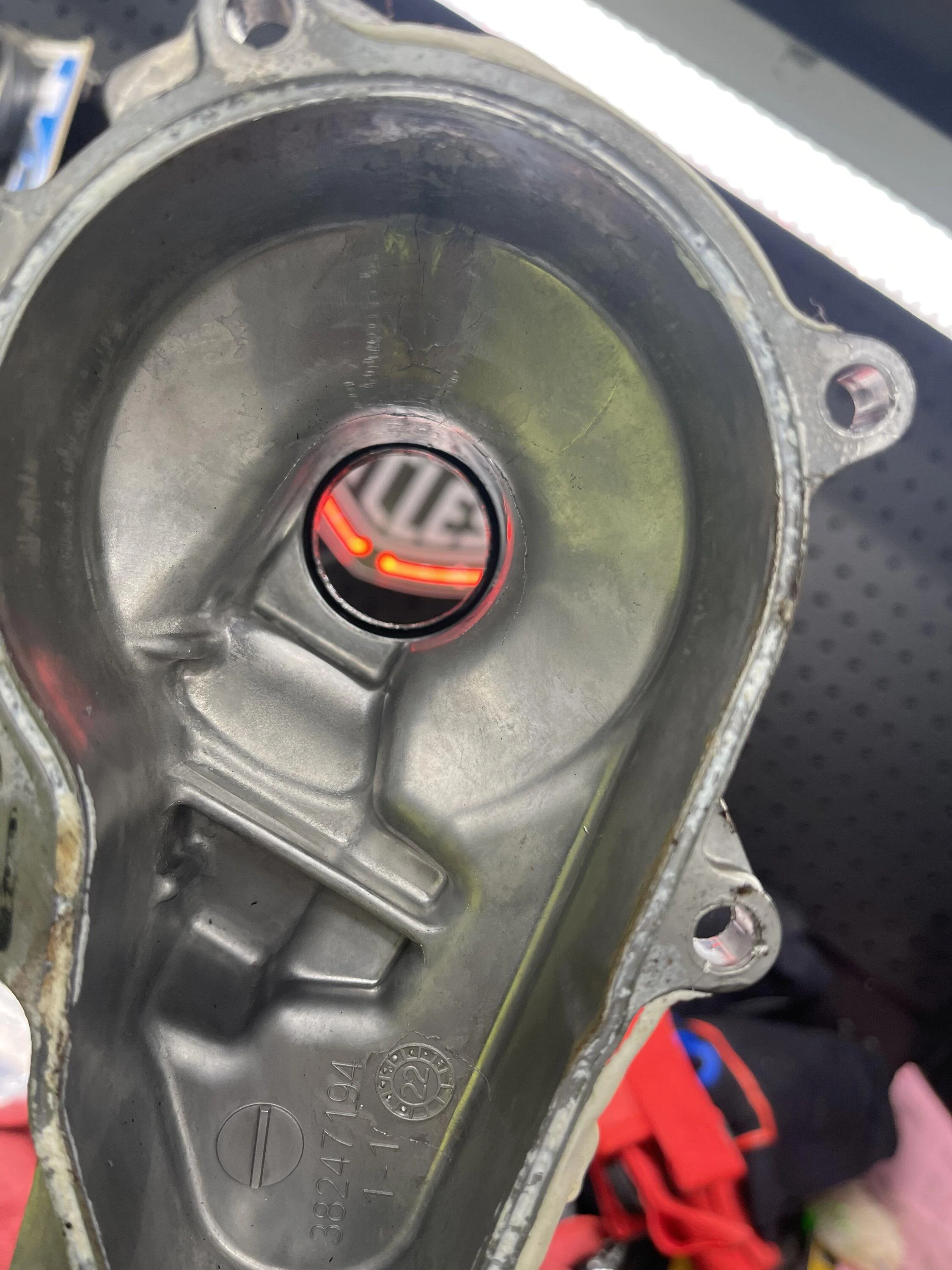

Sorry I should have been clearer the end cap of the rack was showing signs of wear. Attached are a few pics of mine. Inside the end cap of the rack there is only a seal. No real support In my opinion. The tie rod operating angles on a lifted Sas will transmit a bunch of force into the rack. If you beef up tie tie rods and do not address the rack you will be sorry. That said I’m impatiently waiting to buy these tie rods
