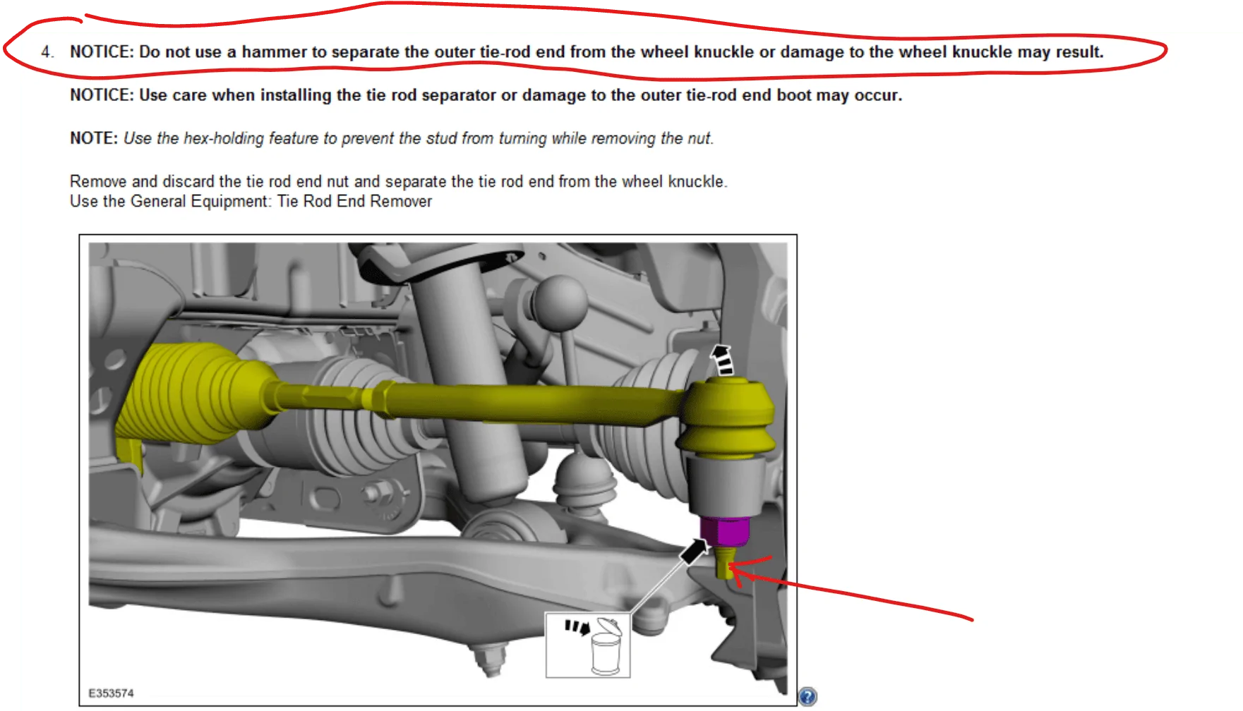

That was me. I used a screw style separator and even then it took some serious turns before it finally popped. That was also after beating the heck out of it with a regular hammer followed by a 3lb sledge. The passenger side popped out on it's own 🤷‍♂️
Same here. Mine are very tight when torqued to 46lb-ft. A hammer won't do anything except mushroom the stud end.
Ford warns against using a hammer for the tie rod or uca joint to avoid breaking the cast knuckle. Threaded tie rod separator is the safest option, and sometimes the only thing that will work.

You never hit the stud with the hammer. Basic mechanics.
Hitting the side of the knuckle works although it has some small risk.

You don't hammer the stud. It's a tapered end. You hit the knuckle and the force should cause the end to pop out. And the line right below what you circled they mention that using a picklefork can (will, in my experience) damage the outer TRE boot. Fine if you're not reusing it, but if you're only planning on replacing the inner, I wouldn't recommend it.

And...that's why you RTFM. I wish I'd read that before hammering the sh%t out of mine 🤣. On the plus side I now have a threaded tie rod separator and experience detaching them.
