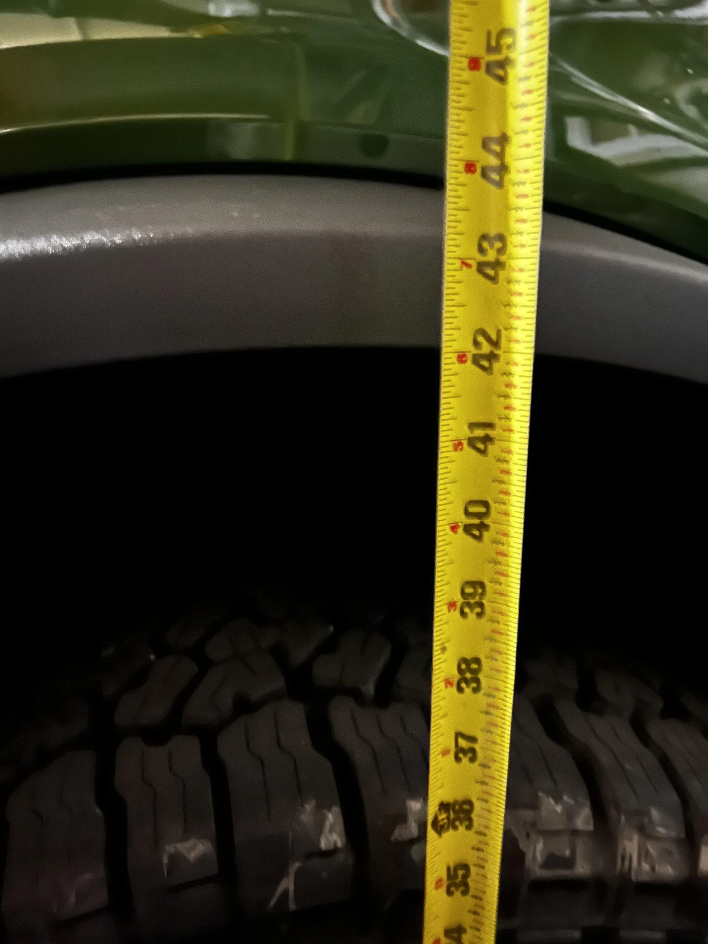

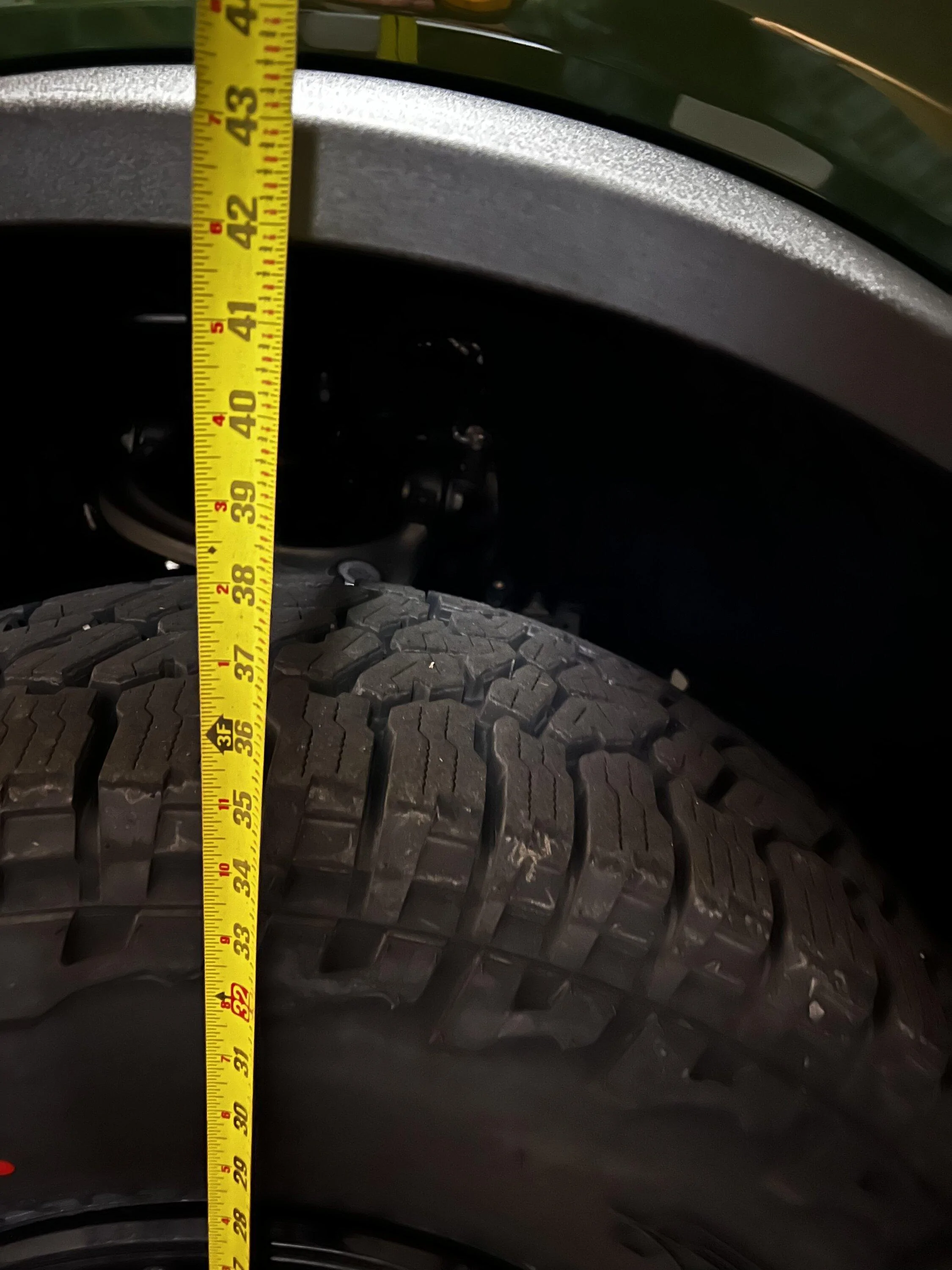

So some final measurements for consideration. I went with Falken AT3w’s in 37x12.5r17 on OE Wildtrak wheels (which I like).
A few thoughts first. I can honestly say that these 37s are smoother riding than the OE GYs. I can feel the difference but general power is not tremendously impacted. These Falkens are great on road. And look far better in person than on the inter web.
I can say that the overall ride quality between the RPG collars and the new tiresis very close to stock. Just a touch stuffer but not in a bad way.
I’m using 1.4” wheel spacers and between those and then collars I am clearing the tires well at full lock and the spare still fit (BARLEY) under the rear taillight.
I’ll plan on adding one of the tailgate reinforcement options (likely the RC due to price and basic functionality).
Final measurements are 42” at the wheel wells, front and rear, with staring measurements at 38.5” front/ 39.25” rear.
Alignment is scheduled for Wednesday next week. I will get some decent pics before and after posted up tomorrow. I will also try to get those secondary droop measurements sometime this week.

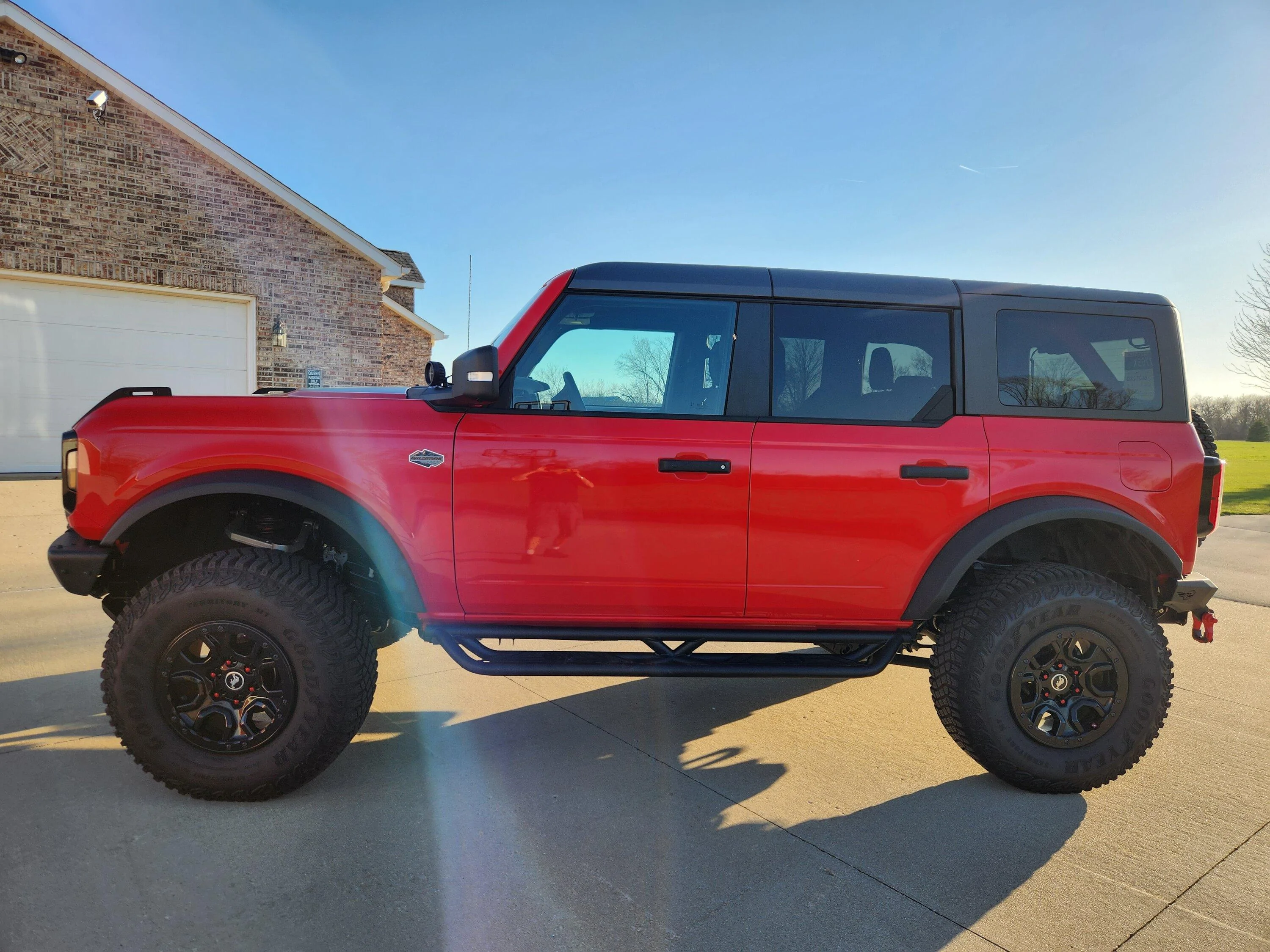

Lift is on and he said everything worked fine. He thinks it looks and rides great and so do I. Actually gained about 3 1/2" in front and back is level. Getting alignment on Friday morning, but drives really nice. Love the look. 😊

Sorry, didn't mean for 3 pictures. Lol Also, it's sitting on a upward incline here.🫤

Nice work! Looks good. Maybe my measurements are a bit off? That’s too much of a delta. Maybe it’s my garage floor… either way- curious if you agree with my general assessment? If so it would seem there’s some consensus about the RPG/HOSS 3.0 and that would be helpful for others to know.
I literally just got home from my alignment after adding the 37s. Now that that is done I’m going to start playing in the dirt and looking at flex and travel issues. I don’t anticipate any. Will report back.
My front measurement was approximately 38 3/8" back was just about 40". Now both right about 42". 2 1/2" RC lift. New UCA's. I also have 1.25" Bora wheel spacers, also on the stock wheels. Did not have to modify the diff skid plate. For the light off-roading I do, even moderate, I am pretty confident that this will be just fine, and I have just over a grand into it. I went all out on my 16 Tacoma with King coilovers and Total Chaos UCA's which cost a pretty penny and I think overkill. I think this fits the bill at least for me.😁
