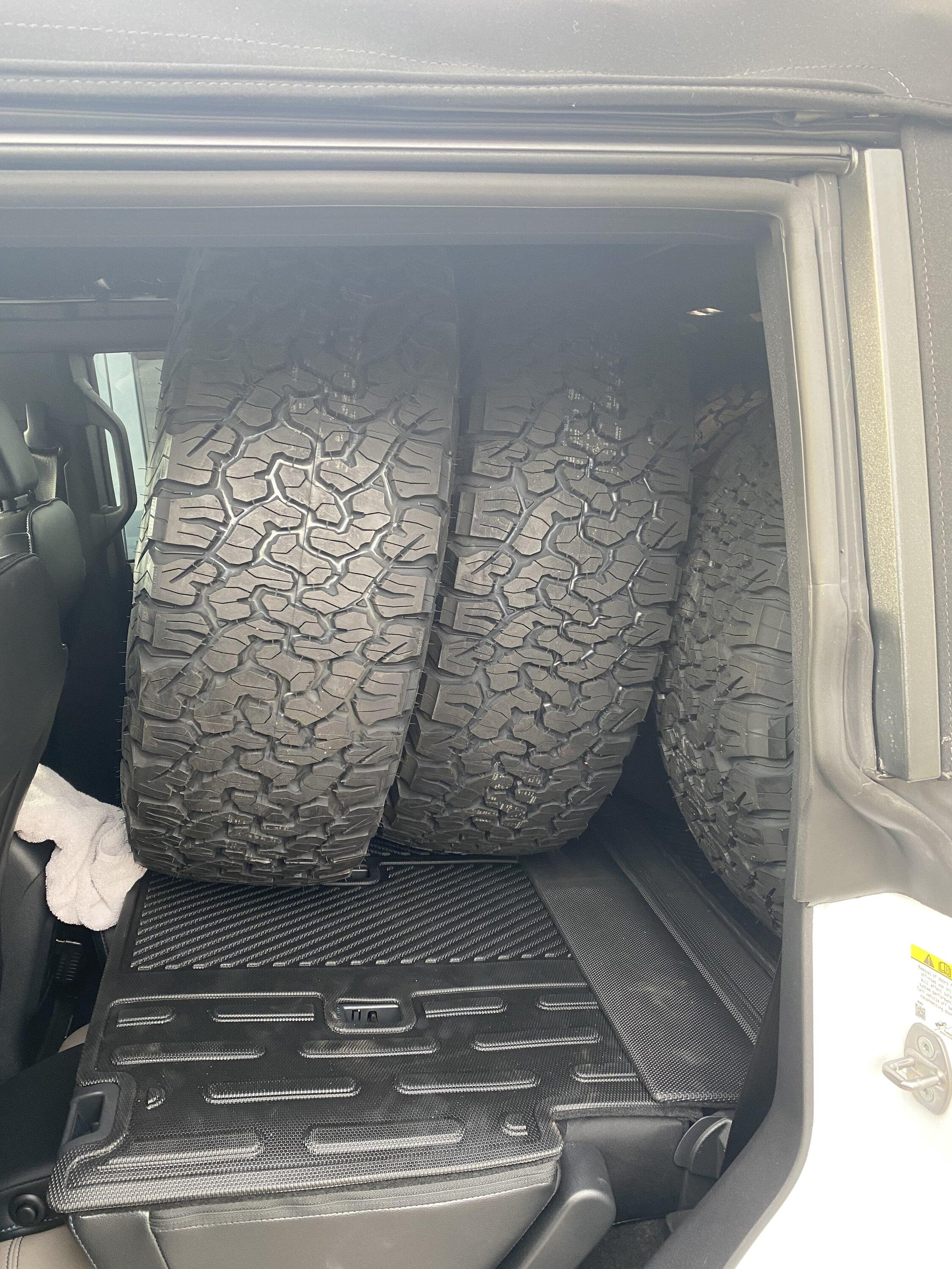

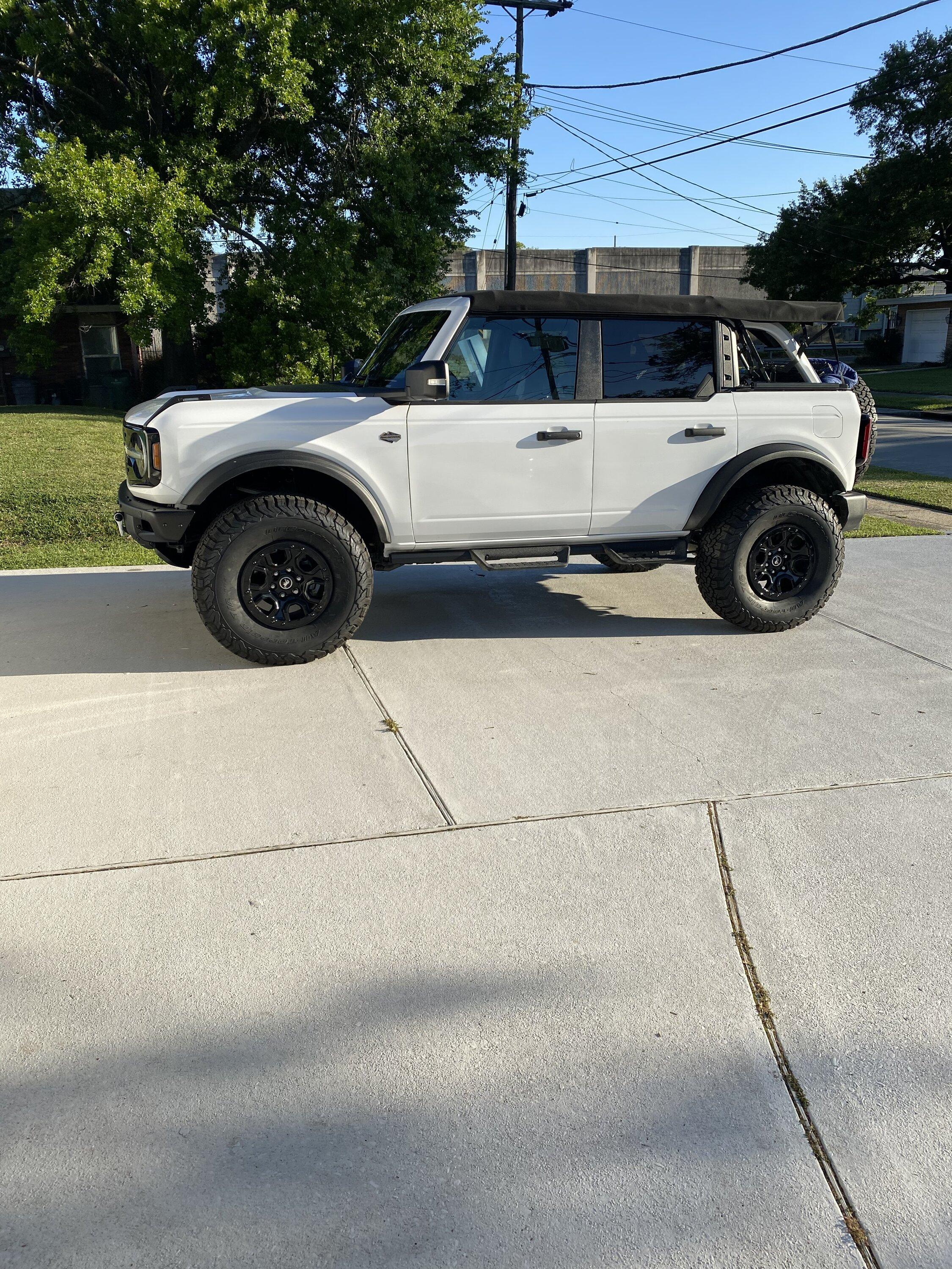

I know it feels like I’m holding out on everyone but I will get some details and more pics on here tomorrow. Supposed to have some ā€œme timeā€ tomorrow. Took this pic before I headed out to work today just so y’all know it did happen! And in case anyone was curious, you can fit 5 37x12.5r17s in the back of a 4 door…
No worries Bean14- thanks for the update! Looks great!
What I’m really interested in is the collar set-up, so you went 2.25ā€ all the way round (instead of the 2.25f/1.5r) correct?
It does look like you kept just a bit of rake. Are you happy with that decision? I think it looks correct.
Oh and did your installer have to do any cutting to get the tires to fit with this lift? Can’t seem to get a straight answer on if the 37s will fit without cutting on a SAS WT w HOSS 3.0 and the 2.25ā€ collars. That would be super helpful to know.

Yes, 2.25ā€ on the front and rear. I had 3/4ā€ maybe 13/16ā€ of rake before and I believe it is the same after. And yes I am happy with my decision. Well, I would have loved a 4-6ā€ lift and 38-40ā€ tires but my wife would have murdered me. As a daily driver I think it is perfect.
So far, much to my surprise, I really don’t feel any difference in the ride quality. And still no rubbing at all. (Highways and side street driving)
