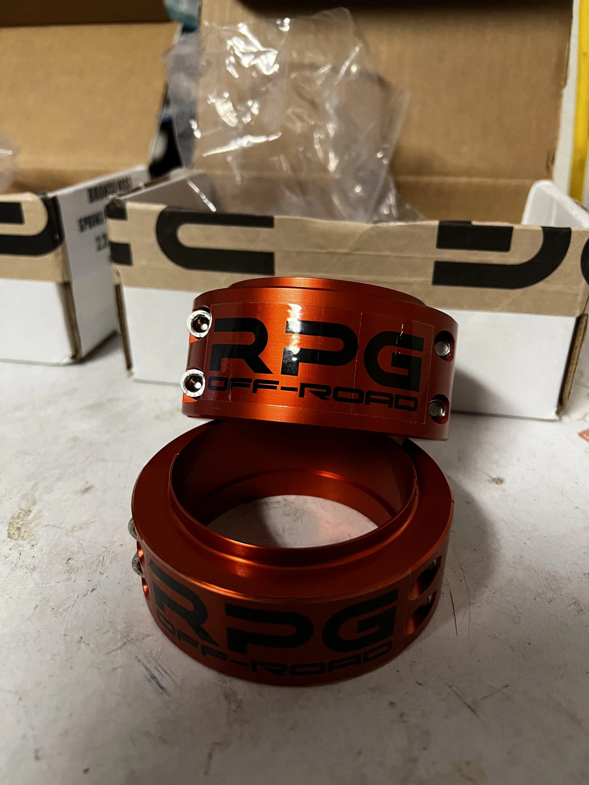

Will do! What I CAN say is that my collars arrived last week and they are very well machined and the Fox orange color is gonna look real nice. Shipping was very quick and the guys at RPG have been very patient and informative through my process of making by his decision.
I still haven’t figured out tires so we’re gonna see the unadulterated impact of the collars on the ride.

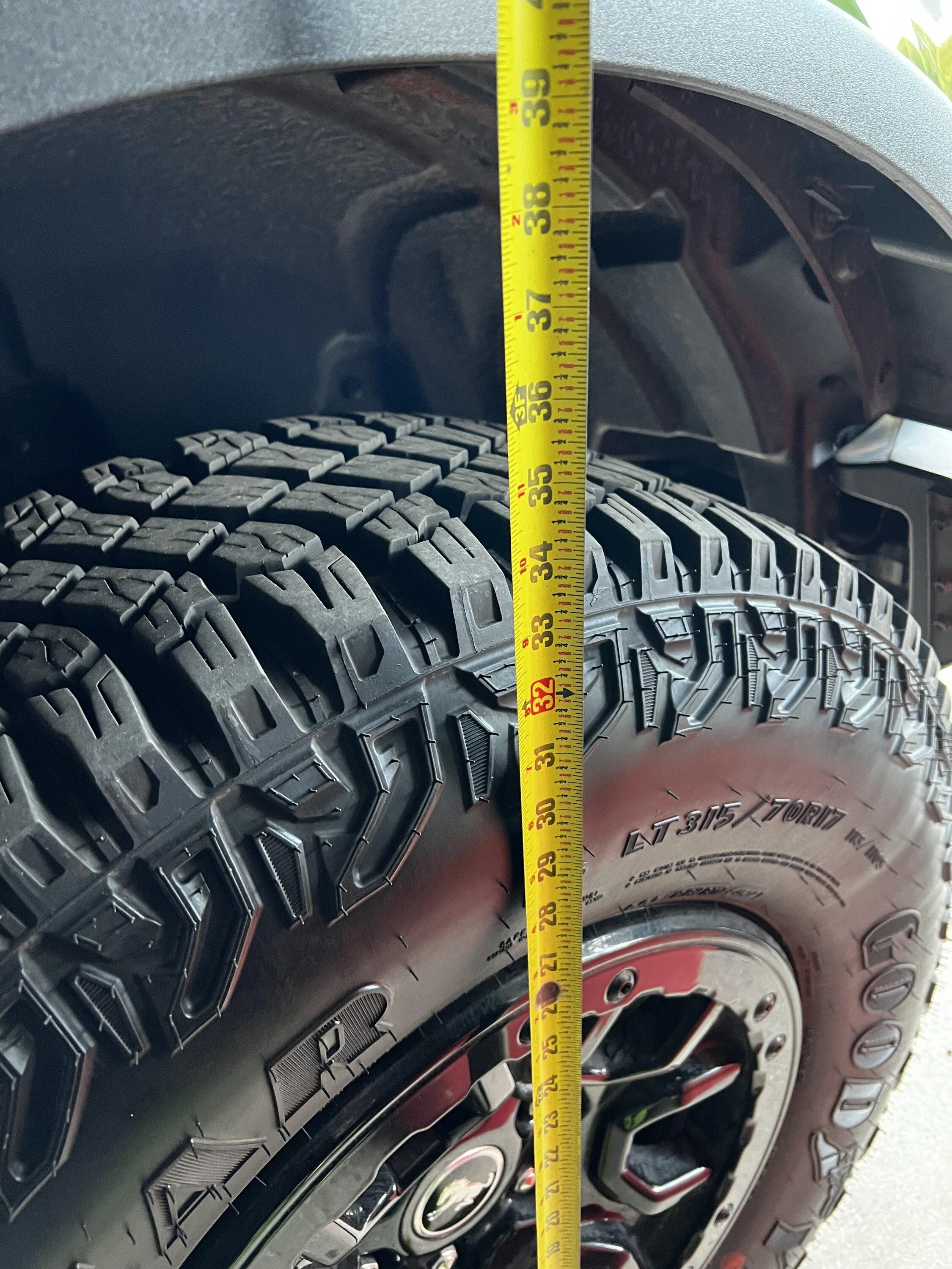

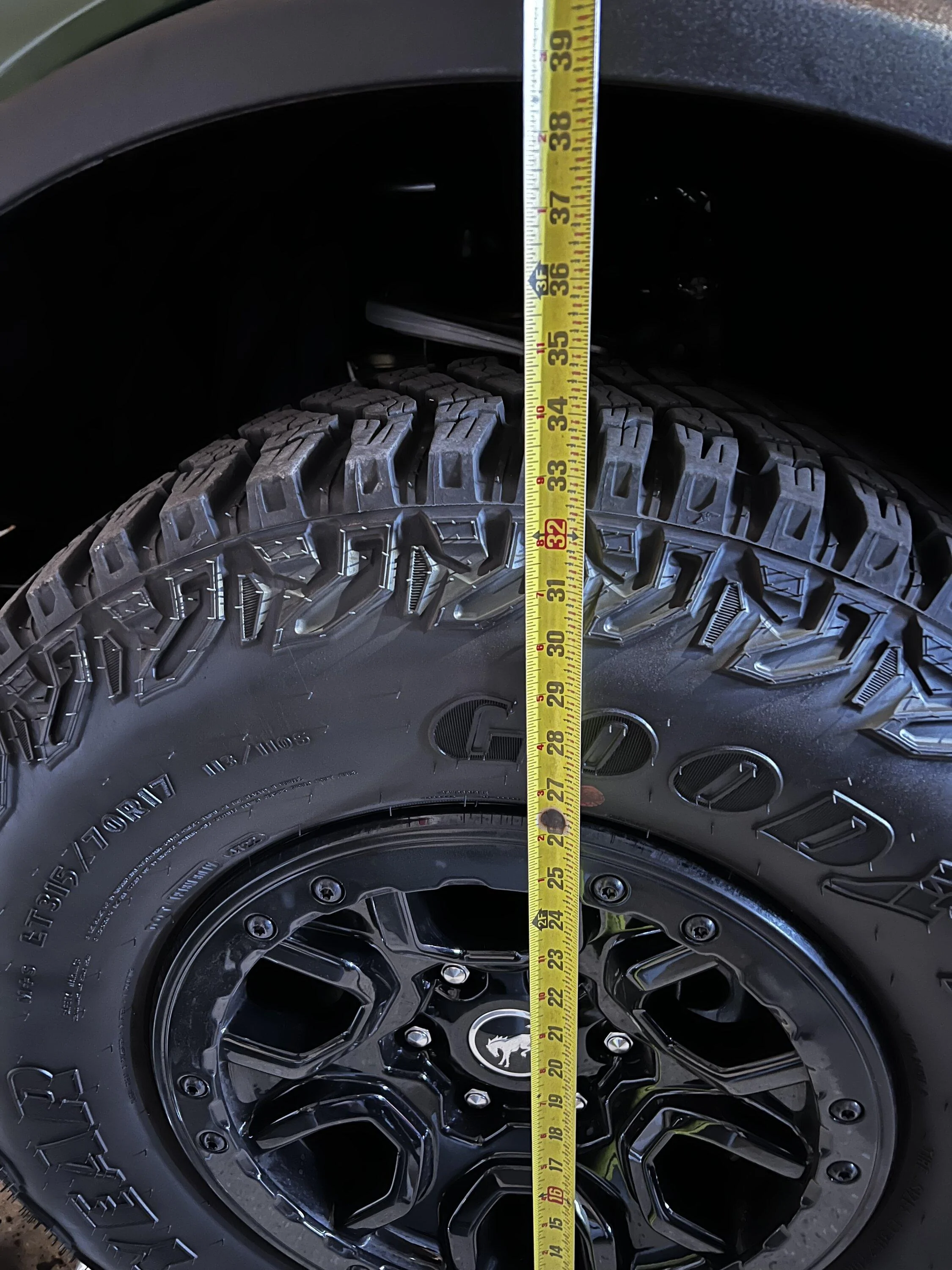

Pre-lift measurments from tire to fender were...
Front about 38 1/2ā€ (camera angle is odd)
Rear about 39 1/4ā€
I have measured approximately 3/4-1ā€ of rake historically.

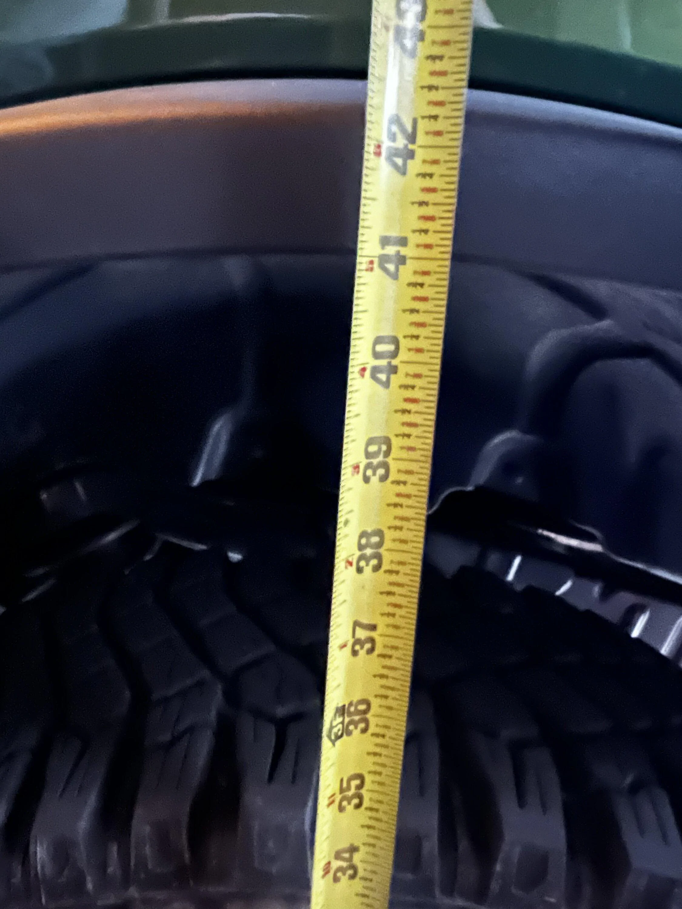

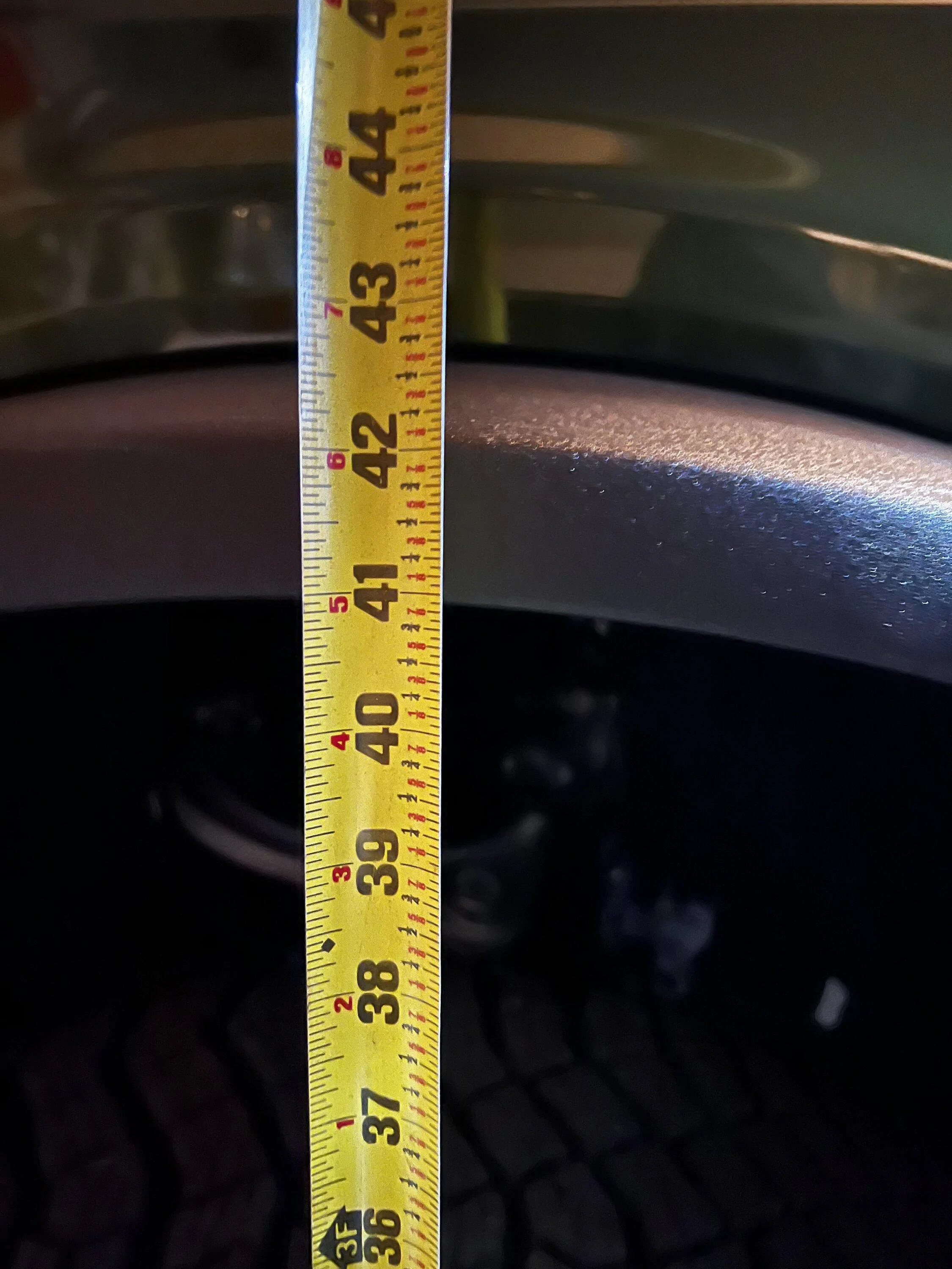

Post lift both front and rear are very level and sitting at right about 41ā€.

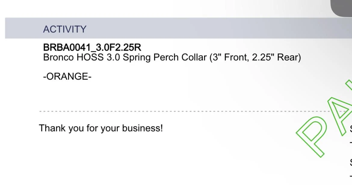

And yes- I confirmed my order on the invoice, but the change in height is somewhat less than expected at around 2.5" up front and 1.75" at the rear. So about 1/2" less than anticipated all the way around.
