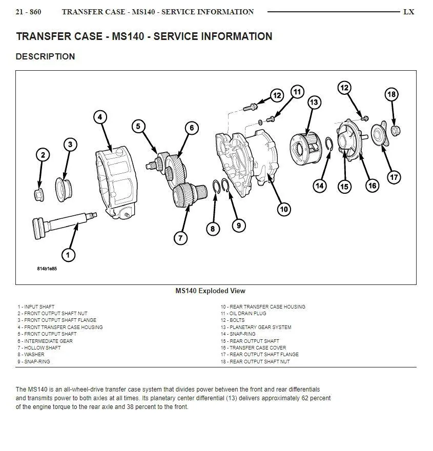

I'll say this, I own multiple fully mechanical AWD T-case, On demand auto 4x4 and true 4x4 vehicles. they all do fantastic with good dedicated snow tires, which they all run.
My 06 Chrysler 300c uses a Magna Steyr MS140 transfer box with Full time all wheel drive, 38/62 torque split front to rear and it's fantastic.

Laminar
Jun 28, 2020
969
2,511
Iowa
Cougar
Looking back, you first compared a Subaru and Honda to a Hummer, not I. I compared traditional AWD to the electronically controlled poor excuse for AWD on crossovers and front biased cars.
There is no such thing as a 40% front and 60% rear AWD setup.
Your not doing good at this, might want to check your notes some more. 😉
Okay *checks notes*
https://www.transmissiondigest.com/borgwarners-4484-transfer-case-heart-of-the-hummer/
These are not clutch-driven units but are an electronically shifted design using an internal planetary-type differential to achieve a 60/40 torque split rear to front.
https://www.randysworldwide.com/wp-content/uploads/2017/02/Identifying_BorgWarner_Transfer_Cases.pdf
https://www.e46fanatics.com/attachments/e46xi-pdf.791401/
http://subaruidiots.com/dccd-subaru-sti-explained/
https://mechanics.stackexchange.com...-transfer-case-split-power-between-front-rear
I'm sorry that it's not a YouTube video and you might have to actually read.
