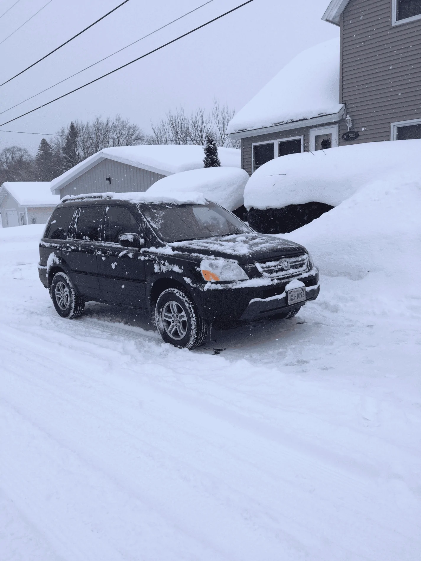

I hate to get in the middle of a good pissing contest but have you ever driven a Honda in the snow or just watched YouTube videos? Our experiences can't be further from opposite of each other. My Pilot was a beast in snow and it was old tech from '03. Our Audi was great as well and my parents CRV and Forrester are also fabulous.
Having grown up in the UP and still having many, many relatives there with AWD cars, we are not on the same page here with AWD being absolute trash, quite the contrary to a lot of real world experience.
Edited to add that my Pilot would run circles around my three previous Broncos (up to about 3 feet of snow anyway where ground clearance would become the main issue), 2 Gen 1's and a Gen 2.
I wouldn’t put myself in the situation personally, I see enough AWD crossovers stuck in situations I would expect of an open diff 2wd long bed truck. Snow is a bigger issue of having the correct tires, with the right tires a Mustang will do fine In snow.
