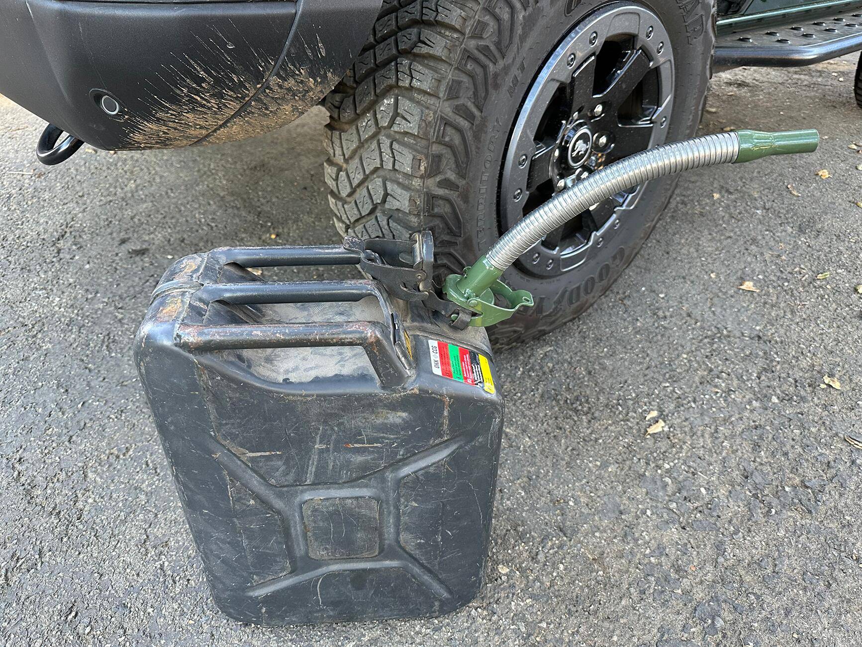

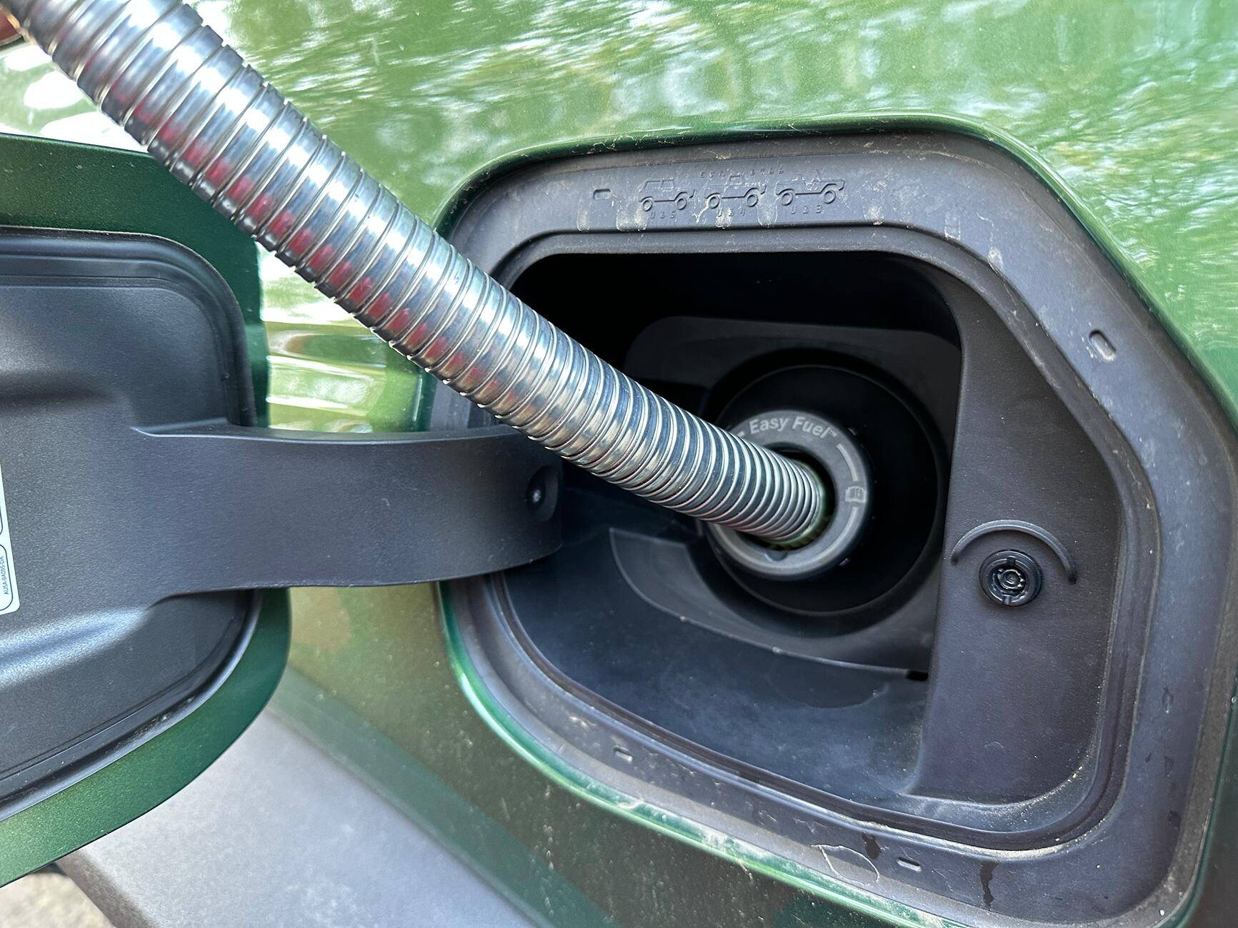

I use Nato Cans and this nozzle from Amazon. NATO Long-Nose Flexible Jerry Can Spout
The end of the nozzle is the correct diameter to open the fuel tank flap so no funnel is needed.

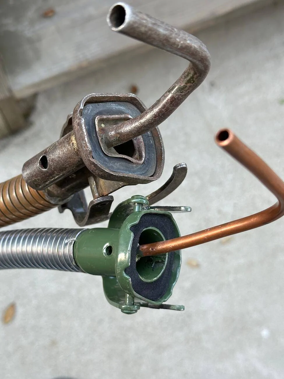

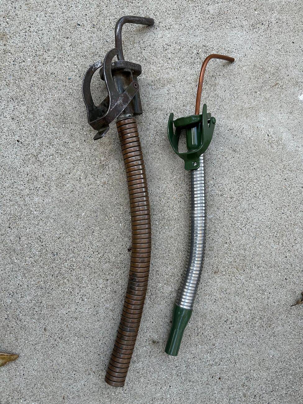

I modified the vent to better match my original NATO nozzle so it doesn't splash fuel from the vent hole. It works well and flows fast.
I also changed the gasket with a Buna-N Foam gasket to better seal with my Nato cans as I have cans dating from the 50s to modern knock offs and there were slight differences between them.
Foam I used from Amazon Buna-N Foam Sheet

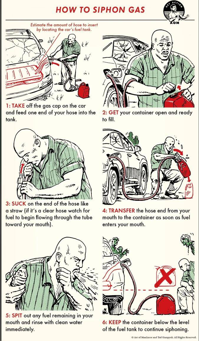

Step 3 is critical. Step 5 could be substituted with "Swallow" if you are hard core and/or being filmed.
With enough practice you can tell when the gas starts flowing and switch the hose to the can before you get any gas in your mouth. FYI gas is not an acquired taste. :)

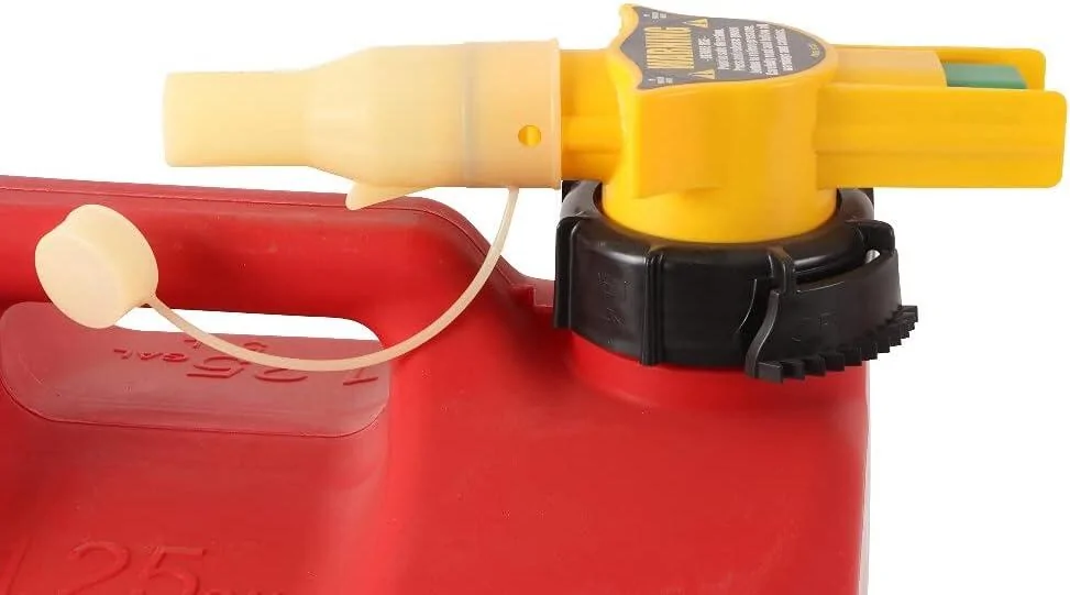

Maybe you could fit a dispensing cap with a tube, and let it flow straight into the truck's tank? You'd need to allow for air to enter, of course. And you're more vulnerable to leakage with it downside. You'd still have to take the tank down to fill it. Overall, I think the best solution is to have the fill/dispensing cap positioned top-wise, and acquire a more sensible spout to dispense.
Avoid any can with a spout with terms like "E-Z," "Safety," "Eco" etc. Anything where you have to hold a lever, trigger, or some kind of spring device is to be avoid. You'll end up spilling fuel, thereby nullifying the objections of any environmental or safety designers. These frustratingly evil designs come from bureaucratic "experts" who think they know what's best of all.
An excellent example of the user unfriendly devices to be avoided.
Ford Bronco Fuel funnel 1734495253070-zu
You can get straight-flowing spouts from amazon.
I wonder if the PaxRax water spout ("Not For Use With Fuel!" they scream) would let gasoline just flow out. But speding $15 or so for a plastic spout is ridiculously expensive to me.
