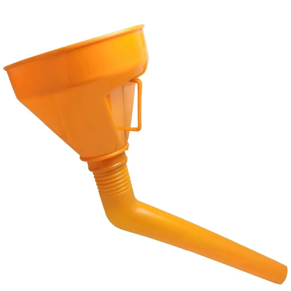

I recommend using the funnel that came with the Bronco under the floor in the cargo area. It fits perfectly.
Should be back there with the jack.
Good point, and I do carry it when I'm not around my tools and things. If at home, I have something like this:
Ford Bronco Fuel fill up mishaps (Overflow) 1726464573241-g5
