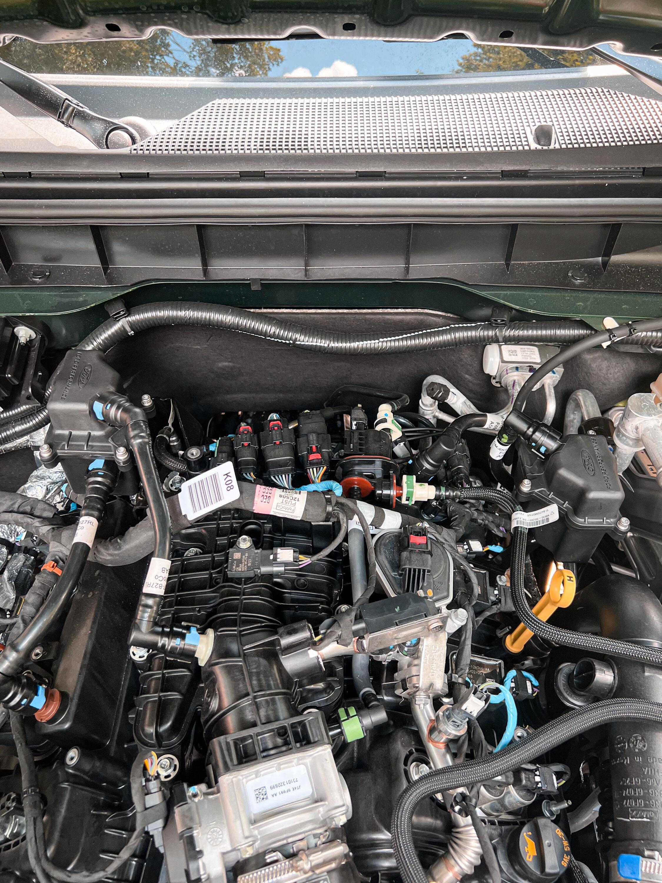

Here is my install. Remember, it's not plumbed up ncuz we don't need it.
DM me if you have questions on my build. See signature line.

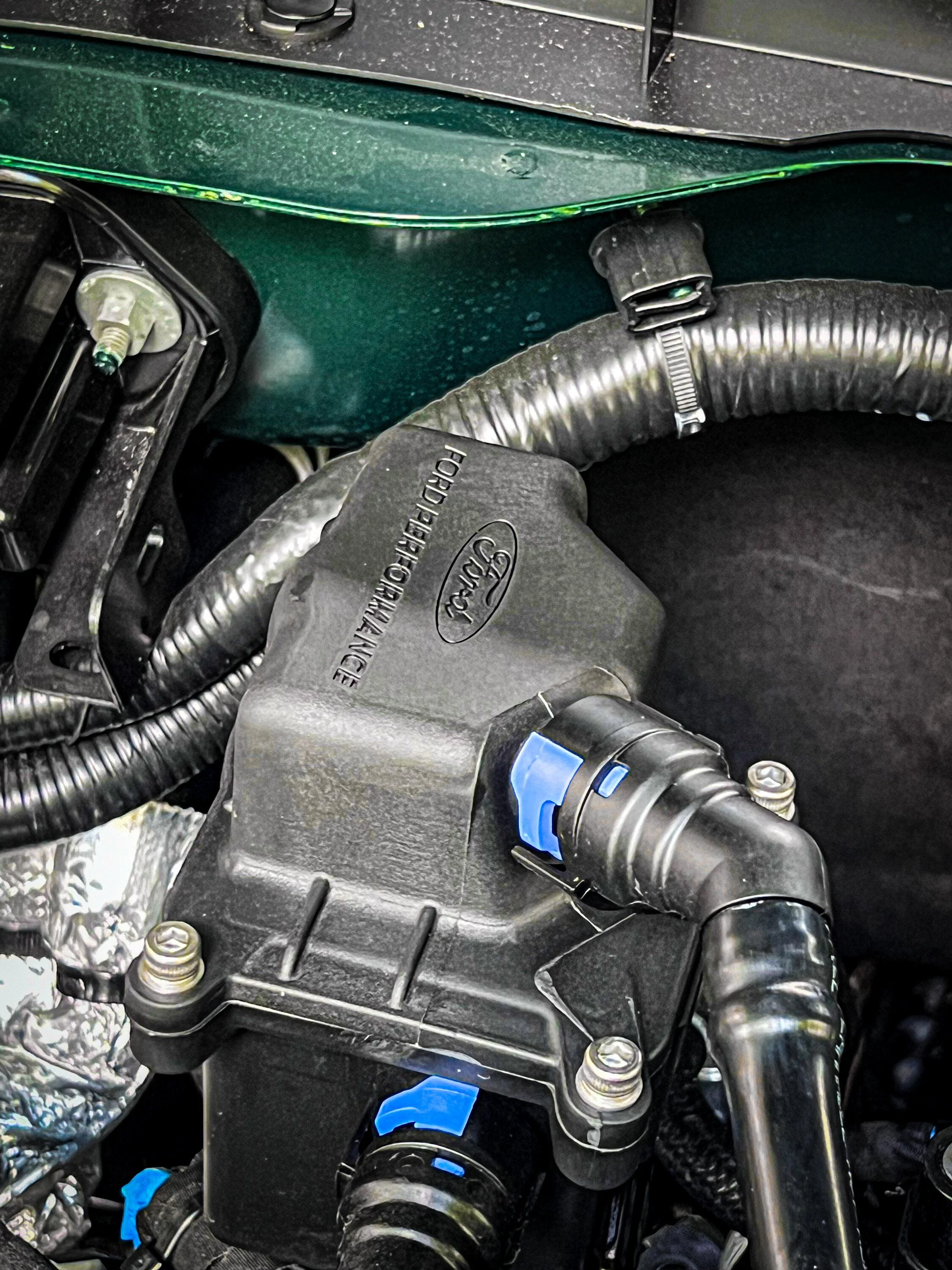

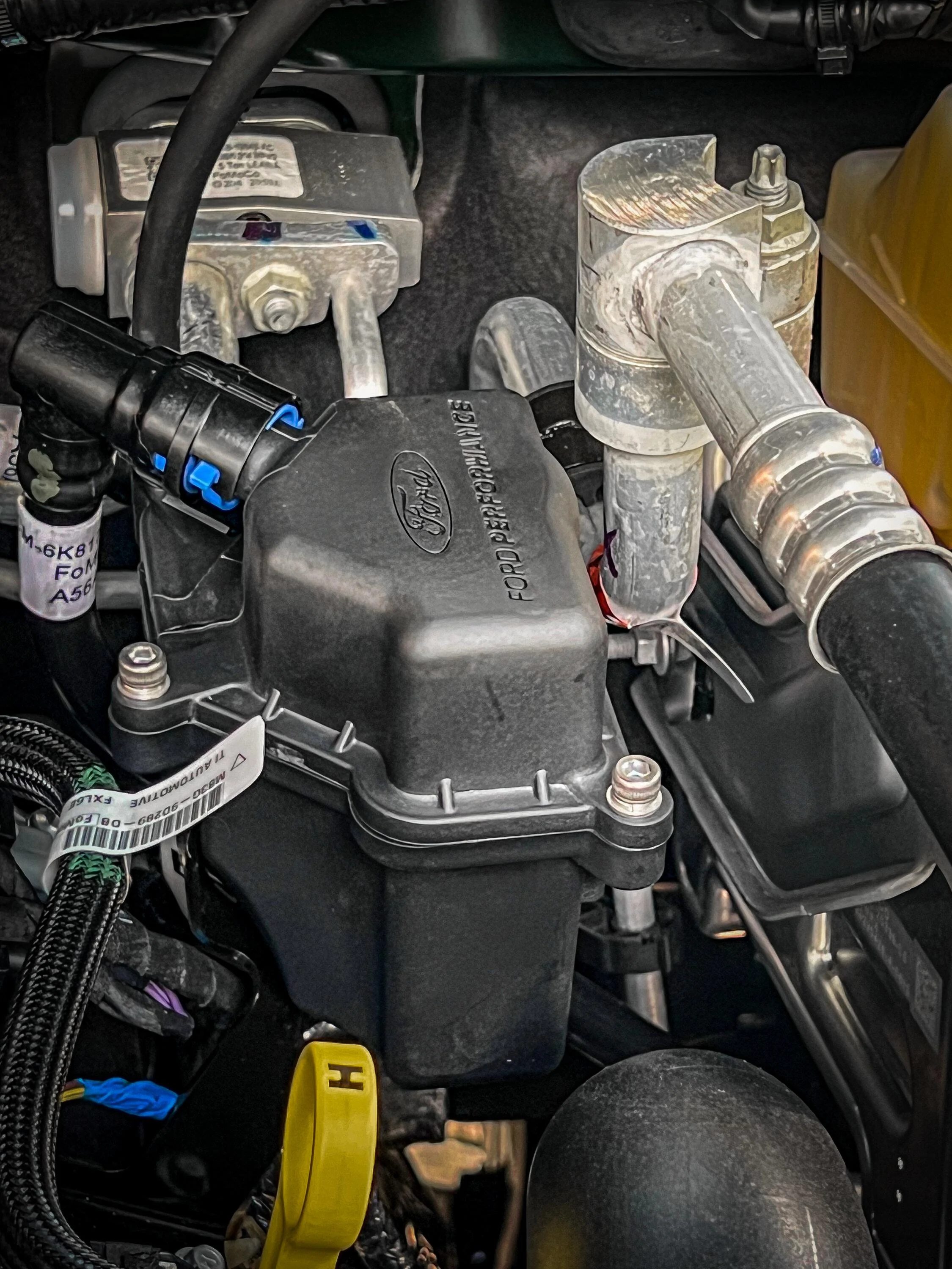

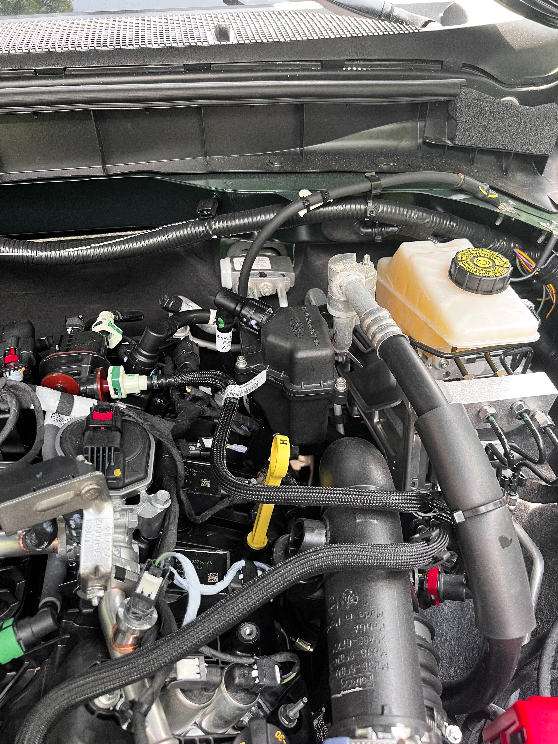

Installed. Lethal was great on service, as the Ford kit was missing one of the brackets, so I got half installed. Then the missing bracket arrived. Went to install it, dropped the driver side bracket and spent 30min in awkward positions to fish it out from between steering and suspension parts. Driver side OEM lower hose connection was tough with the orange end hose. Anyhow, job done.
Are there drains, or do you have to remove & open them up? is there any kind of level check?
Thanks 🤠
