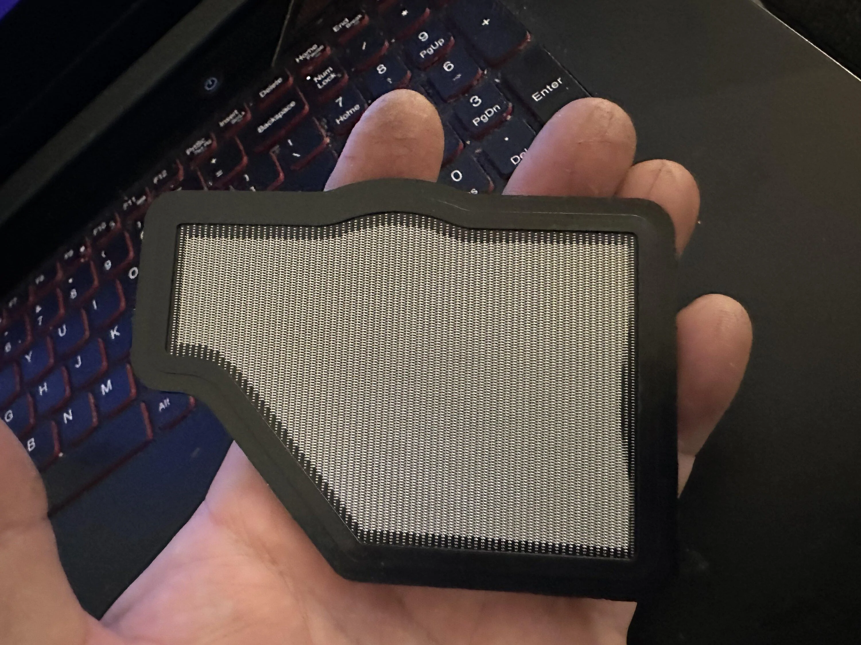

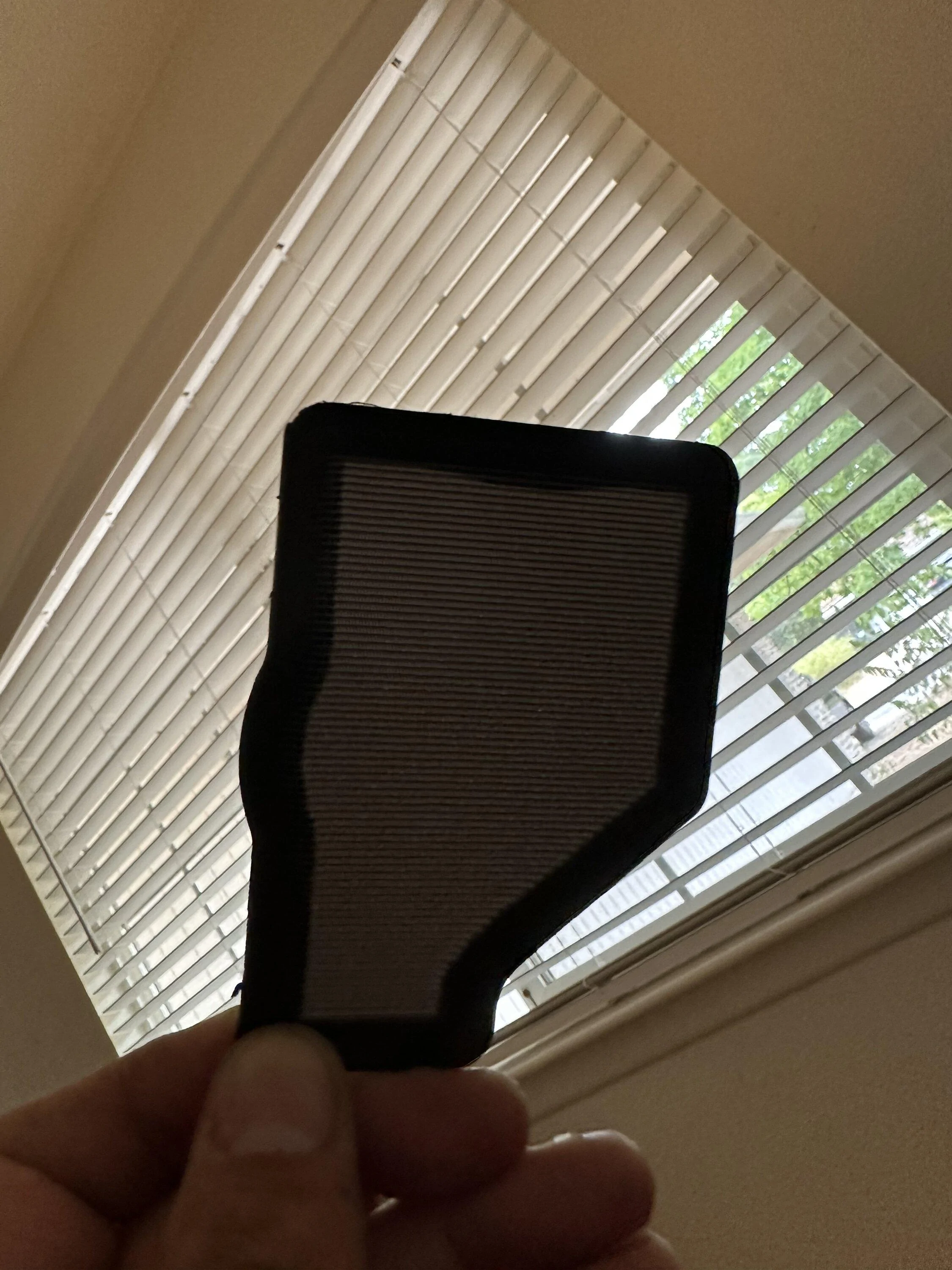

I think the screen in the catch can is too restrictive. It doesn't even allow light through it. The OEM tube is just that, a tube no restriction at all.
Anyway I took the screen out and I'm going to try that. Edit: I used rough steel wool as a substitute
On a side note 1500 miles and not even a film coating of oil. Bone dry.

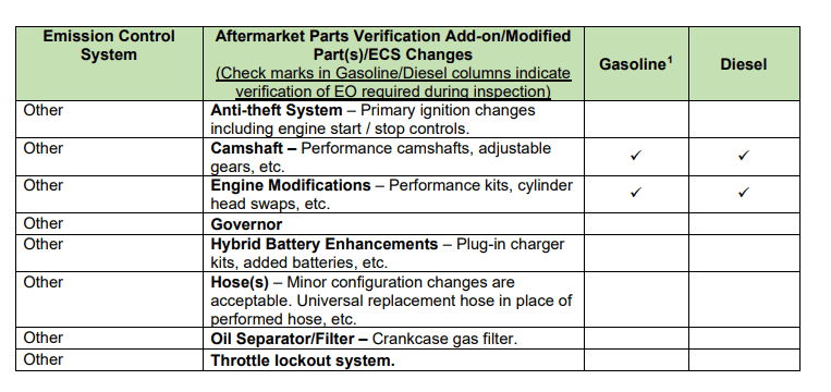

`for those asking, oil catch cans don't need a CARB EO number. OIl separators aren't a smog check item.
While that seems to be the case on paper do not be surprised if some inspectors fail you.
Some legitimate reasons they could fail a catch can are:
It is vented to the atmosphere with one of those little air filters.
It has the incorrect hoses used that are not PCV rated (Oil and gas rated)
It reroutes the factory lines in a way different from the factory PCV system.
And the one that is in the gray area is: Any change to the factory PCV system is a fail.
So what that chart up there really means is if your car came with a factory Air Oil Separator and you replace it with an aftermarket one that is a pass. That is how some inspectors choose to interpret that area of the law. And the BAR will back them up on that. But the BAR does not ding inspectors for passing catch cans, so they are squarely in the middle of the gray area.

I replaced the screens that came with the cans with copper foam.
Nothing on drivers side.
A fair amount passenger side. I estimate that I will fill it every 4-6K miles depending on driving and weather.
In summation, for the 2.7 the passenger side is worth getting.
Save some money and don't bother with the driver side.
The filters are too restrictive and may cause a CEL.
Copper foam works well and is what most catch cans come with.
TLDR: Over all the Ford performance cans are wildly over priced and not worth the
hassle and expense of trouble shooting the CEL and then modifying them to work.

Feels like your conclusion is wildly over the mark re filter material. I’m having no trouble for several thousand miles without any changes to filter medium. You might chalk up the CEL experience to a bad part or a bad combination.
I can only speak about my experience.
I can recreate the CEL at will. All I have to do is reinstall the filter it came with.
