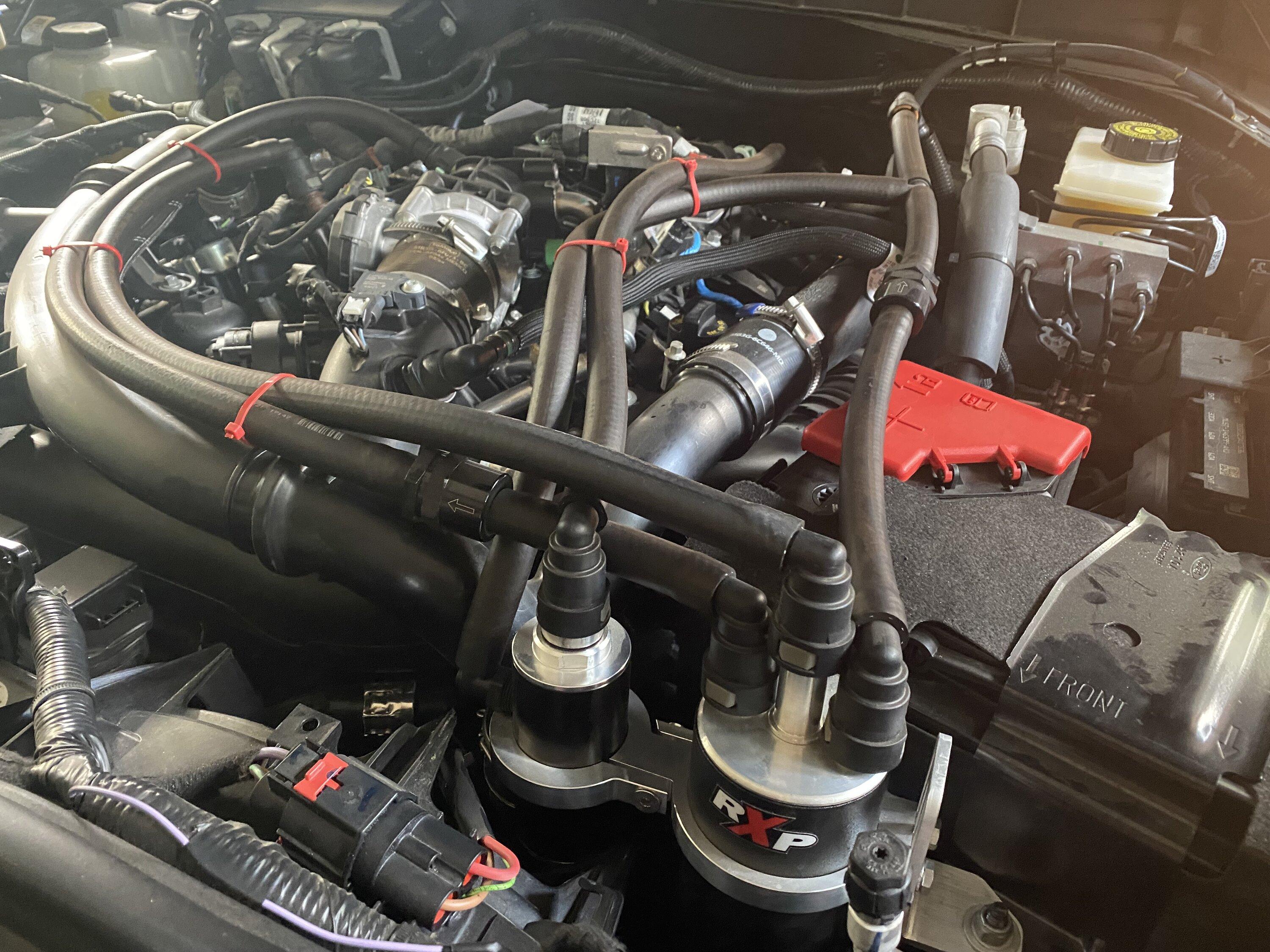

Bought my Bronco (2.7L) w/ 5,000 miles from a friend who swapped it for a F-150 Raptor because he had 2 small children and the baby seats didn't fit in the back without the front seats being uncomfortably forward. He had already purchased but not installed an RXP catch can https://teamrxp.com/ and gave that to me.
It took a little effort to install but team RXP was very helpful. Due to the tight fit and not wanting to jimmy the cans out for every oil change, I added some drop hoses with shut off valves just below the catch can lower fitting. First oil change (6,000 miles after install) was a couple of weeks ago and the catch was minimal, just a few drops.
Ford Bronco Ford Performance DUAL catch cans for 2.7 engine now available IMG_3699
