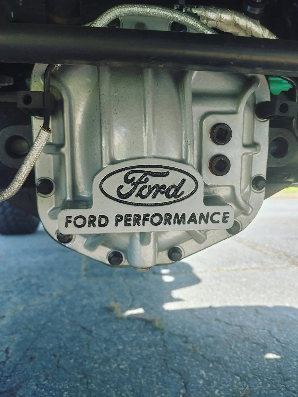

2 years on the truck...hopefully it stays like this.
Perhaps there was just a bad batch???

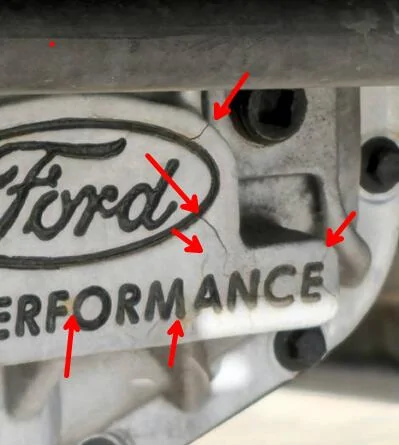

Just walked around the back end and noticed my hardware was rusting. Took a pic and then noticed rust and degrading paint. :( Will have to try to contact FP.

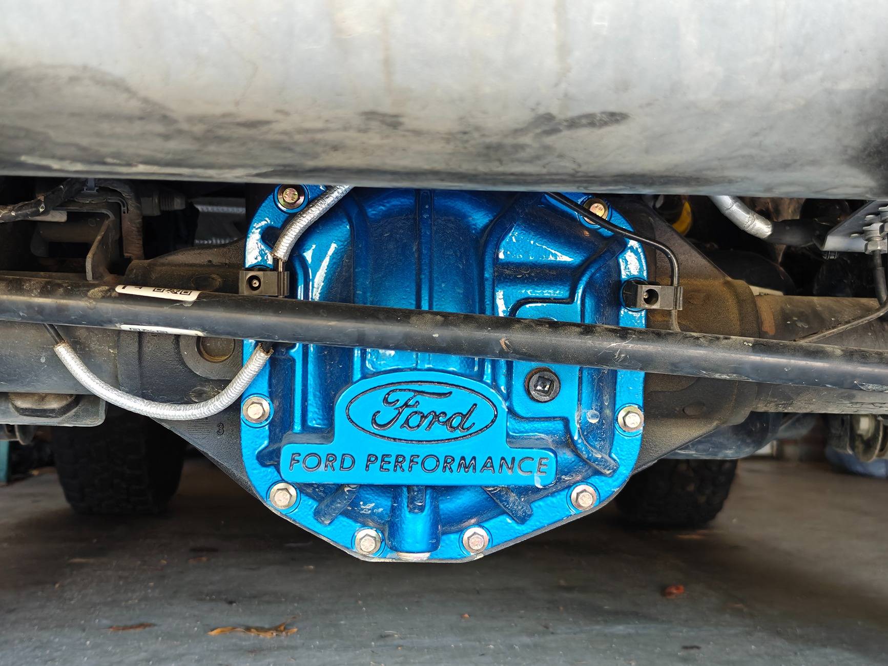

Mine looks good so far. I used bolts @CarbonSteel had recommended so not the FP hardware.

@broadicustomworks painted it but I think he just did a basic prep to spray over as opposed to fully stripping it.

Yeah I washed it down with a grease remover, sanded it with 600, painted over the existing paint.

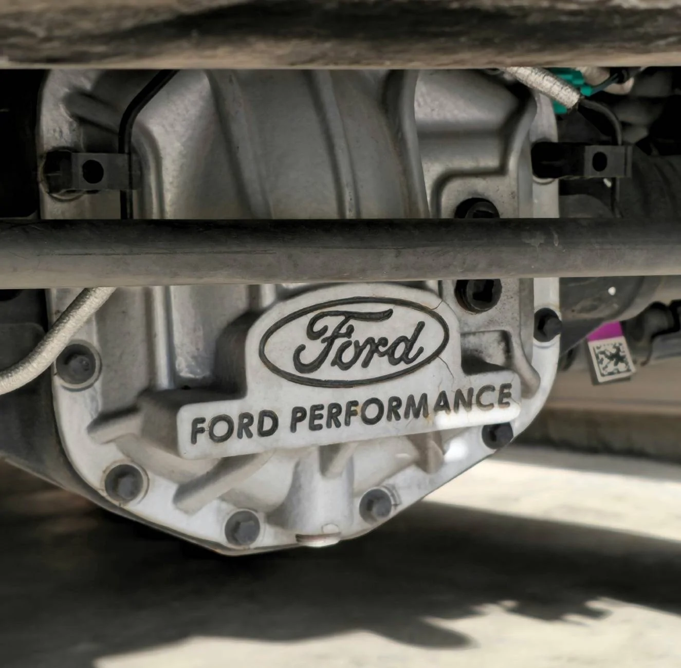

mine looked exactly like this within a month of installation. I primed and painted it with Ford Silver paint. It looks great for the time being lol
