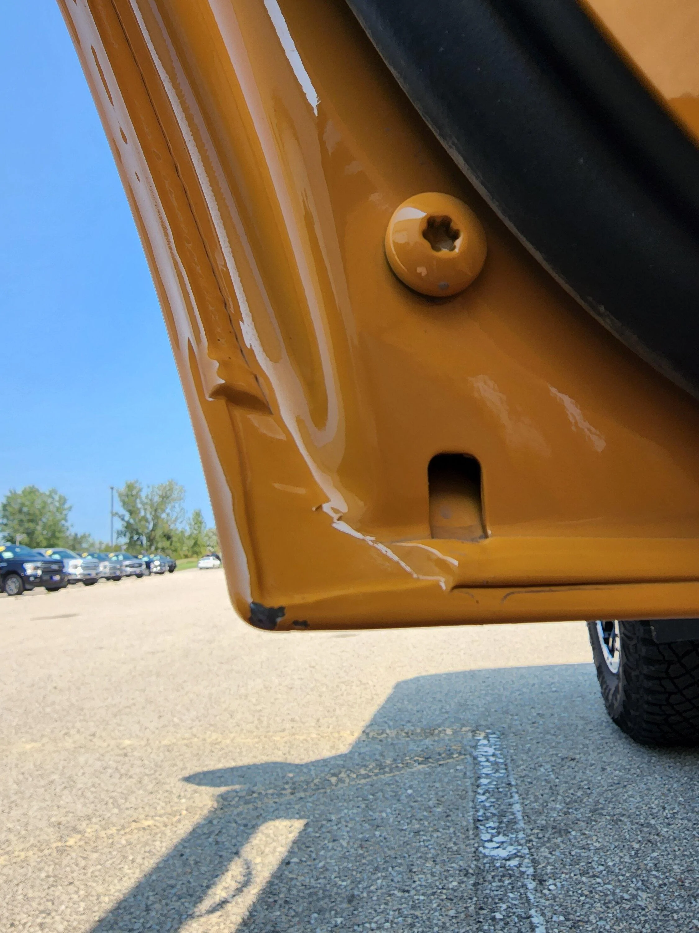

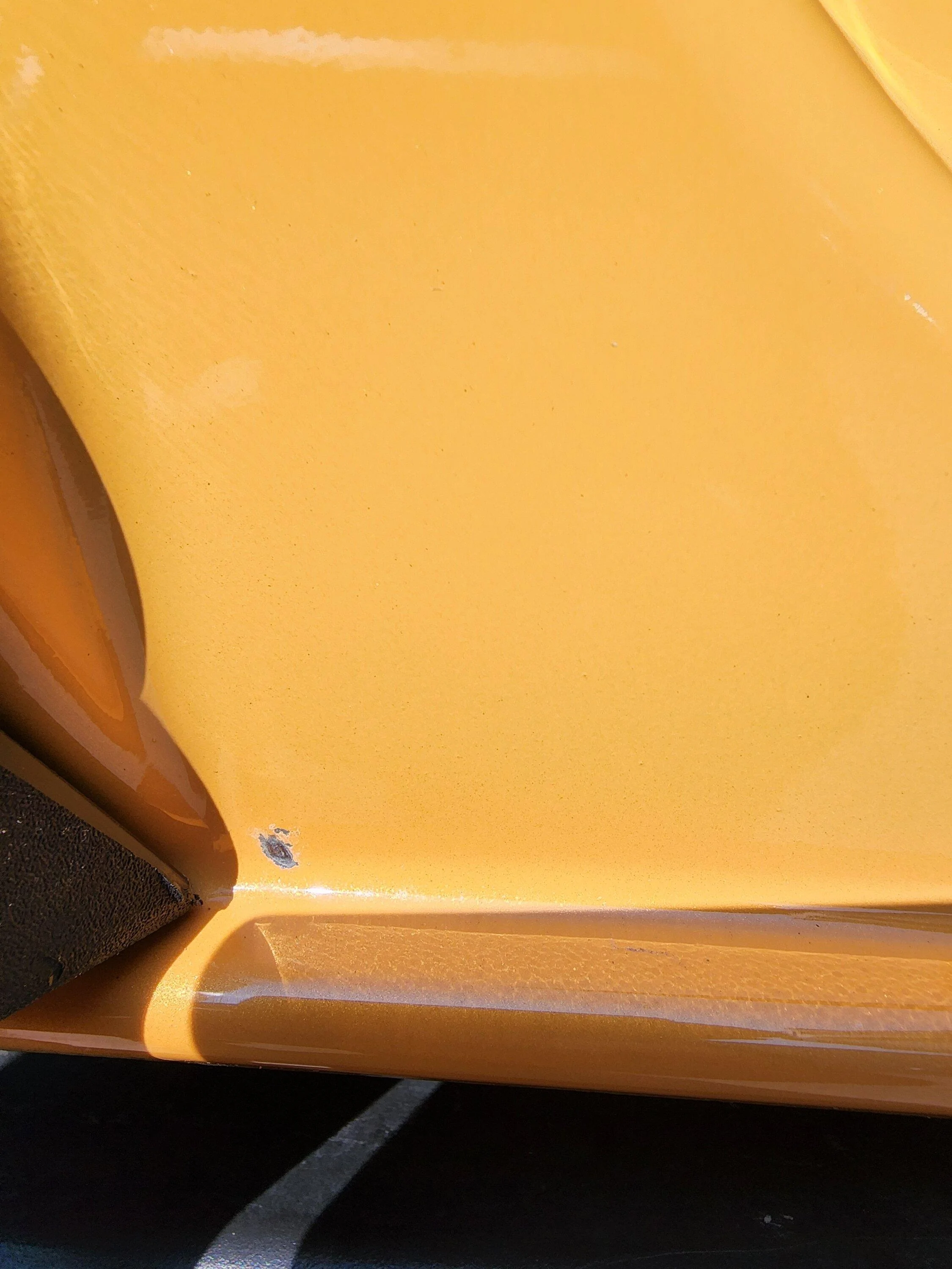

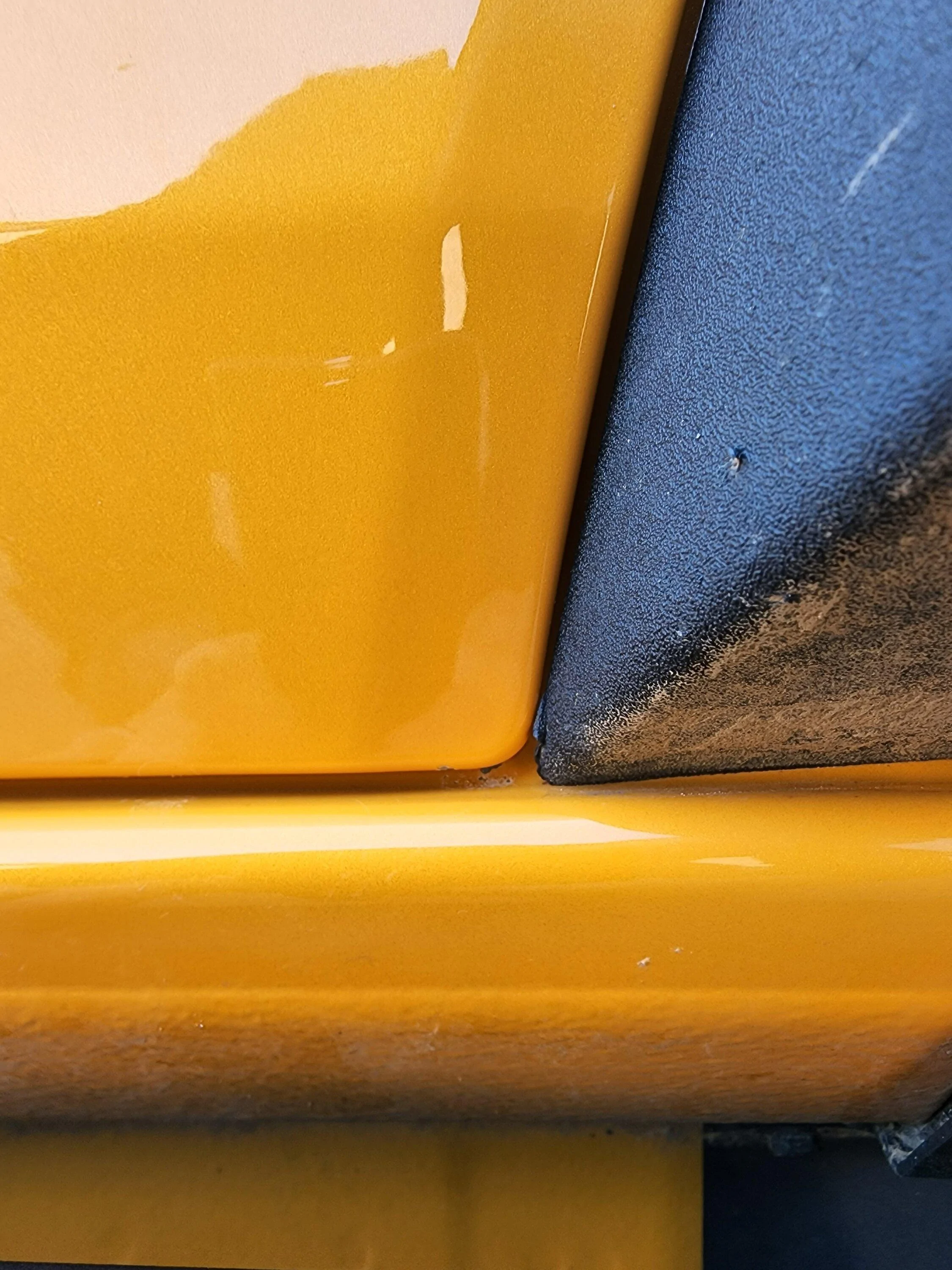

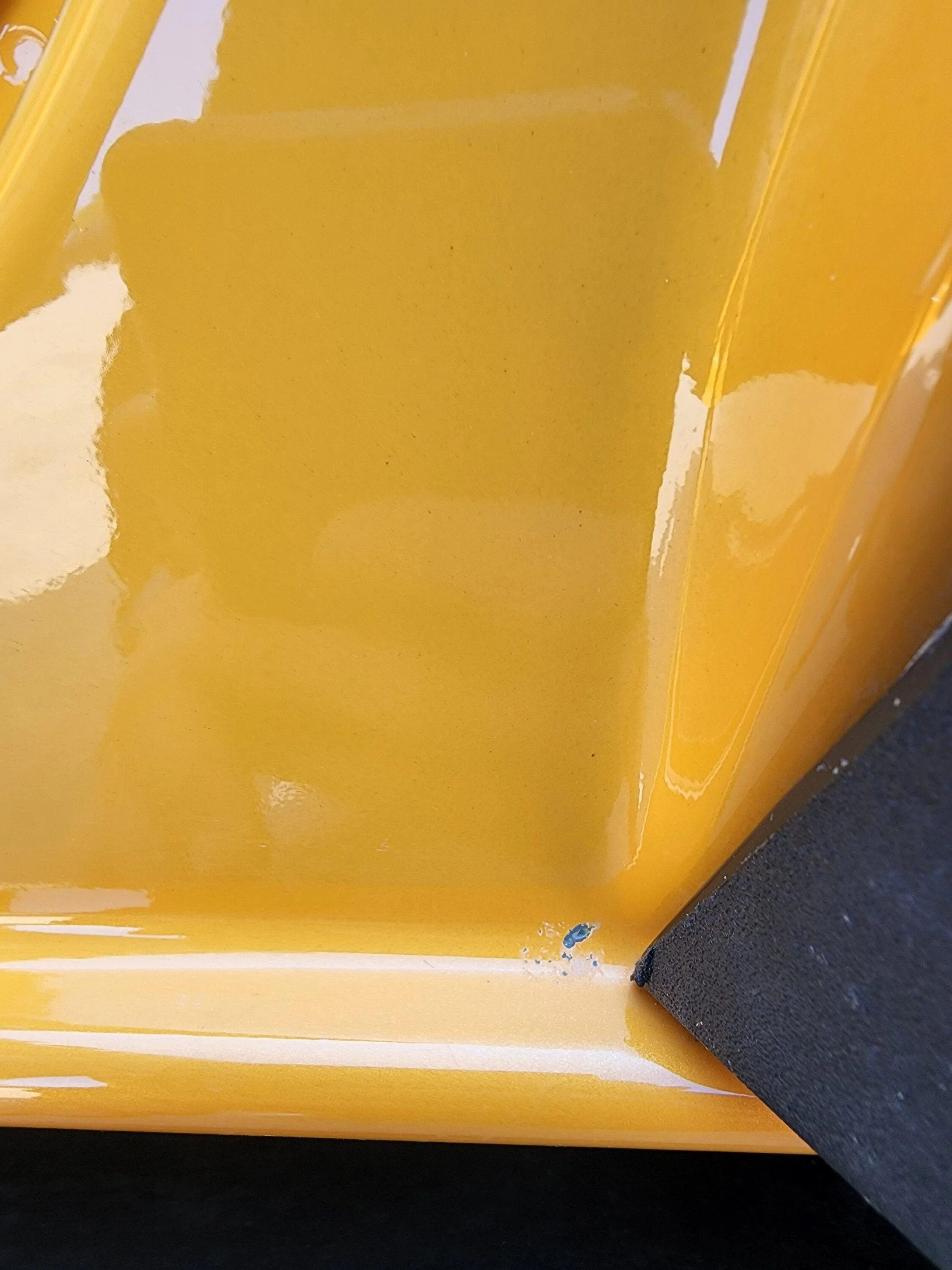

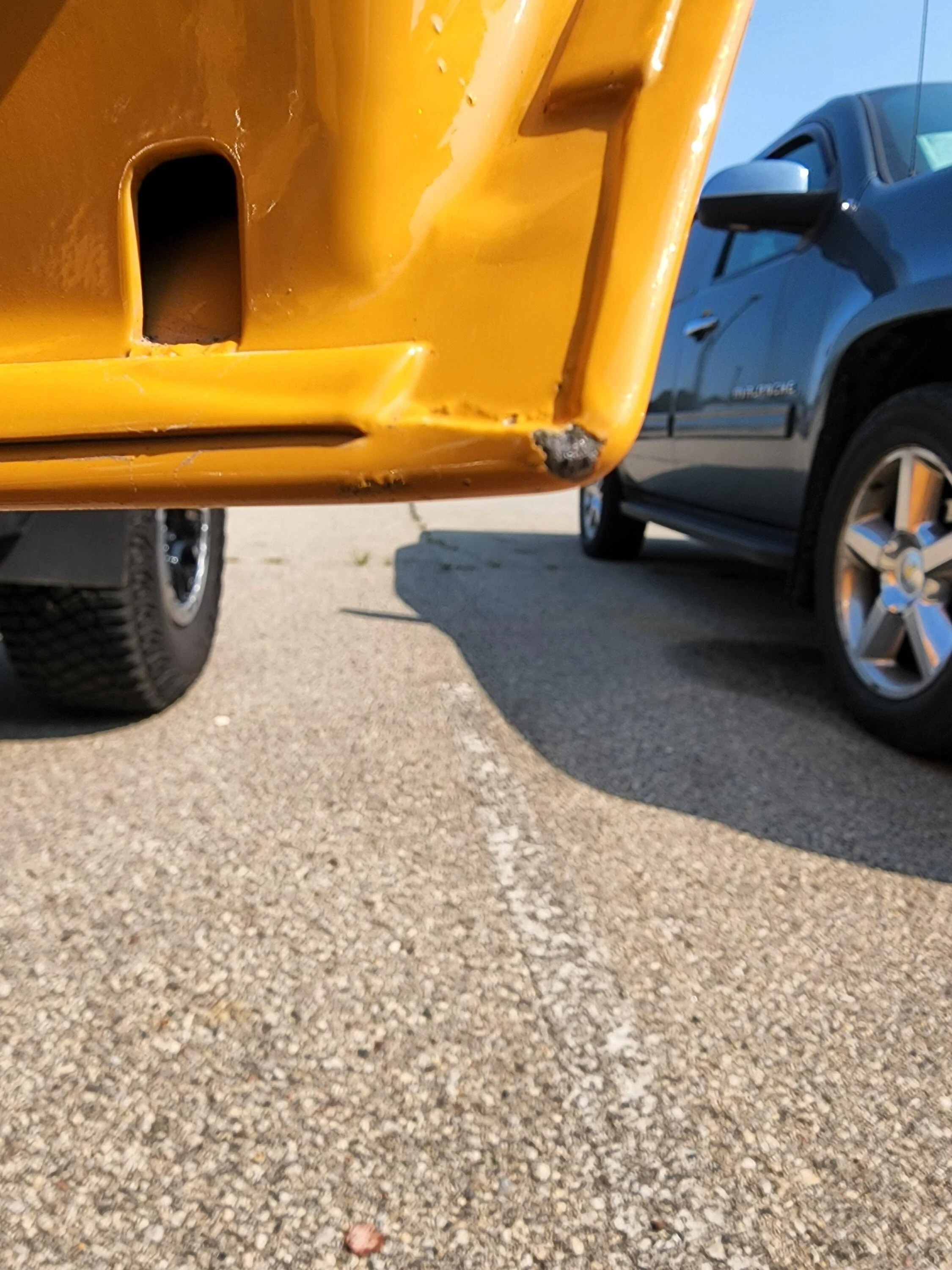

Noticed an issue on my rear doors yesterday when washing the Bronco that I thought I would share so others can watch out for it as well. At first I thought maybe I hit something on a trail that pushed the lower rear portion of the door into the body, but both doors have the same issue. Seems to be hitting the inner sill plate on occasion when closing because of the way the door edge is angled.
I spoke to my service manager this morning who will be checking into it, not sure where it'll go yet but I'll post any updates I get.

I have this on my rear passenger side. I showed the body shop adjuster and they said no prob about getting it fixed. Slight misalignment on the door

There have been posts on this before. I believe it was corrected by door adjustment and then paint

Thanks, sorry if it's a repeat post but when I searched earlier I didn't see any recent threads on it
