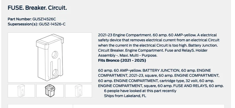

Does anyone know that type of fuses they are? I would like to get some spares in case I drop one.
I think these are Ford special. See pic.
These, from Amazon
28 Pcs 15A 20A 25A 30A 40A 50A 60A 32V Mini Slotted Automotive MCASE Shaped Cartridge Fuse Kit
