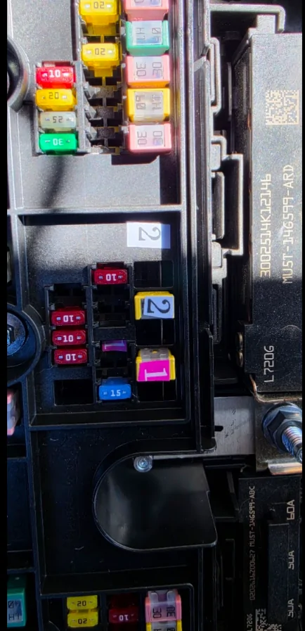

Pulling fuses is only required (Per Ford) on 2026 and 2025 Broncos due to the Electronic Brake Boost that was updated

I did this to help me remember what fuses and what order. I was thinking about using super glue to attach a little loop onto the fuses so I wouldn't need tools, but I didn't need them anyhow since they are spaced apart from each other. Another good thing is that the fuse has the spring friction connection and the Bronco has the blade, so if they wear out, you just need new fuses.

Did. Y first fuse pull and return today. The pull is easy. The sequence to take it out of neutral tow is a royal PITA.

It’s just a PITA. I’m used to the old way that never failed me. Now start the vehicle, turn it off, go to accessory mode, then the regular sequence. Why the addional step starting the vehicle?
