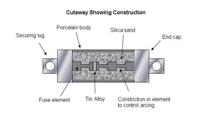

Updated the list to reflect T class fuses. Very interesting devices. Standard AMG and ANL fuses have much lower AIC (ampere interference capacity) which, as I understand it, can result in the filament welding itself back together if exceeded. AMG is the lowest at 2000 AIC and can easily be exceeded by one of our stock batteries. (I believe ours come out to ~3300 during a max discharge event. If someone actually knows please chime in) ANL seems to typically be around 6000, but I’m now wary of what these fuses are really rated at. In the other thread a video is shared where small 2A fuses were tested and some didn’t pop until 8-10 amps. Quite frightening. Today I looked up ANL fuses and the cheapest 100A fuses available from Amazon popped within 1%, where the more expensive Blue Sea fuses (thought to be reputable) didn’t pop until 224! So I don’t even know what to believe anymore. I hate everything.
Back to AIC-assuming everything is exactly the same-amp rating, connections, fuse block, wiring, in a maximum discharge event there exists a potential that the cheaper AMG and ANL fuses can pop but weld themselves back together, closing your circuit and burning your shit down. Enter the T-class fuse with a 20,000 AIC. It’s pretty interesting as it is filled with sand. The sand acts as a medium to help dissipate heat to prevent popping during a momentary spike that might otherwise be harmless. They are ideal for circuits where the motor turns on and off frequently-great description of a winch. In the event that you do overload the circuit, the sand prevents arcing and keeps the circuit open. Very neat. But they are expensive, especially when jumping up to a 500A fuse. 400A is ~$45 and the best I could find for what seems to be something not of sketchy origins (no guarantees) is $130. Without the $60 600A fuse holder.
https://shop.pkys.com/class-t-500
Ordered from these guys and they had the “order shipped” email sent in less than an hour. With a tracking number.
