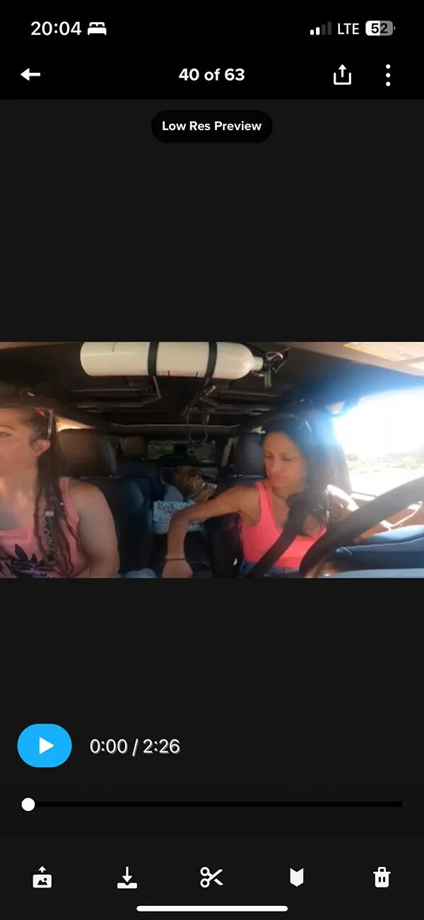

After reading your story, I ordered an extinguisher & this same quick release mount.
I'm curious where/how you mounted it on your rig?
I'm leaning towards making a bracket to bolt into the two threaded holes on my roll bar & bend over to keep it on the inside of the roll bar for easy access.
Right up front on the aftermarket overhead panel. Very quick access. At first we didn’t like it blocking the Aux switches but decided to stick with it. Glad we did. We’ll put the backup in the back.

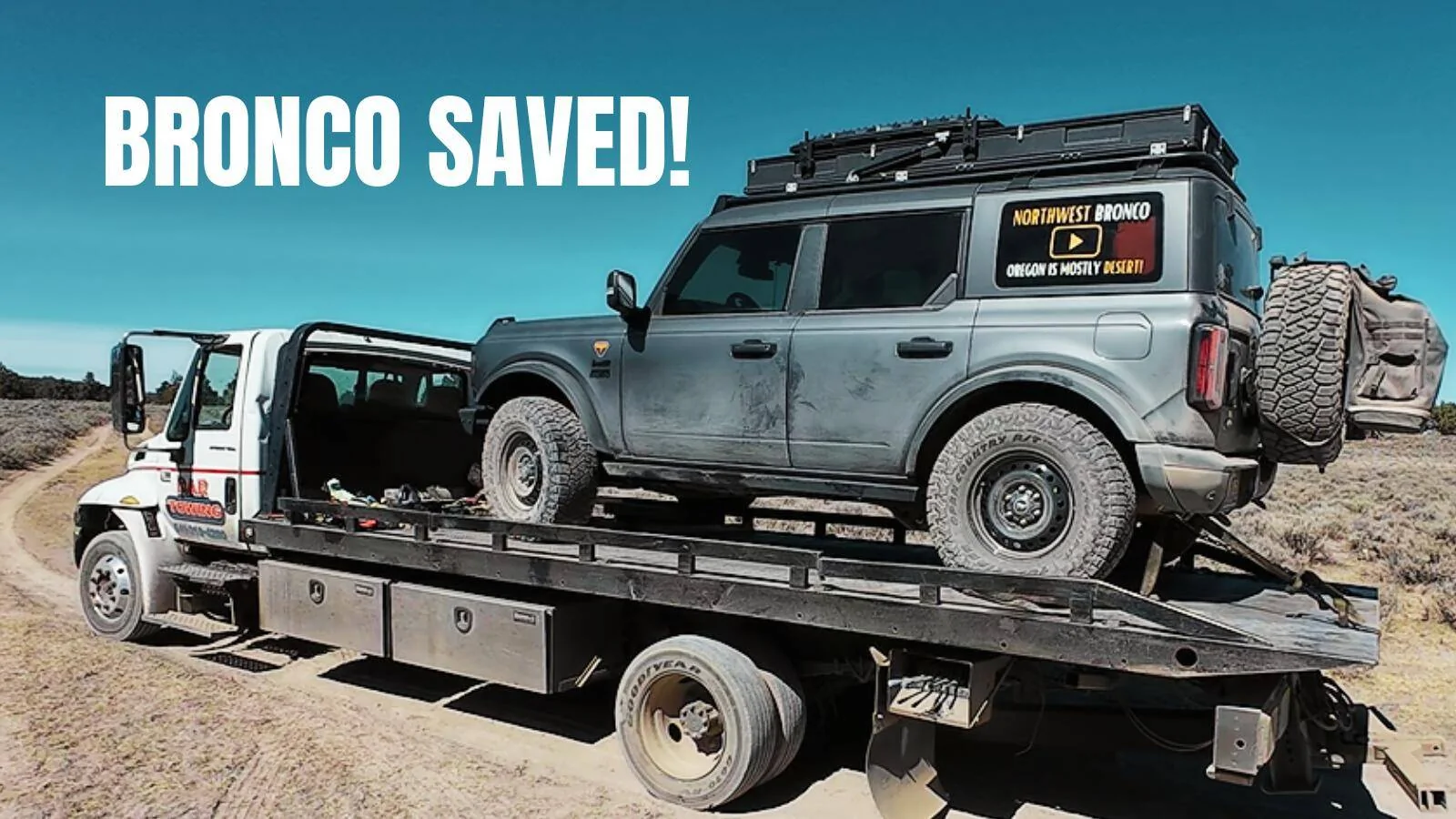

MOST fire apparatus carry three extinguisher's for fire firefighting. Large ABC dry chemical, Large CO2, water can, and foam capabilities. Firefighters will choose the correct method of extinguishment depending on the type of fire.
MOST departments will use water, foam, and or ABC dry chemical for stubborn vehicle fires.
In regards to fire blankets, they're reserved for electric vehicle fires (covers the entire car) Doesn't put the car out, just keeps it contained until the batteries are done burning. Plus, they're super big and heavy. Not practical for overlanding.
Halon displaces oxygen. That's how the fire goes out. The problem is the fire can re ignite. That's the advantage of dry chemical. It creates a crust over the hot surface where the fire was, keeping the fire suppressed. Halon is used by computer companies as not to damage electronics. Floods the room with Halon for a period of time. We're outside dealing with plastic, rubber, fuel, and all kinds of other combustibles.
I don't mess around with mystery extinguishers like the Element. Not that they don't work, but the testing I've seen is not realistic in regards vehicle fires. Shown are small easily controlled fires. Plus, you have to get your hand in there for it to be effective. Not always possible and likely to burn yourself.
Use what's proven to work (most of the time) an actual vehicle fire is not the time to see if they are effective. You don't want to lose your Bronco and start a large brush fire.

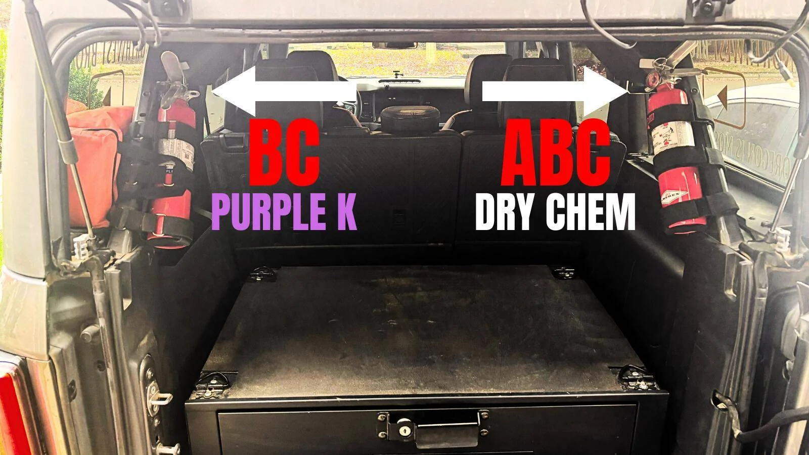

In regards to mounting, anywhere on the vehicle is close enough. Don't lock or bury it under stuff. My advice is keep it in the rear because most fires start towards the front and you want access without flames or smoke making it difficult. Plus, it's a pressurized canister. Rear is a good choice.

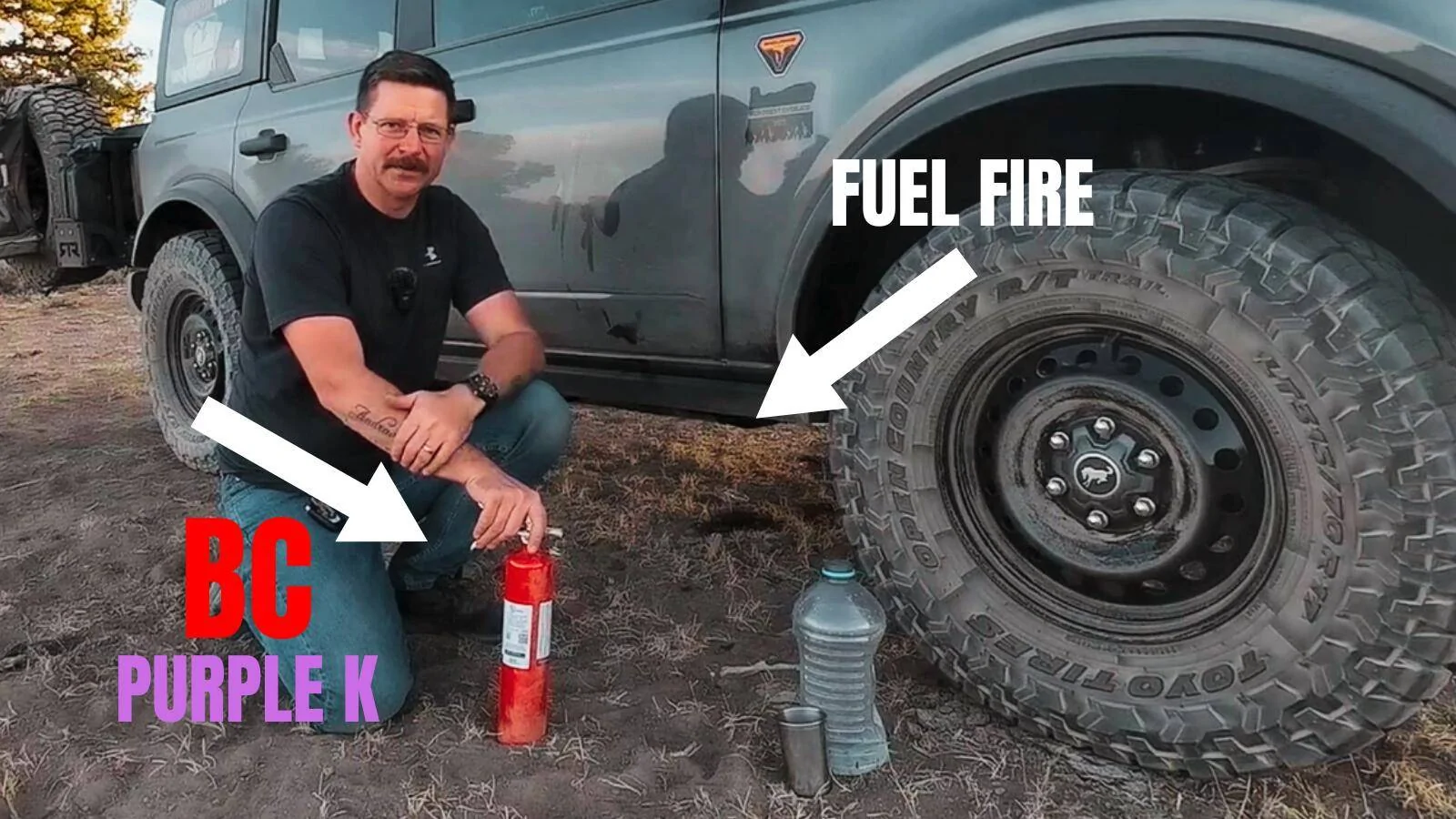

Myself, I carry two extinguishers. 2.5 pound BC Purple K and 2.5 pound ABC dry chemical. If you have the ability to carry bigger versions of those extinguishers...awesome. Don't worry about corrosion, you want the fire out. Insurance can replace parts.
🔥I had a Bronco fire last month🔥 in the desert. Sage brush build up on the skid plate, caught a spark somehow melting a hole in the fuel tank. The BC Purple K make fast work of it. Saved the Bronco and a possible brush fire. I'll have that video out in a week or so.
These links will get you set up
Hope this helps!
