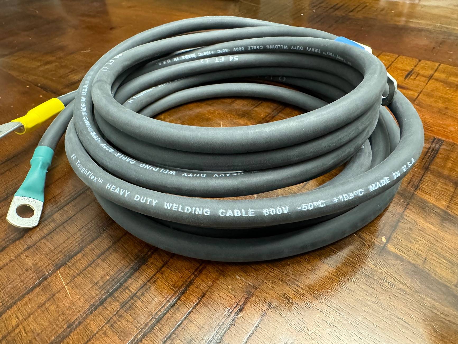

So I was looking closer at my wiring and trying to finalize all the details. When I ordered my BAMF bumper I also opted for the BAMF solenoid relocation kit which came with wiring leads.
I will be installing a Warn Evo 12s. The new BAMF leads will go from the winch motor and snake up under the hood to the relocation kit. From there I will use the supplied Warn power lead to go from solenoid to the 500a Stinger relay. And then from the Stinger to the battery (if I don’t go ahead and include the expensive Class T fuse). I will also use the supplied Warn ground cable to run from the winch to the negative battery terminal.
My questions….
1. The Warn power and ground leads are not marked. They measure roughly 3/8” wide including insulation. Quick research says these are 2AWG leads. Can someone please confirm?
2. The BAMF extended length leads are #4 ToughFlex. Are these sufficient? I’m not an electrician but would think you would want 2 AWG throughout the entire run.
https://www.kalaswire.com/wp-content/uploads/KALAS-IP-DP-Toughflex.pdf
3. Honestly all this wiring seems lighter than I think it should be. I’m not as cool as @SierraBronco with 000000 wiring but thought maybe a 1/0 or 2/0 would have been more in line. Obviously Warn is the wiser Yoda here and doubtful they would furnish wire sizes that cause issues but still seems off to me. What say all you?

4G seems kinda small to me for powering a winch. It’s one of those things that could be argued ad nauseam for winches. One might suggest that most of the time you aren’t going to be pulling at the max draw for extended periods of time. And then someone else will come in and say “well back in October 27, 1985 we had to pull a VW Bus out of a photo developing booth at the Lone Pine Mall and we ran that winch nonstop!”
I’d run something thicker, personally. But you’re armed with knowledge now so in the event you need to winch for a long time, if you can reach the wiring you could get an idea of how warm they are. Stopping and assessing is easy to say now. How different will it be in a stressful situation where you’re rescuing yourself or someone else? 🤔
