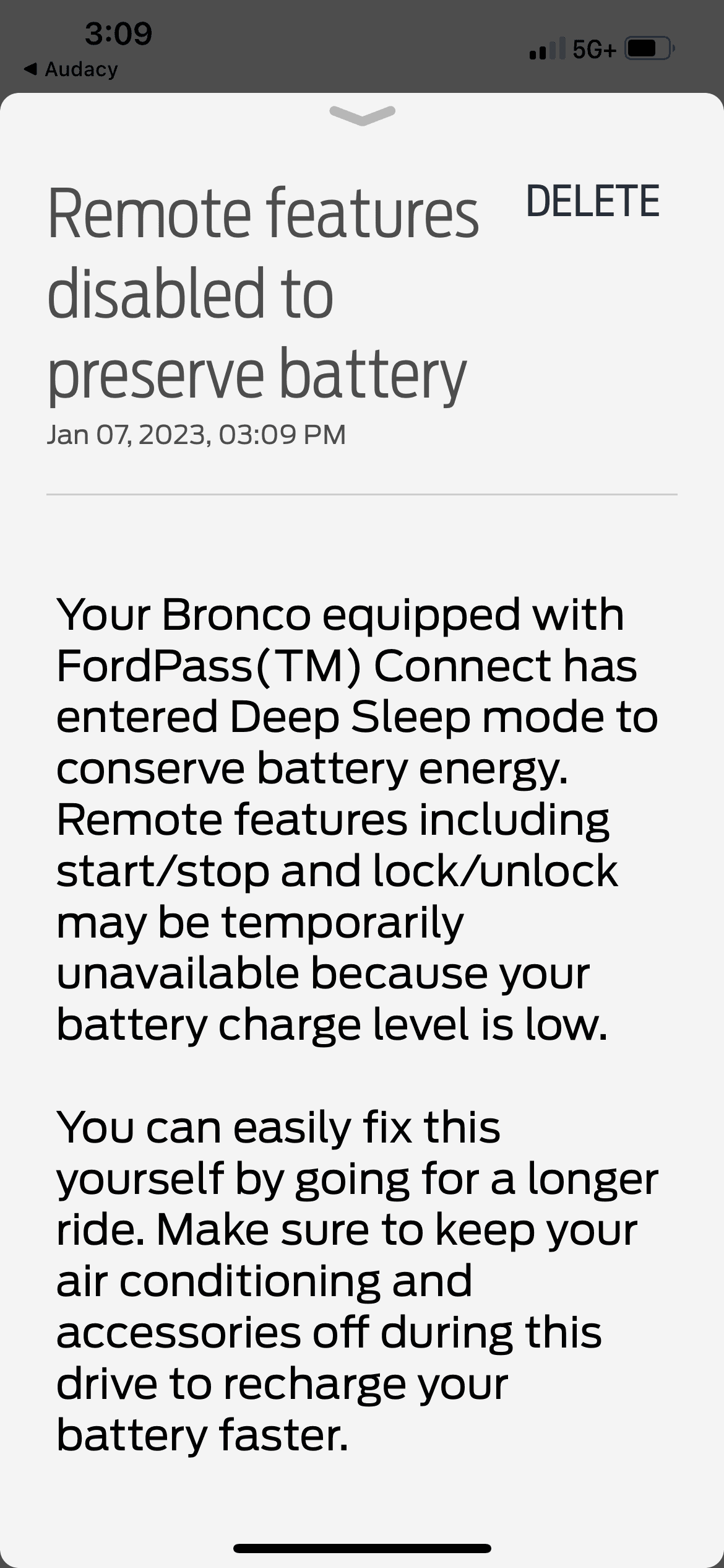

POST: With regard to the AGM on my wife’s Lincoln 2019 Nautilus (Same battery as in the Bronco}. She was getting was getting battery management shutdown warnings when she tried to start her car via iPhone.
I charged the battery with an AGM capable charger, but at 80% the charge was extremely slow. After two charging tries, the vehicle would still not start via iPhone, though the key fob started it without issue. I assumed the battery had a “bad”cell. I replaced the battery and now no issues. She’s happy….yeaaa!

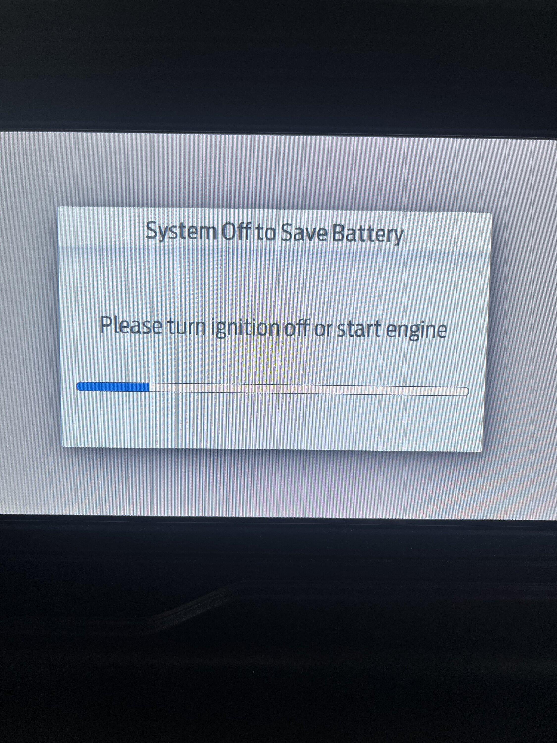

I get the same message when I open a door & it wakes up, even though mine stays on the battery tender.
Mine did that once. And ive always been cognizant of clamping the neg lead on the far side of the battery monitor.(there's a video on here about it)
https://www.bronco6g.com/forum/thre...operly-charge-how-to-power-accessories.59199/
Never did it again though. So im not sure why it did that when i know the battery was full up.

My bronco doesn’t do this but my F450 has done it since day 1 with 7 miles on it. Ford checked batteries and nothing.
Fords have a bad habit of this battery nonsense. '13 F150 Limited has given system off to save battery error since new.
My Bronco at 10k miles stopped letting me use zone lighting unless the engine is running. Turn it on and it switches right back off and says feature unavailable to save battery.
So now I can't use zone lighting while setting up camp, so that's fun 🤬
