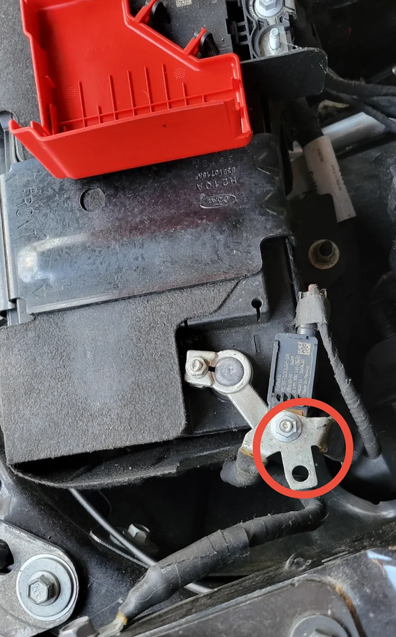

Where do you connect the negative charger lead?
Circled location below or any good chassis ground. Basically anywhere expect the negative battery post or clamp.

I place mine where you’ve circled.
That is precisely where I hooked up the charger. I'll ask my neighbor to check the GFI.
