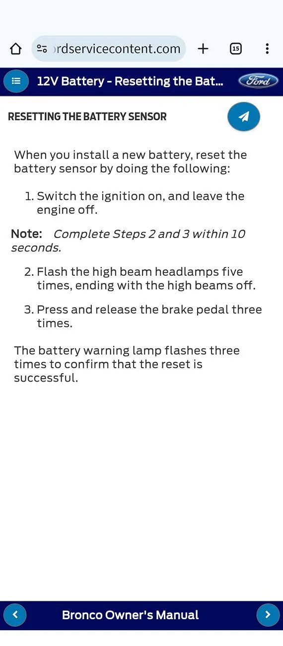

Success, thanks for the info brother. I have attached a screenshot of the straight forward steps.
This isn't going to fix anything. You're only supposed to do this when the battery has been replaced. Any old battery will now be incorrectly charged by the BMS because it thinks it's new.
This is basically just covering up a current issue lol
[/QUOTE
Thanks for weighing in. I had no issues before bringing in my 22 Bronco (30k miles) into the dealership for a windshield replacement. When I picked up my vehicle from the dealership, I started to receive the message. The service tech told me that they put the vehicle in power save mode and the message will go away after a certain number of restarts or miles. I got impatient for the system to update. If I recently developed a problem, it will come back in no time. From there back to the dealership to chase gremlins.
