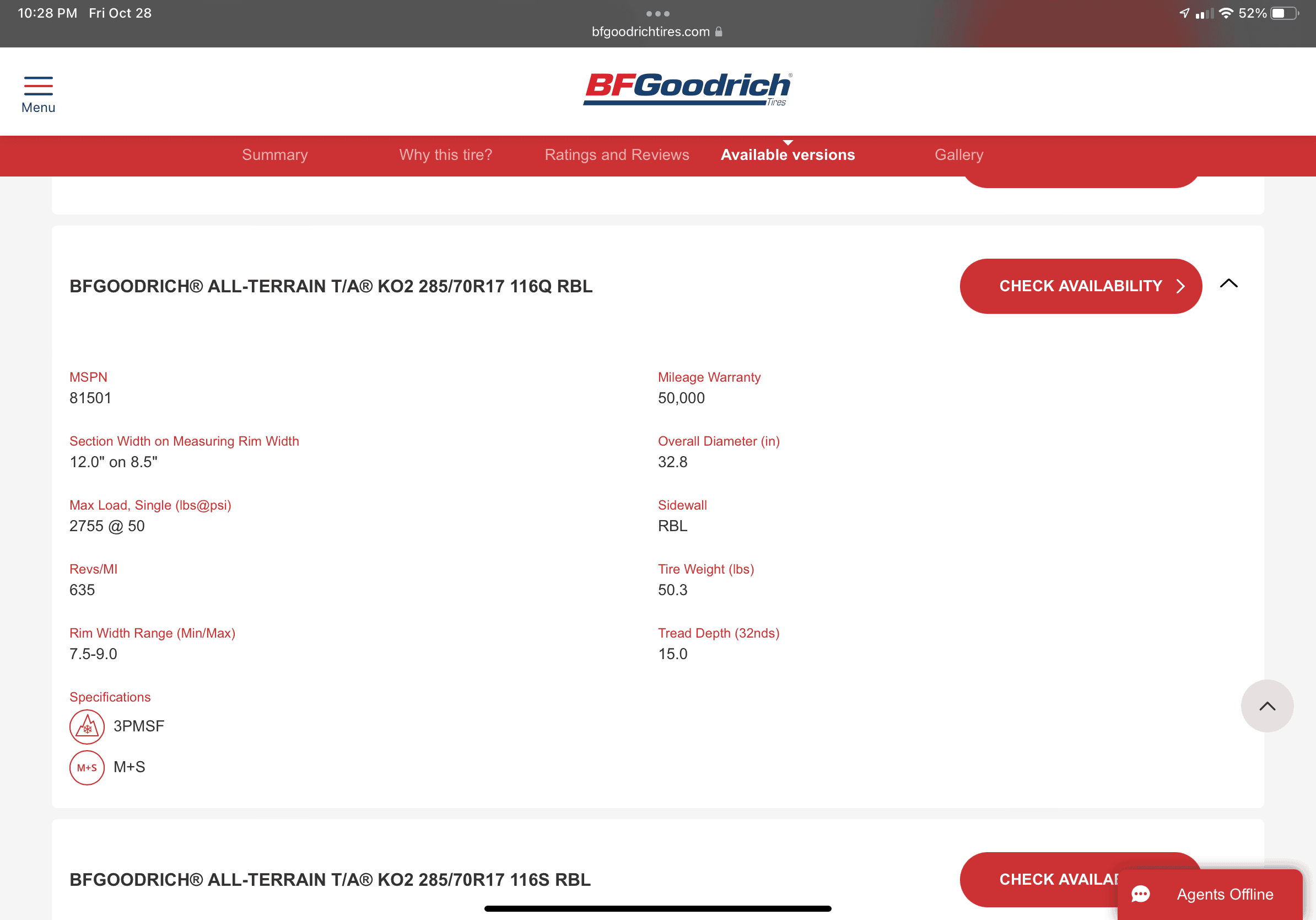

The tire weight for the Badlands BFG tires in 285/70R17 is incorrect, according to BFG’s chart they weigh 50.3 pounds for raised black letter. The Badlands non beadlock wheels are 28 pounds each, not sure about the beadlocks.
Ford Bronco Factory wheel & tire weights - All Models 2C4BBC2B-7065-4D96-BCB5-083BDF6FF988

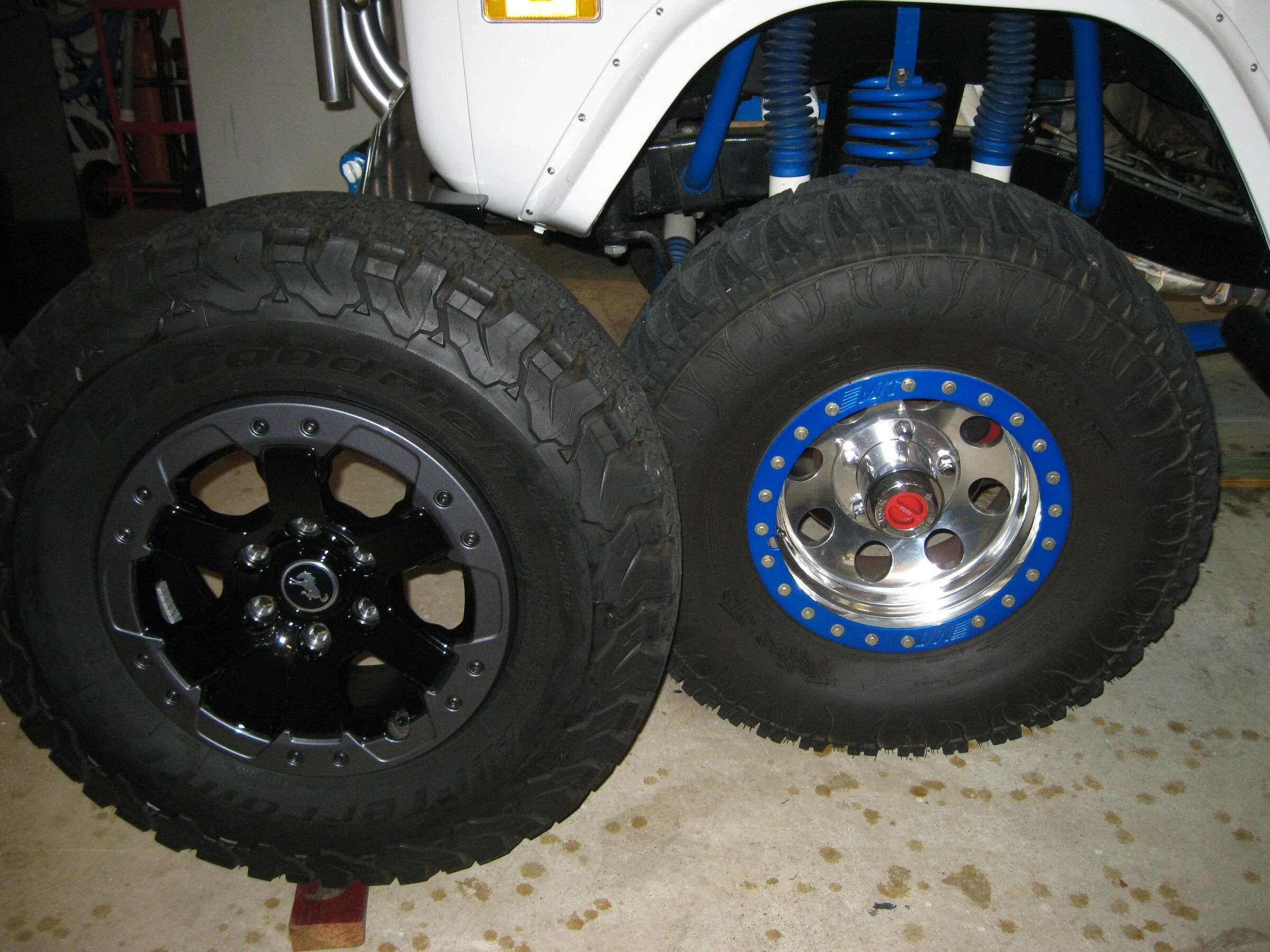

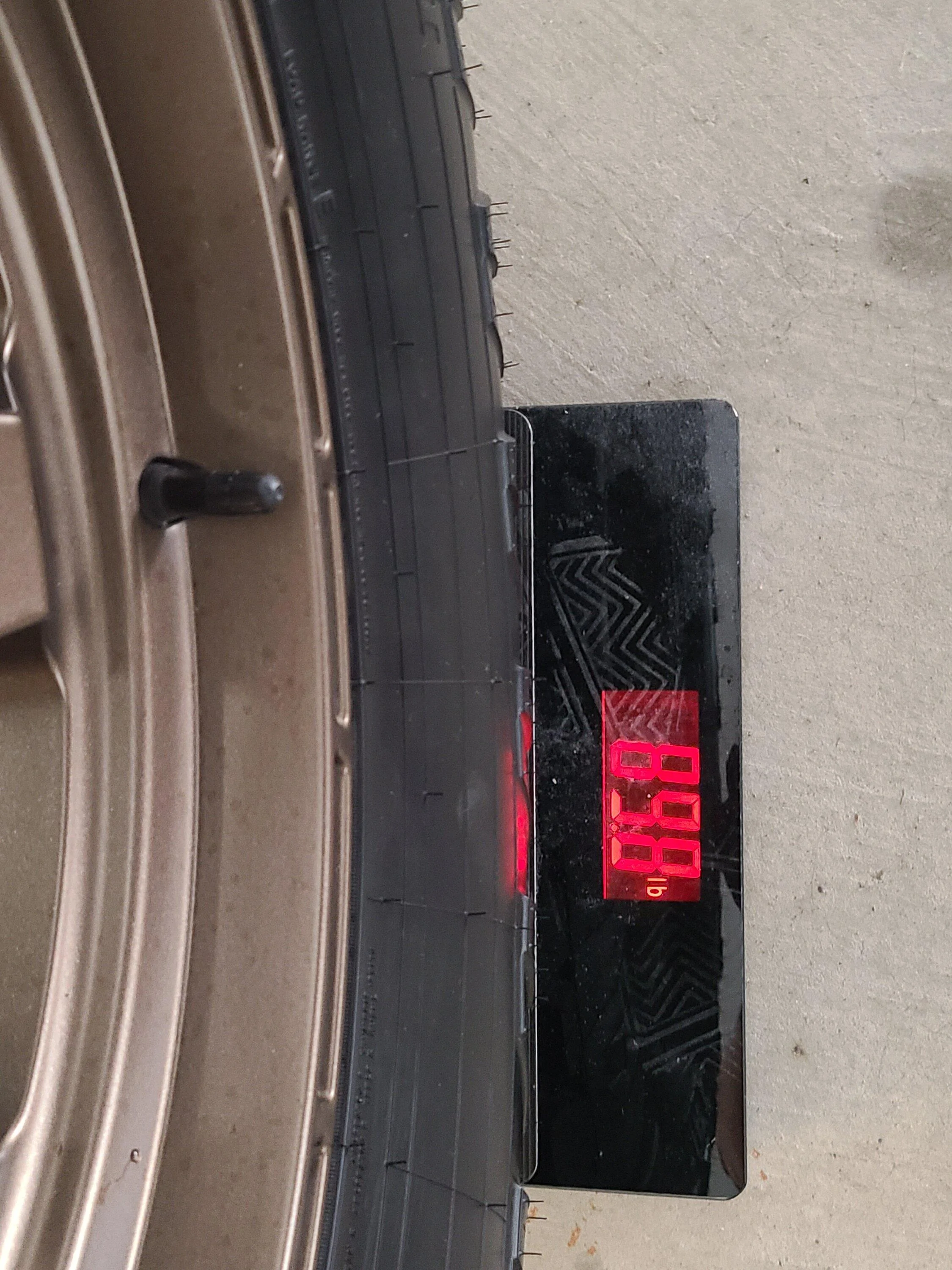

I weighed the optional Badlands wheel (beadlock capable) with the BFG KO2 285/70-17.
It was pretty porky at 86.2 lbs. (shown with 33x12.5-15)

Documenting my observation here: Black Diamond original wheel with General grabber atx (265/70 R17) weigh 74lbs.

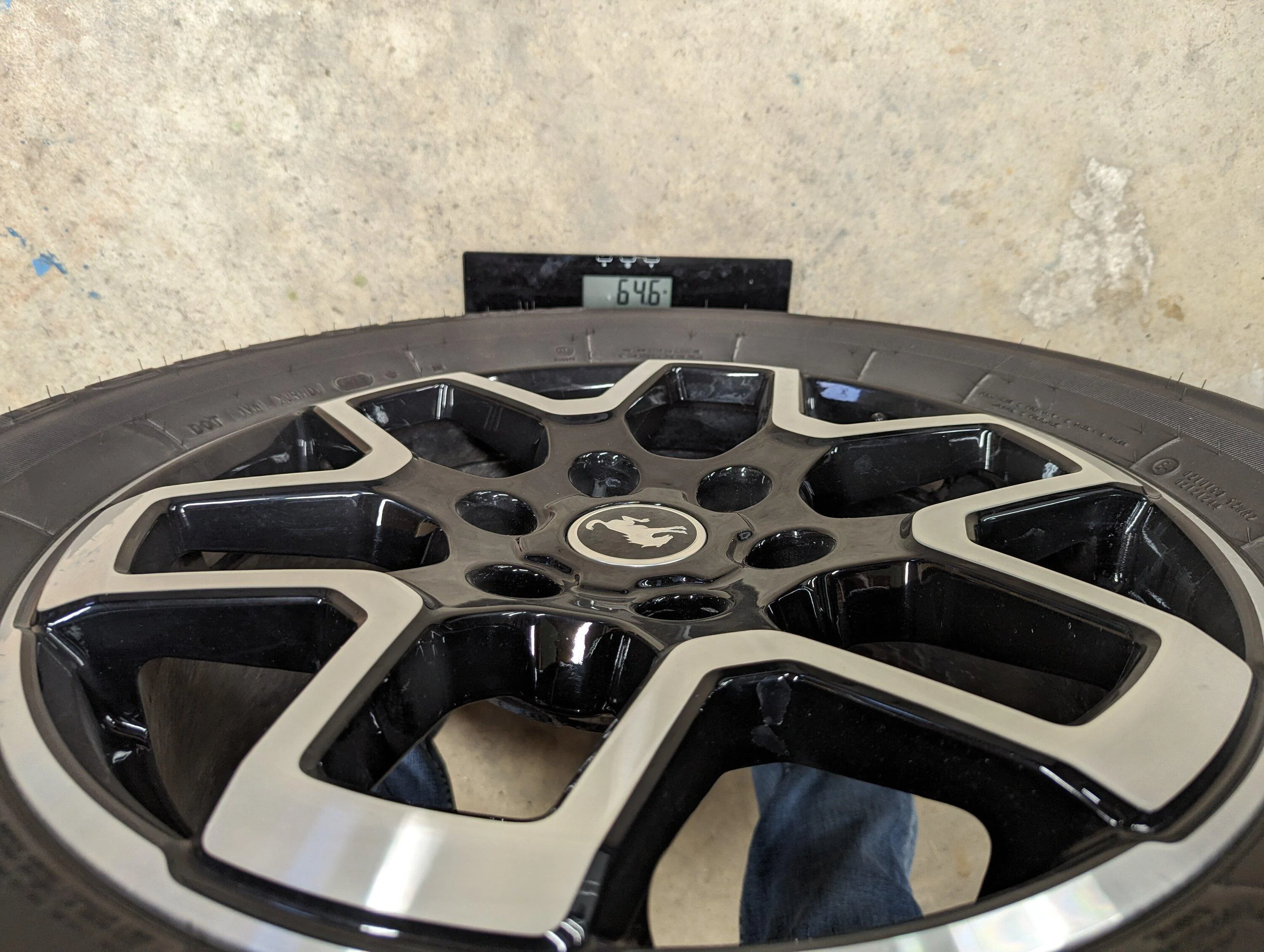

Like had been stated here, I found the optional badlands wheel with the 33" bfg to be 85.8 pounds. The regular badlands wheel and tire, about 79. The fuel shok 17x9 with an e rated toyo open country CT 86 pounds. And my latest Fuel Shok with the 35x12.5x17 Toyo ATIII was this. Which surprised me considering it's also 10ply. That I believe is lighter than the sasquatch wheel and tire set up with a tire that's about an inch taller and more robust.
