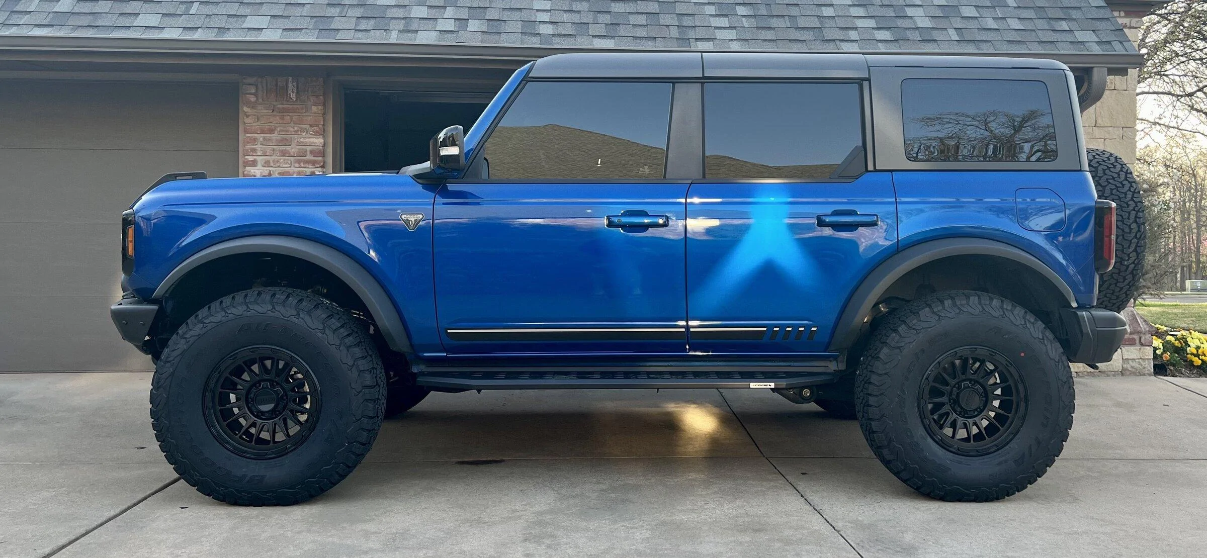

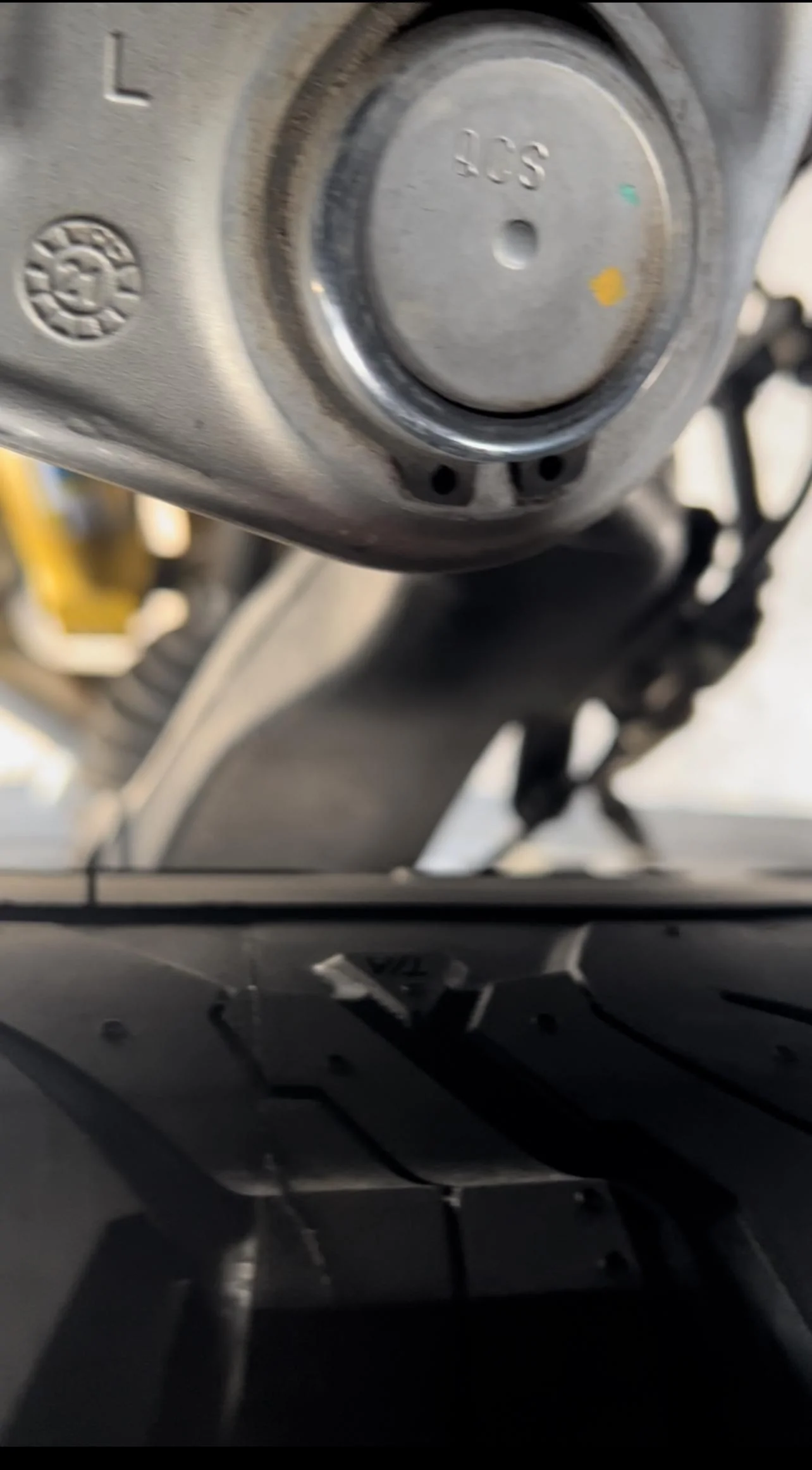

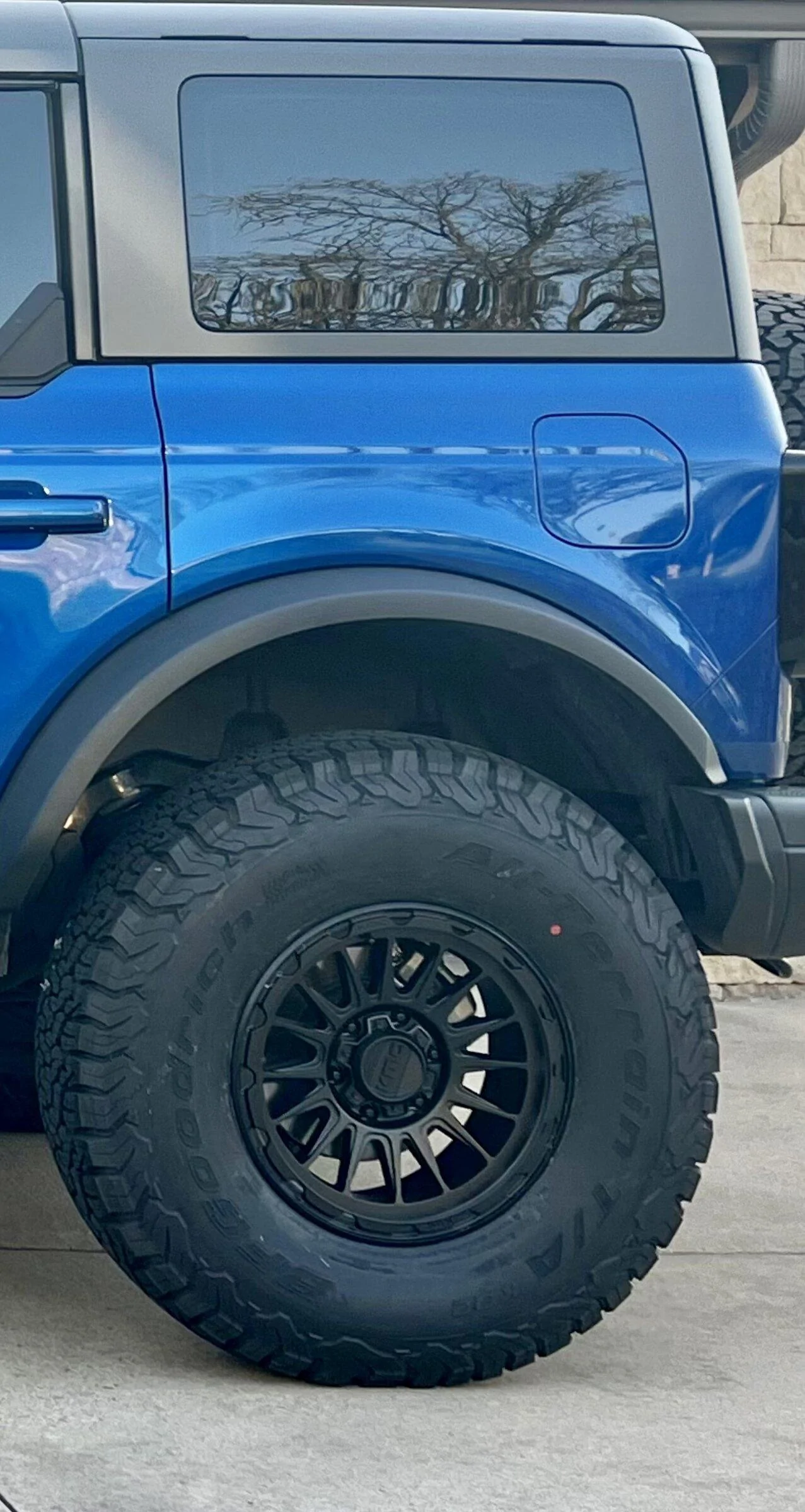

I sold my Sasquatch wheels and installed 37 BFG KO2 Load C with KMC Impact Wheels and the RPG spring perch (Front ride height increased by 2.25″ and 1.25″ in the rear). Handling feels improved and the Bronco has no problem pushing the larger tires. No trimming is required and the tires have room to clear the UCA.
Sasquatch wheel = 35.5 lbs.
Stock Sasquatch tire (Territory) = 52 lbs.
TOTAL = 87.5 lbs.
KMC Impact Wheels, +18 offset (KM54279068718) = 28.42 lbs.
37 BFG KO2 37x12.50xR17 (Load C) = 64.84 lbs.
TOTAL = 93.26 lbs.

Those must be the lightest 37’s. Good choice.

Looks good 👍
No trimming, you say. Have you tested off road, stuffing and drooping with full turn in each direction?
I ask because some drivers do not experience rub issues with their personal driving style.
I don’t want to assume the particulars of your situation.

No trimming for mall crawling so far ;)
