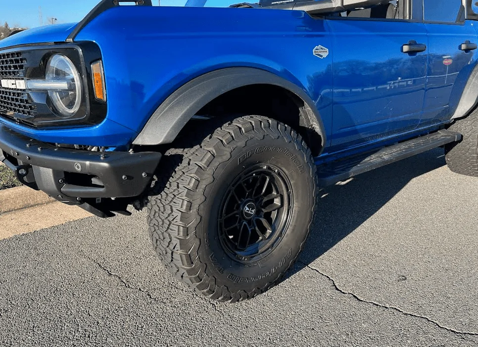

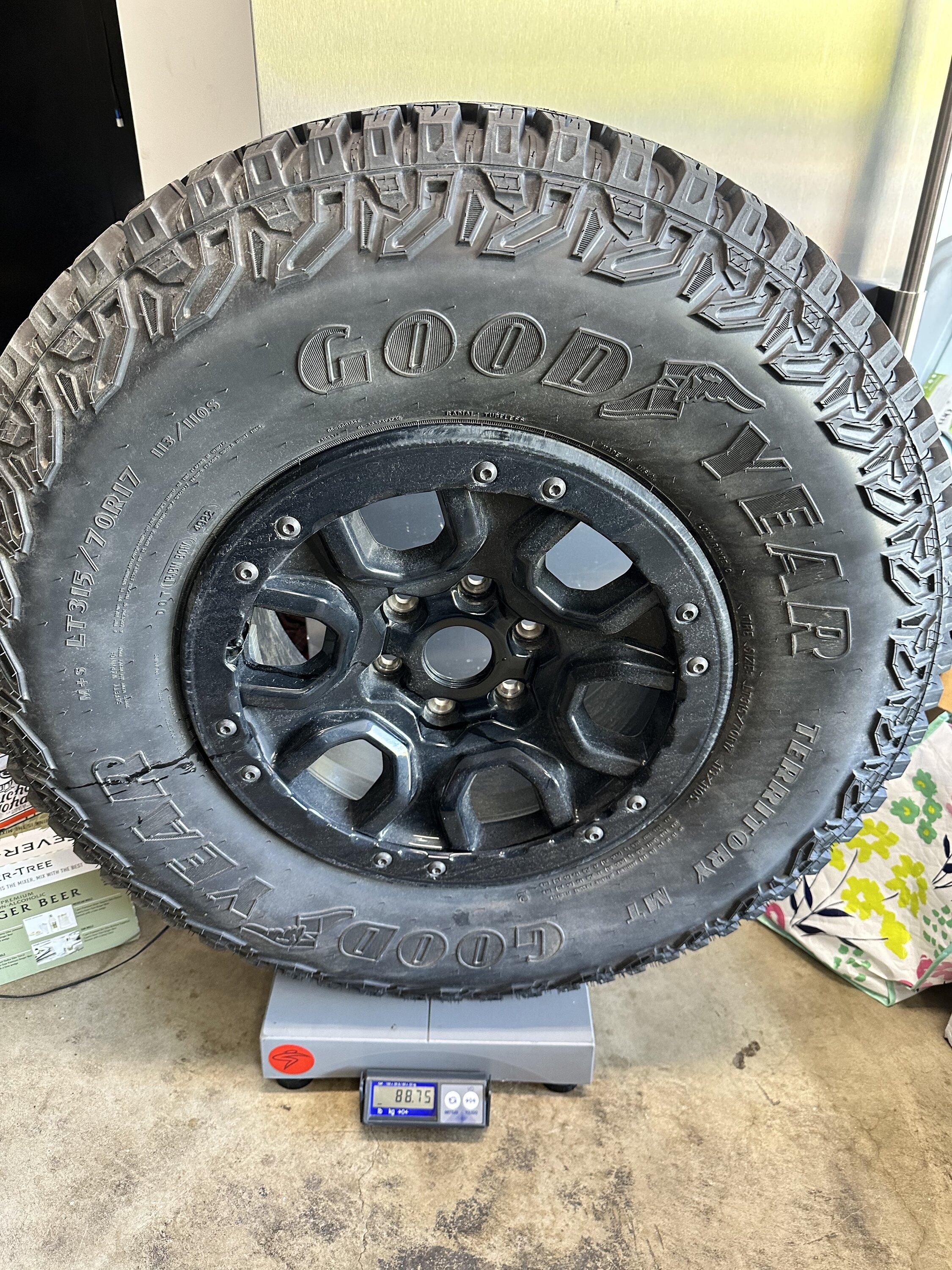

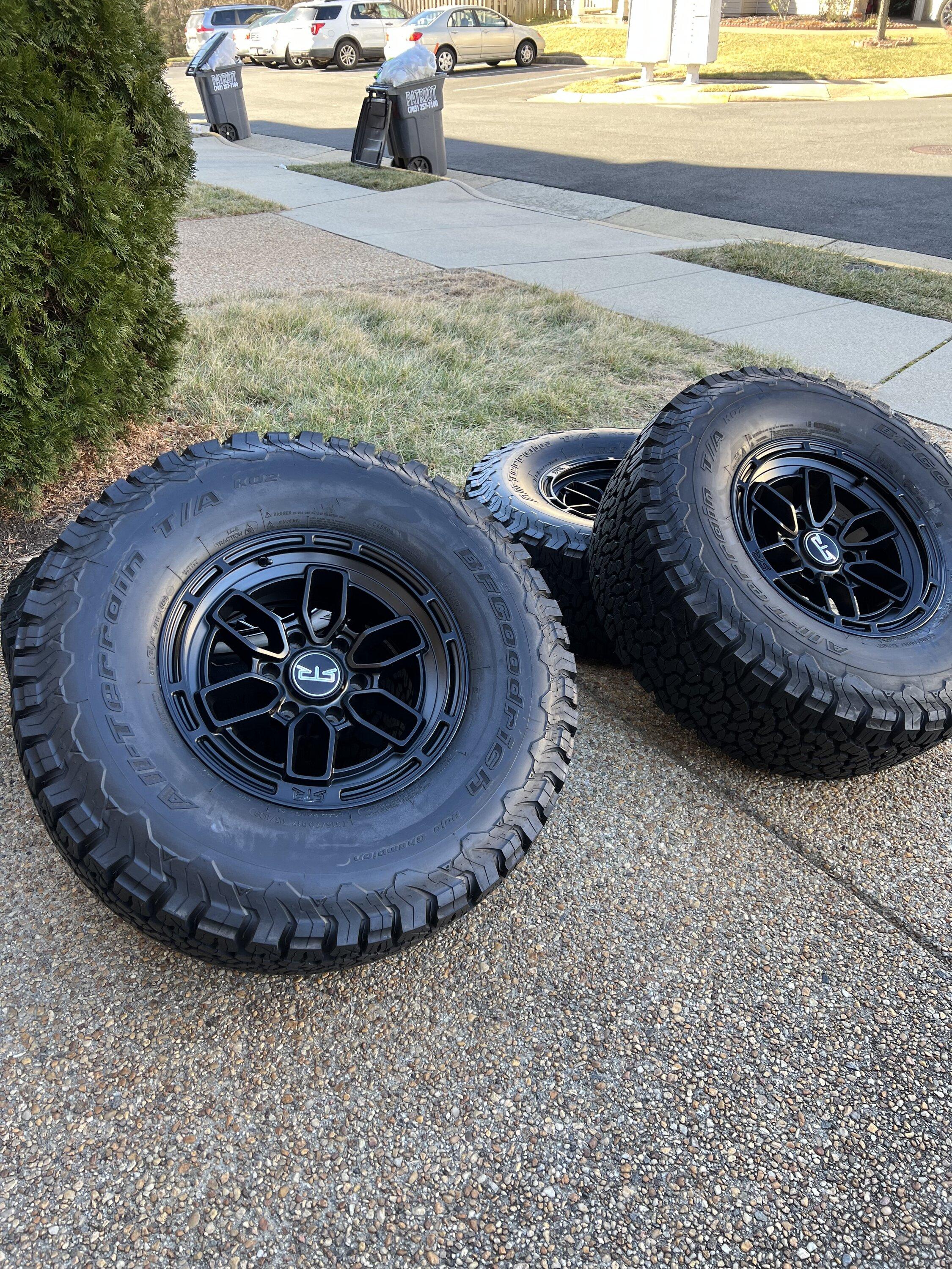

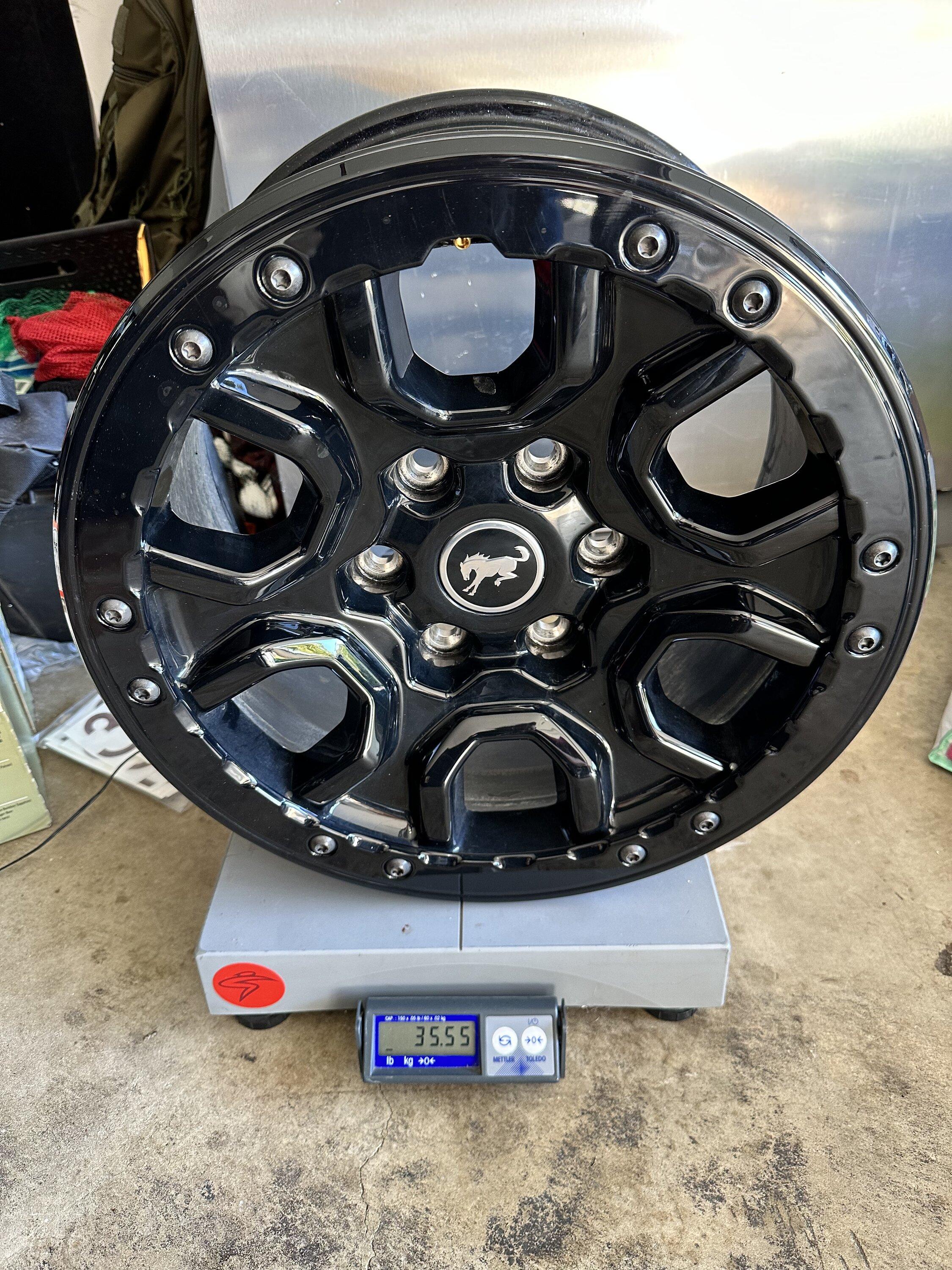

Swapped out my Wildtrak Sas wheel out last week.
Ford Bronco Sasquatch Wheel and Tire Weights 4BAD3A93-E793-4AE5-B87E-2CF5AB75EAB4
Ford Bronco Sasquatch Wheel and Tire Weights 0713ED31-A2B4-4DAB-99BE-A9D36D5D8CE4
Ford Bronco Sasquatch Wheel and Tire Weights A1A67EB9-D4D7-41CC-A5B0-519CF67A9DF4

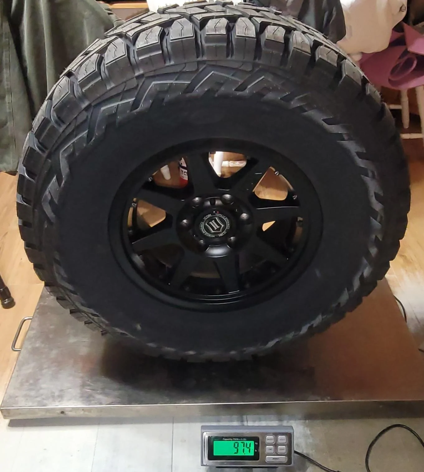

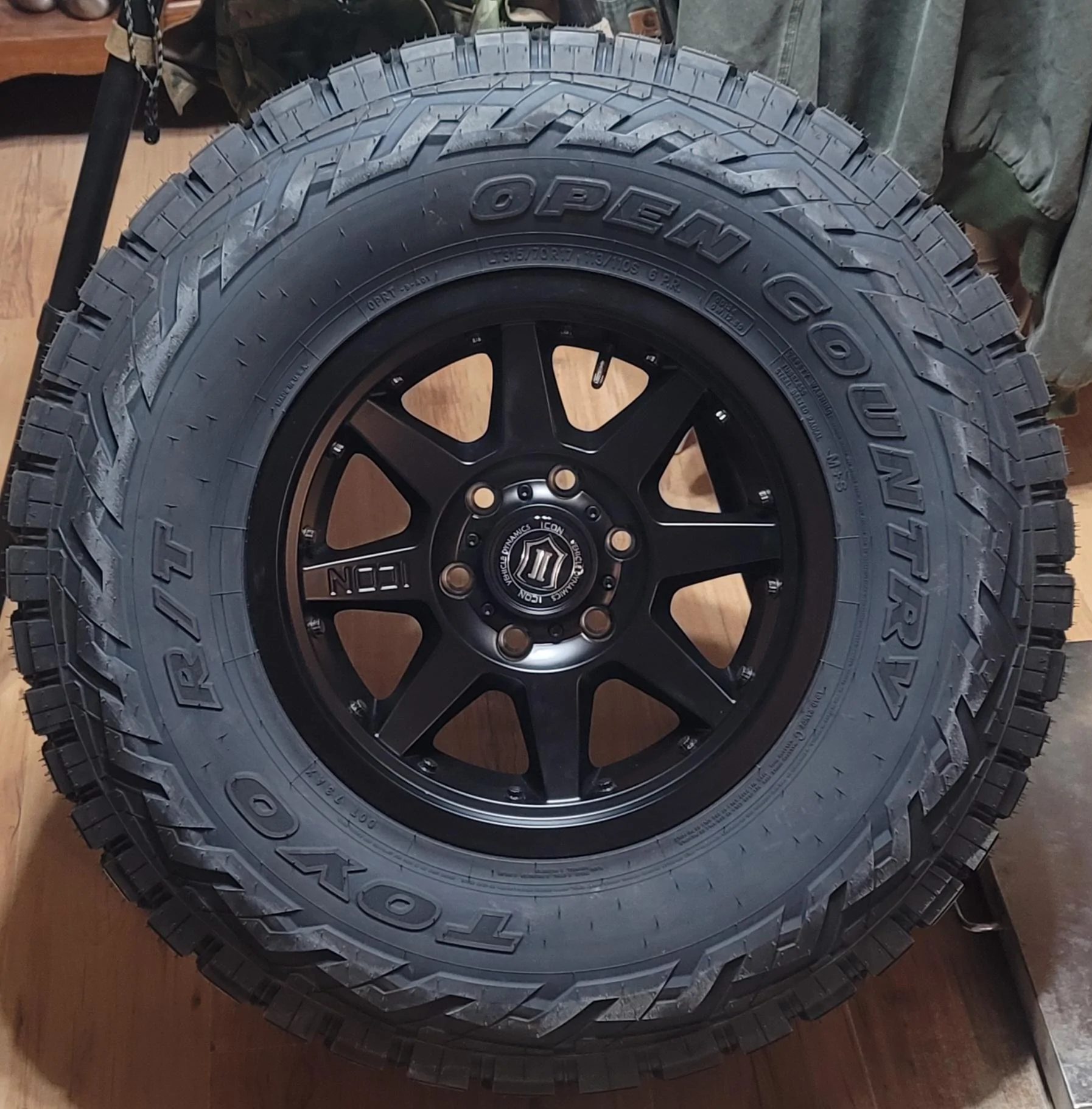

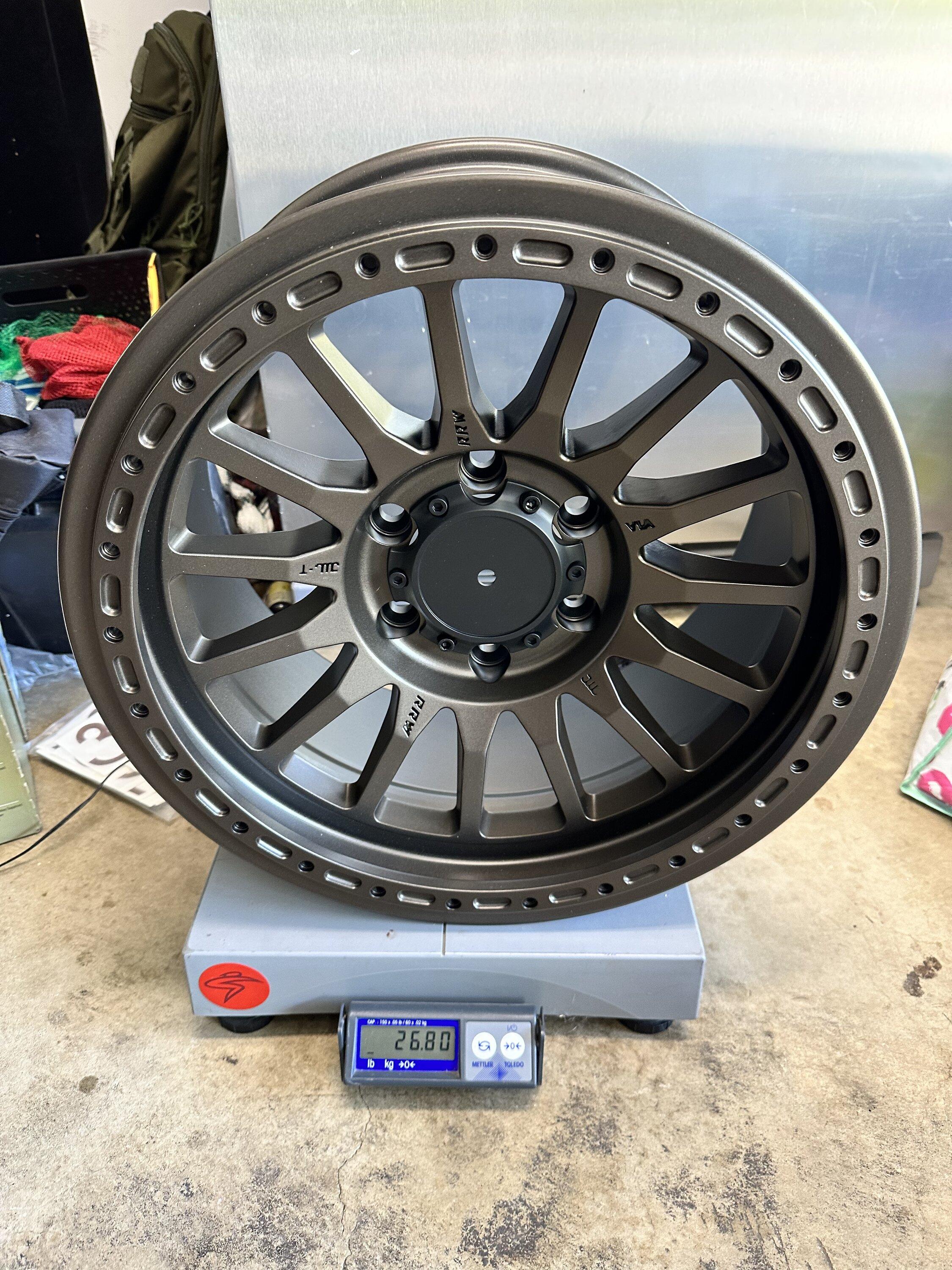

ICON Rebound Pro 17x8.5 +25 with Toyo RT 315x70rx17

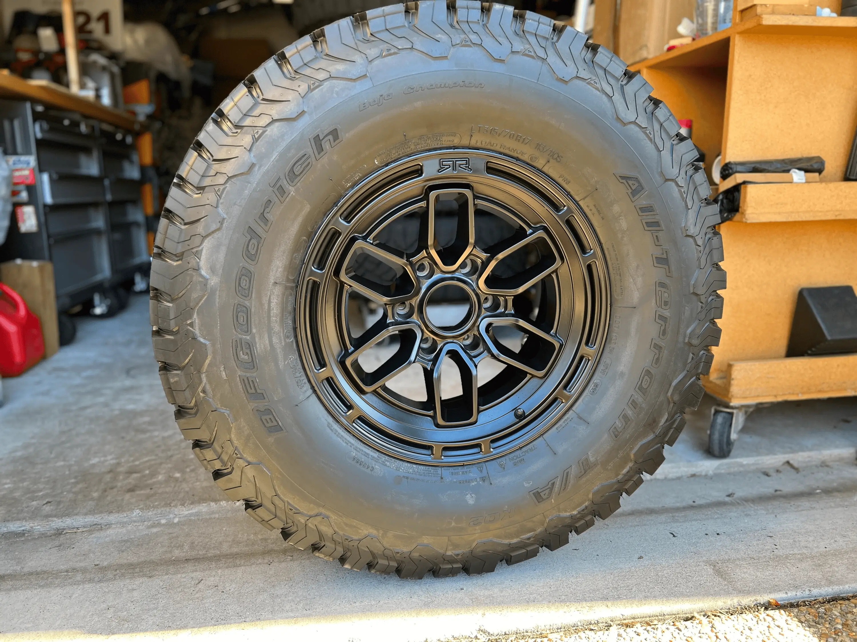

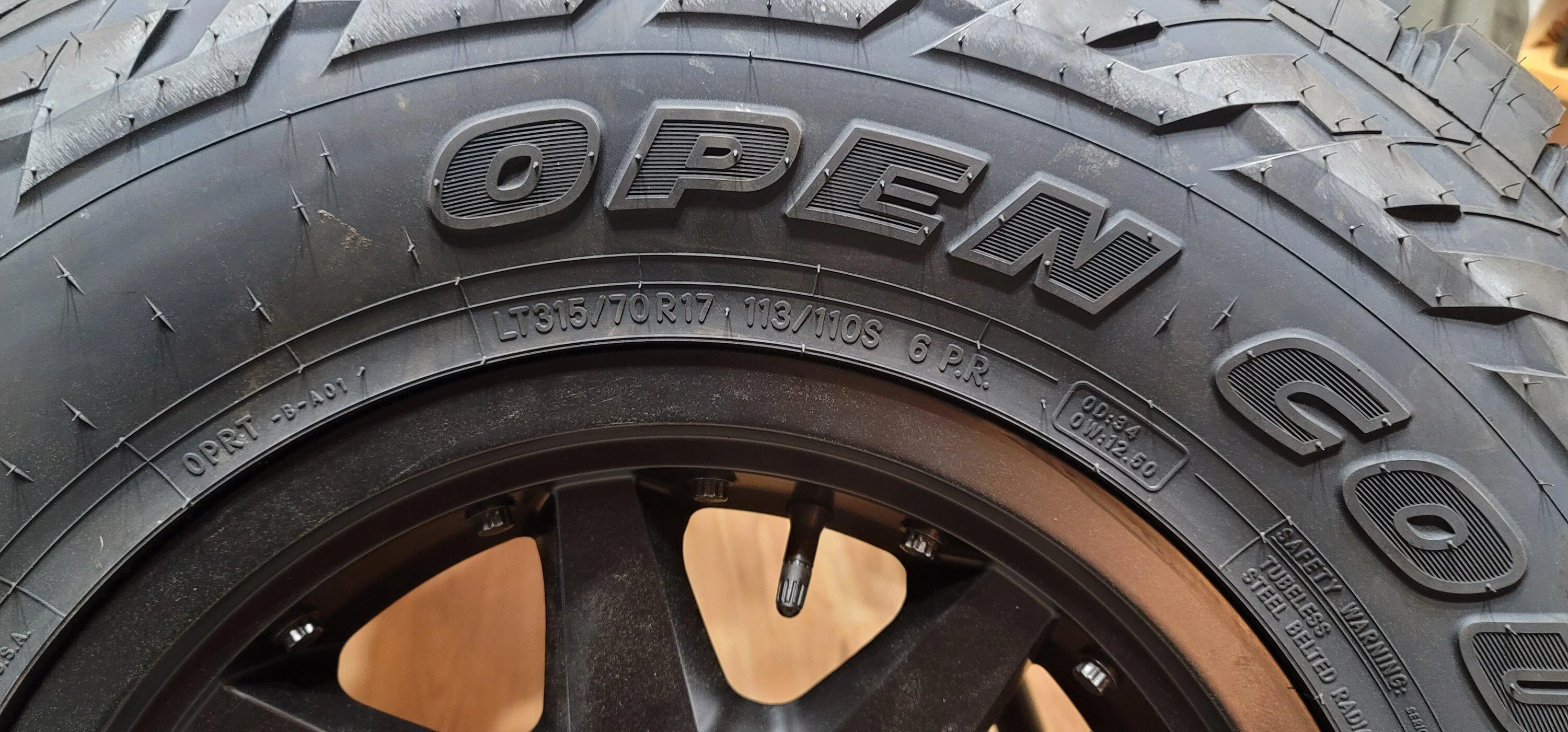

If you off-road, you want a slight poke in that the wheel will hit the obstacle 1st before your body hits it. You can run the RTR at +30 if you wish. BTW, I am running the RTR in 0 offset and that wheel weighs 24 pounds.
