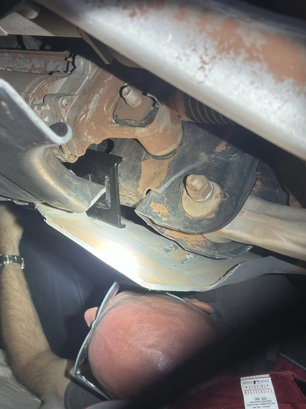

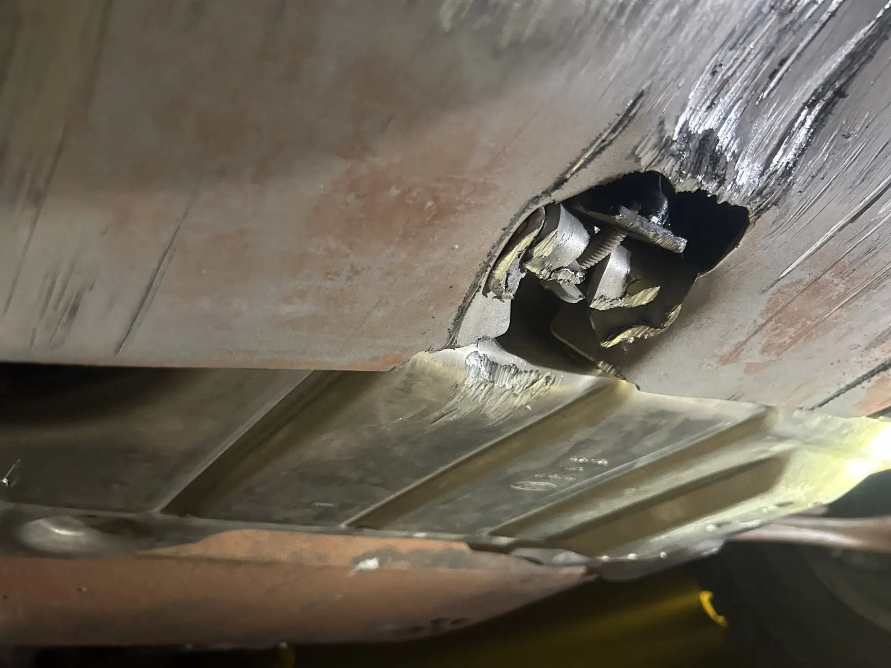

Well, I'm a jackass.
just an FYI, if you're looking at the Ford Performance Raptor Skidplate kit, it's a hard pass, this g-out wouldn't have taken the rack out if it wasn't for the bracket they included to act like a cantilever pushing itself into the rack. the skid plate didn't break, the bracket just took the edge of it and bent it inwards. it's a ton of leverage for a bolt that long.

What did you do!? Wow that's a hard hit...
