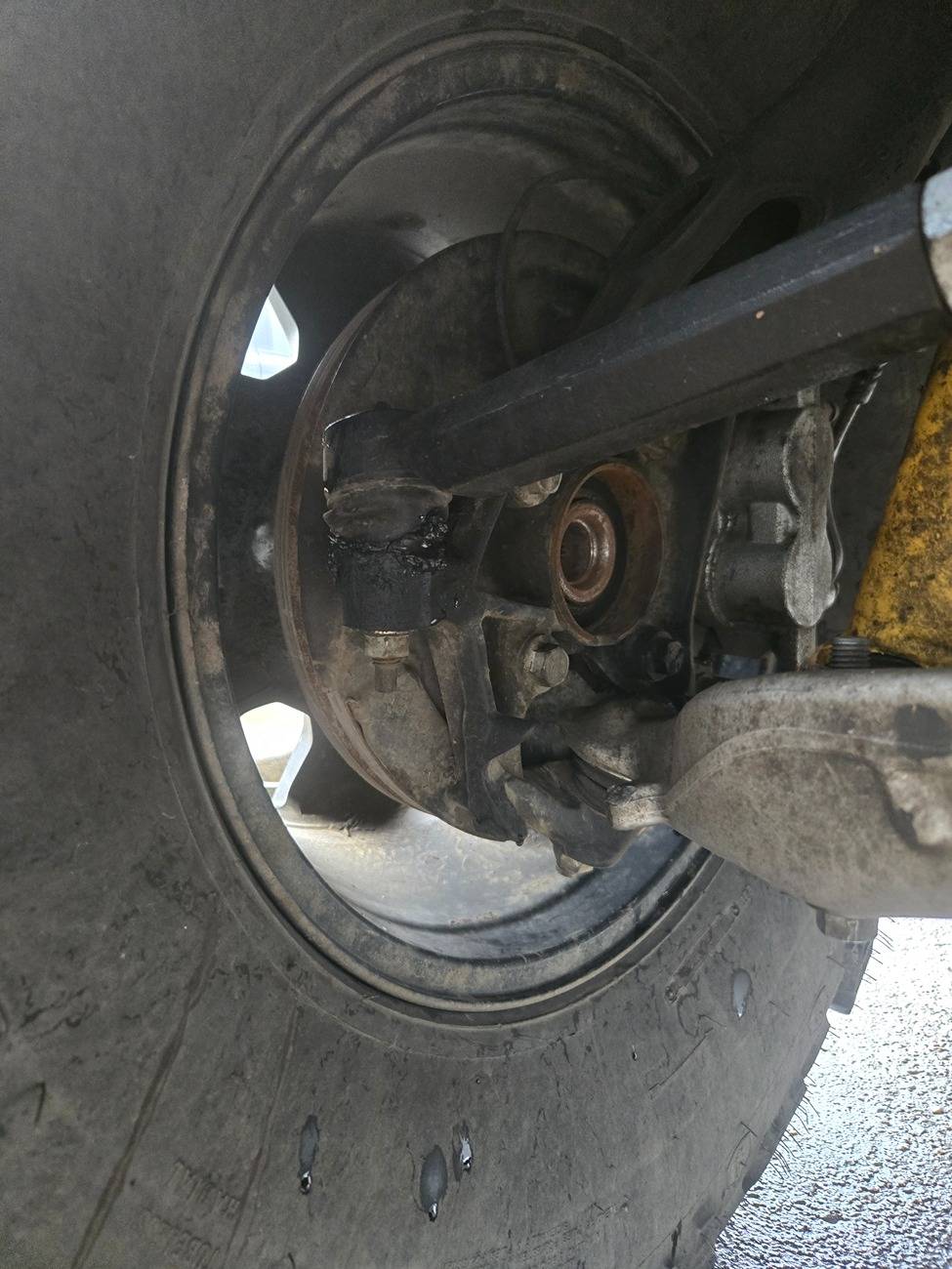

So much misinformation here... I've literally put 5K miles down without any CV axles, or axle nut. on older GM designs, they would come apart if the NUT was not there to hold things together. If there was gonna be a problem, the stress from the 41" tires would have found an issue...most Fords unit bearings are designed and built in a way that they are safe to drive without the NUT in place.

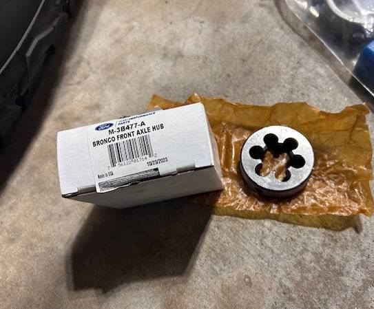

If you're careful you can fix the threads with a file, you may need to mess with them a bit to get a die to fit as shown above.
